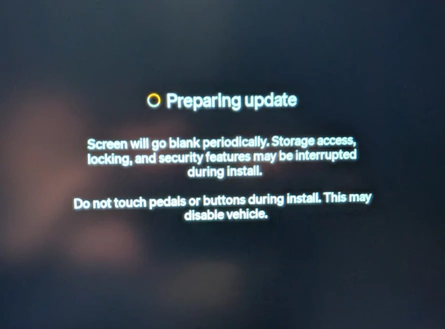

FYI when you change your tire size, and it says vehicle reset is necessary for accurate range, what it's really saying is "click okay to reset your vehicle right now."
Good thing my boss has a Rivian and will understand why I'm late.
Rivian R1T R1S New update mileage for 20" 1000003127

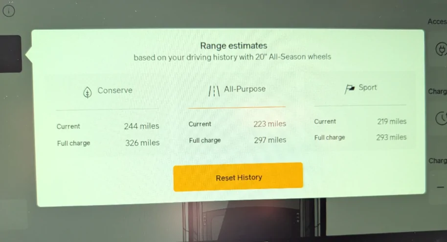

Many of us switch from 21" to 20" size of 275/60/20 all seasons tires and have achieved same or better efficiency as 21". With the new update came out , the prediction of 100% charged went down from 305 all purpose to 285 miles. I know for sure this is not true with my general grabber hts60 since my efficiency was about 5% better with 18k miles on it than my 21" OEM.
Is it just a general prediction Rivian based on with their good year tires ?
Did you choose the Rivian "all season" 275/60R20 option? I chose that size but aftermarket all terrain and it shows this:
Rivian R1T R1S New update mileage for 20" 1000003129

Maybe degradation, how many miles do you have? What’s your lifetime average MPK? Multiply it by 131 and that should be your range…
My lifetime before the goodyear is 2.31 which put it at 303. 95% all-purpose. 35k miles
LL75
lance
Sep 21, 2022
1,756
1,282
Dallas
I choose 275/60/20 all seasons which is the good year that I currently have .
LL75
lance
Sep 21, 2022
1,756
1,282
Dallas
When you changed it, did it reset the vehicle?
I did this 3 days ago and it reset the vehicle. Took like 5 minutes to reboot. Someone on facebook group changed his 265/65/20 OEM Pirelli to 275/60/20 in the system and it changed to 298 miles all purpose !! So, there is something is odd about my car.
