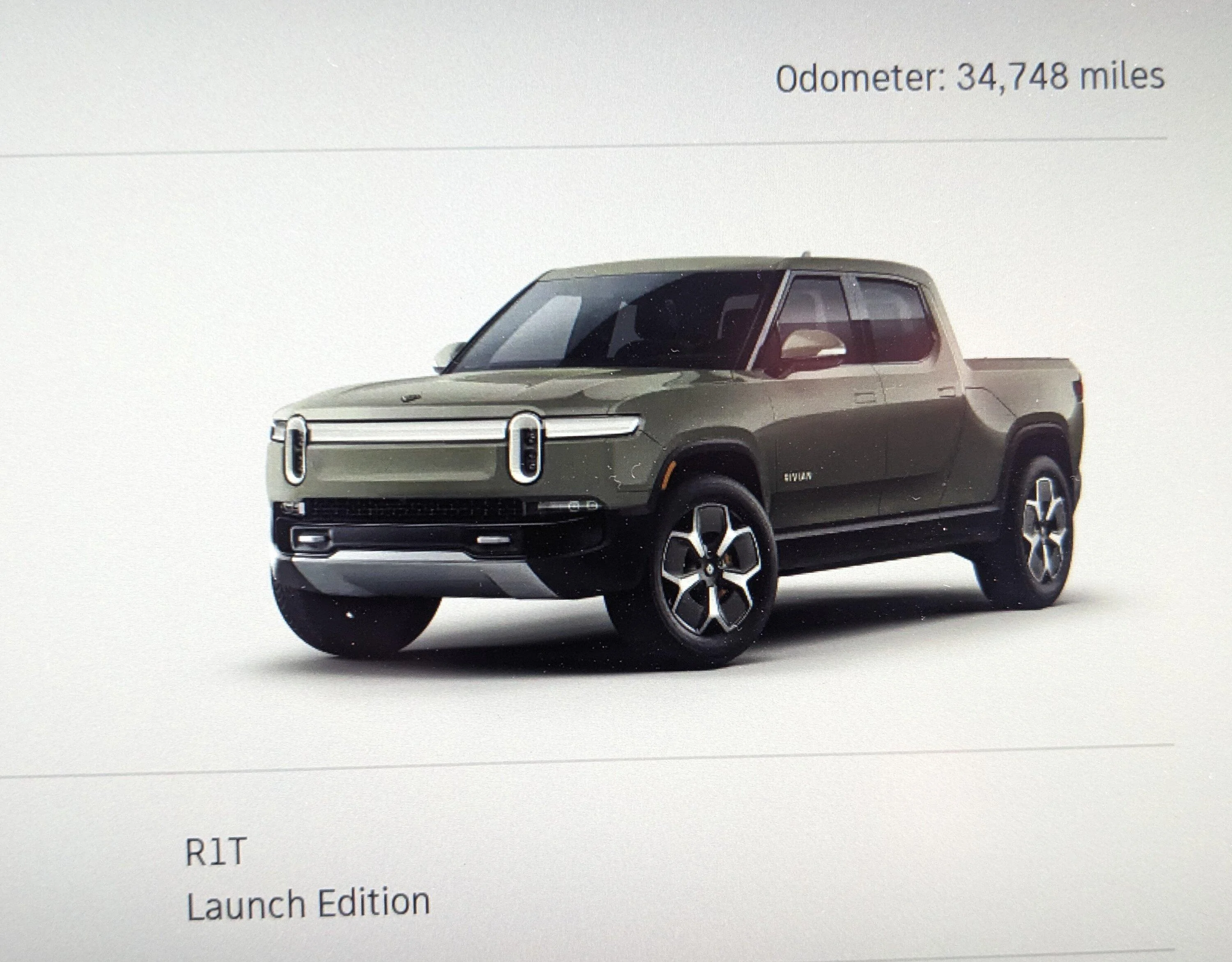

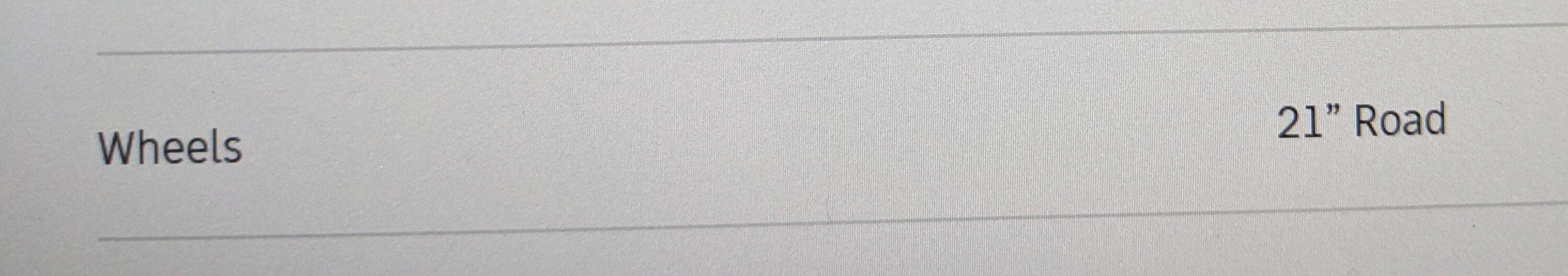

Does the UI show the 21" wheels after the update?
I finally got my truck back, and they updated me to 21" despite my 275/60R20 wheels and tires! It shows 21" in the UI, speedo, trip meter, etc are based on this. I'll let you know efficiencies with AS+3 on this UI in about a week as I test things.

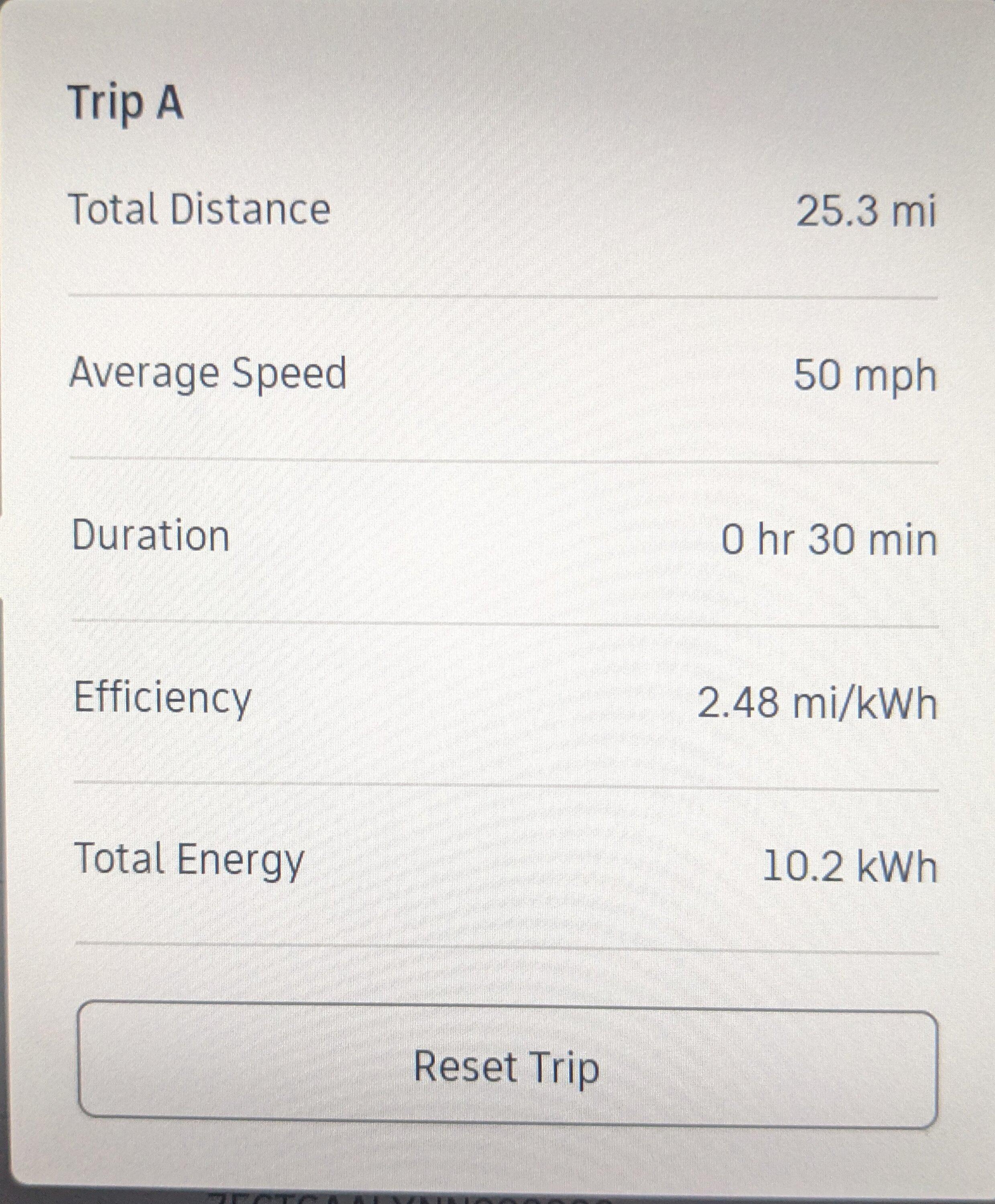

My regular commute trip meter is spot on now! It's the same energy and (corrected) efficiency from my aero/non-aero tests.
Interesting find: actual diameter correction was 2%, not 3% as the tiresize.com/comparison calculator showed comparing 275/65R20.
