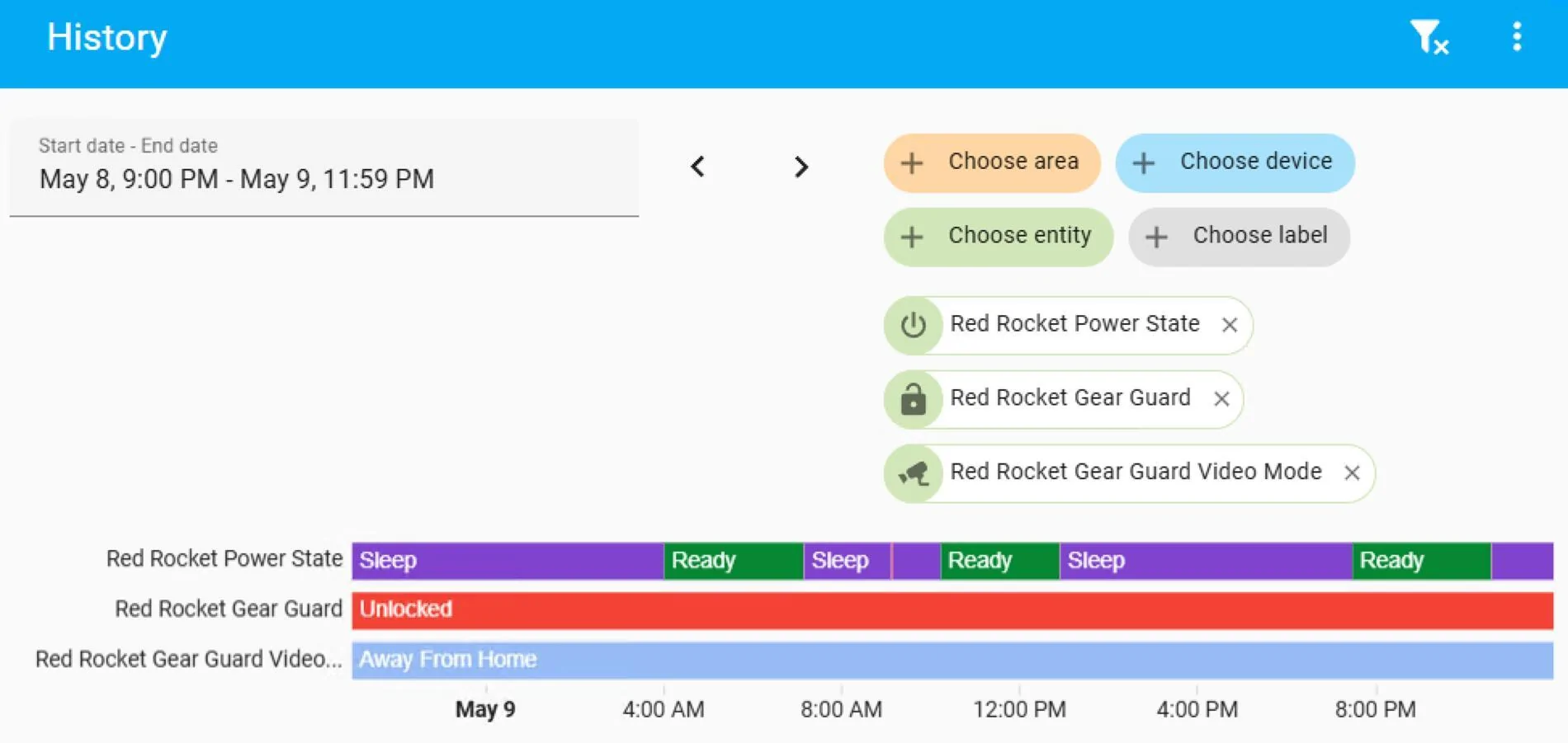

The vehicle will sleep without turning things off manually, and will sleep after just walking away for a time. That's well known. Below is a history chart of my R1S as logged by Rivian and retrieved from Rivian's telemetry database via the Rivian API. I do not have Gear Guard turned off, WIFI off, Rivian app killed, etc. You can clearly see it has multiple sleep cycles.

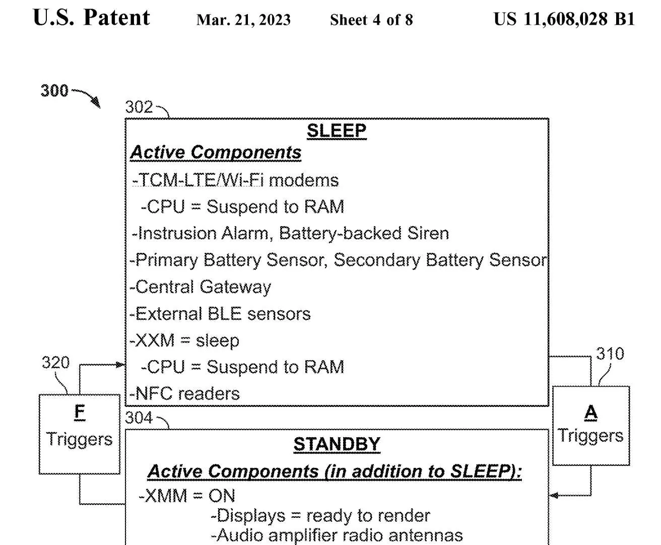

We have discussed this extensively here is the distant past as part of "Vampire Drain" discussions. RIvian's patent shows that the vehicle will sleep and various susbsystems remain on. Below that is an illustration from the Rivian patent which describes among other things which modules remain active in sleep mode.

Sigh, that was the exact analogy I was making - comparing RIvian sleep to Human sleep. When the Rivian is sleeping not all subsystems completely shut down. Subsystems such as Bluetooth LE et al stay powered on in a low power mode while the Rivian sleeps, just as your heart and brain stay "powered on" in a different mode (REM, NREM1, NREM2, NREM3) while sleeping.
