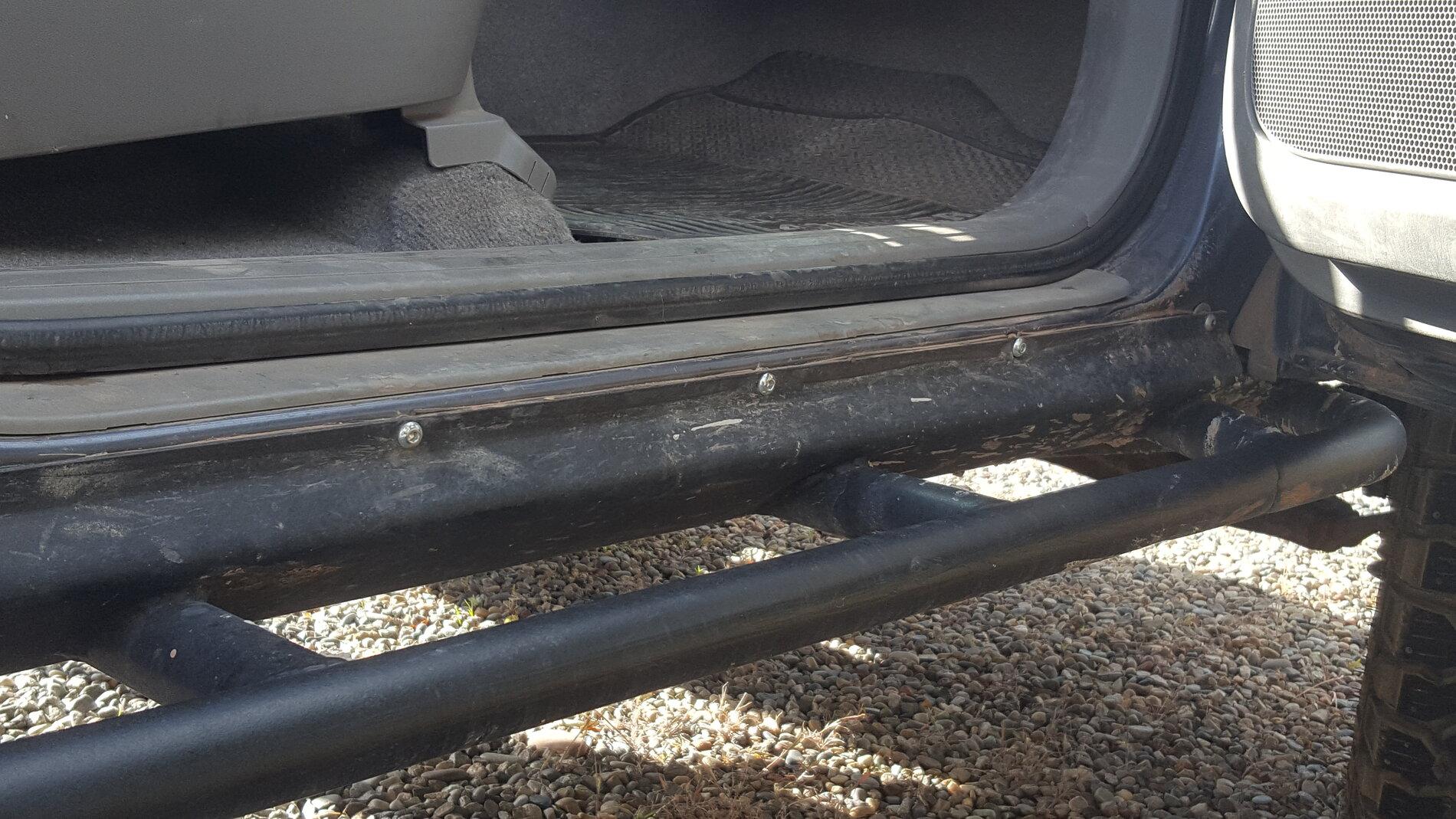

I'm curious if it will be possible to add body mounted rock sliders. That's what I built for my 4runner using the side step mounting holes and adding extra nut-certs into the body.

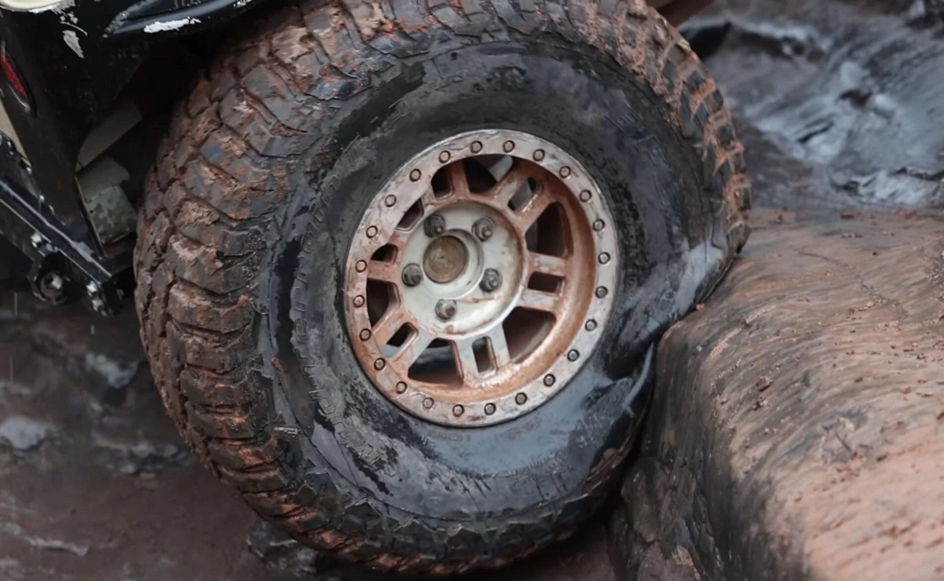

Not an offroader, but I believe it's to avoid sinking deeply into sandy terrain, similar to wearing snow shoes in deep snow (Also a reason to air down your tires).
I think it also makes it easier to rock crawl over larger rocks.
Here’s a good example of why tall sidewalls are good off-road. You can get much better traction on slippery surfaces with the tires aired down:
