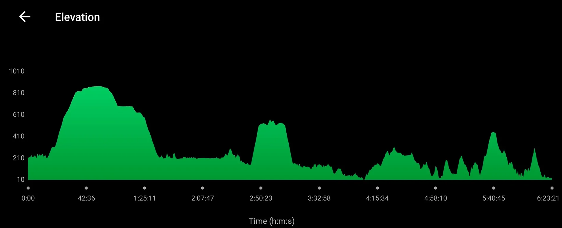

On braking, I was super stubborn about not enabling regenerative braking assist. I preferred knowing when my regen was limited and stayed within its braking force, by limiting my speed accordingly on descents. But on a 7 hour FSR exploration/rally mode rip, I wanted simplicity, so I enabled it. If you're looking for consistency over long descents, braking assist is the way to go. As regen starts to become limited, the brakes will start to supplement the braking force for a more predictable drive.
Some photos of the day.

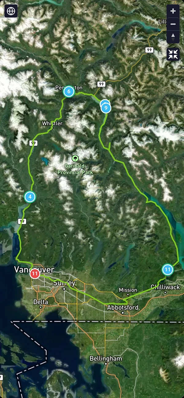

The elevations in the graph are in meters. The section of FSR was between markers 9 and 11. Roughly 200kms of FSR's with several branches forking up into some of the surrounding mountains. The entire loop, Vancouver through Whistler, Pemberton, then along two lakes was about 480kms. Average efficiency was 3.2km/kWh (2mi/kWh) 4200m elevation gain, 4400m descent.
I must not have had enough tea this morning, because thanks to the kilometers you mention in the sentence before this, I thought it said that you gained and dropped 4,200 & 4,400 km. I was wondering if you had somehow gotten your truck to Mars and were going down Olympus Mons....
Funny you say that...
