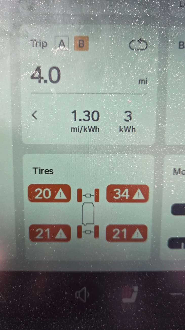

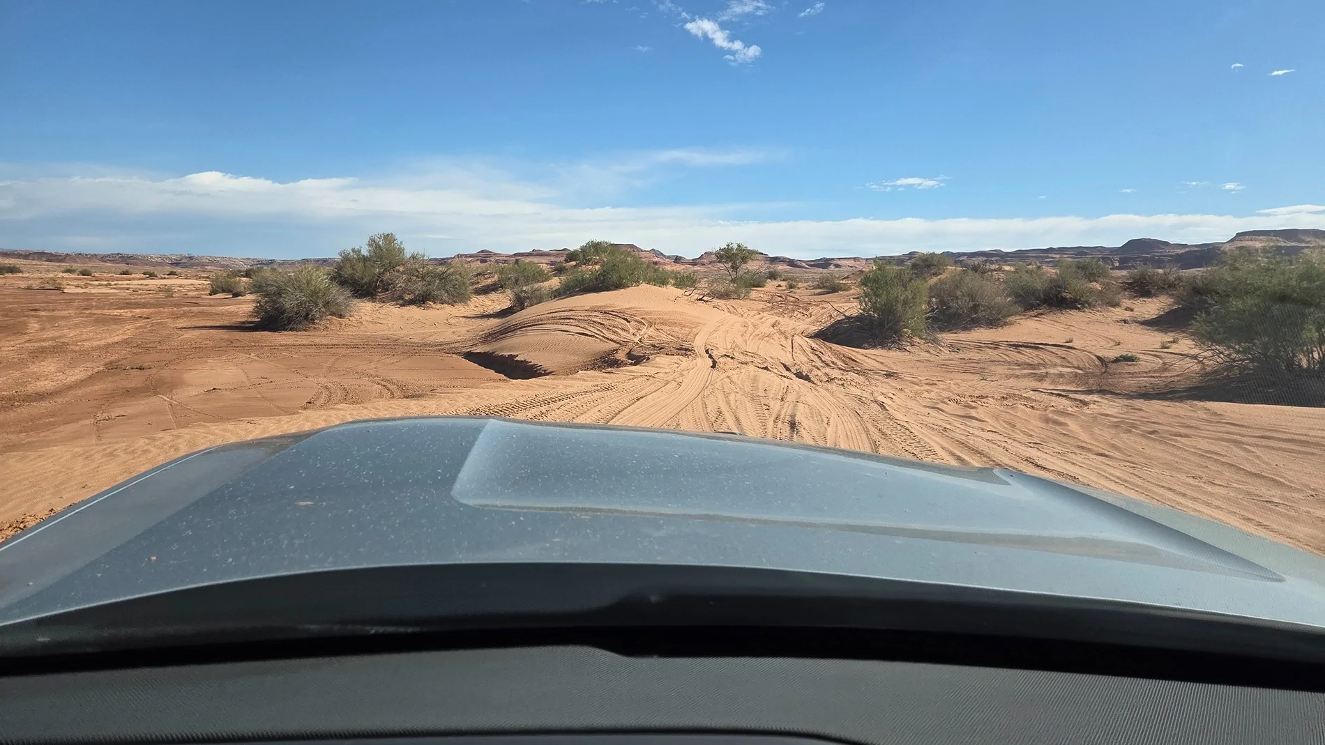

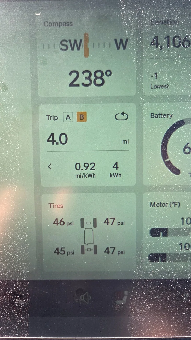

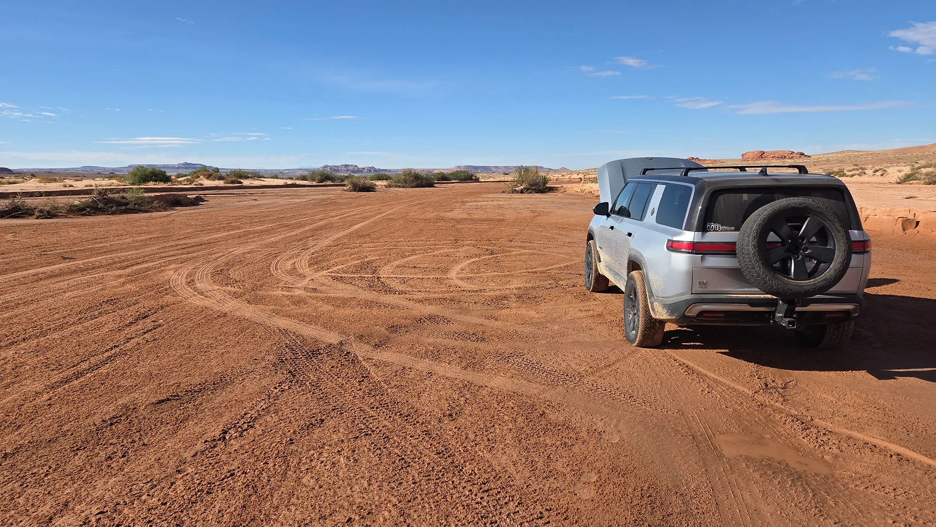

I've heard a number of people say they hesitate to air down offroad because they don't want to lose range and since I was camping by the white wash sand dunes near Moab I did an experiment to test this idea. My tires (275/60R20) were aired down to about 20 psi which was noticeably better in the sand vs 27 psi that I started with. I ran a loop of 4 miles, about half along a damp wash and half through some small dunes. I maintained a similar pace for both runs, driving at a reasonable pace and following close to my original tracks on my second run. For my second loop I aired up to 47 psi and got 0.92 m/kwh. For the first loop at 20 psi I got 1.3 m/kwh! I did a similar test over 10 miles of gravel/dirt trail, one at 45 psi and once at 25 psi and had nearly identical efficiency. My takeaway is for softer the conditions, airing down will reduce energy use since the vehicle won't be plowing through as much and for typical trails airing down to 30 won't hurt efficiency and improve ride comfort significantly. Don't be afraid to air down!

I was starting to air up when I took this picture:
