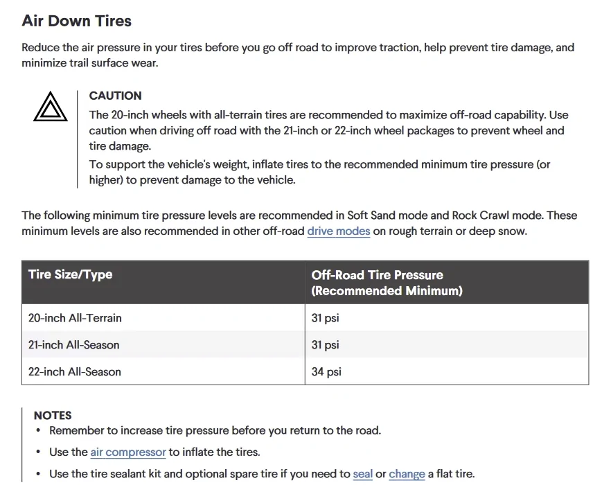

I've driven on the Outer Banks beaches several times aired down to Rivian's recommended ~30psi (on 20" AT tires) without an issue... until yesterday. Got bogged down in soft sand, frame almost sitting on the sand (even at highest air suspension). Aired down further to ~20PSI and with a litle shoveling was able to get free. I'm a bit worried staying below their recommended 30PSI due to the risk of tires "debeading" in such a heavy vehicle, but maybe Rivian is just being ultra-cautious and I'm just paranoid.

31 PSI on 20" ATs is very conservative, but I found the Pirelli's were a little soft compared to most AT tires I am used to. So probably why the conservative note from Rivian. I also think they are assuming rocks and other mixed terrain that require a lot of turning left and right, etc.. At the end of the day I think this is an experience thing versus a hard pressure recommendation or limit. With so many different types of tires, my recommendation would be to start at 25 psi and then adjust at 2-3 psi increments. In my experience, the tires should be noticeably squished down to have any real benefit. You will eventually find the sweet spot that works best for you.

Careful with the "off road" 30PSI recommendation. Off Road isn't the same as Sand Off Road :) If you're hitting rocks all the time, yeah.. 30psi seems fine.
For Sand... 20psi would be my MAX tire pressure, I would venture to go lower to the ~15psi mark with ease.
