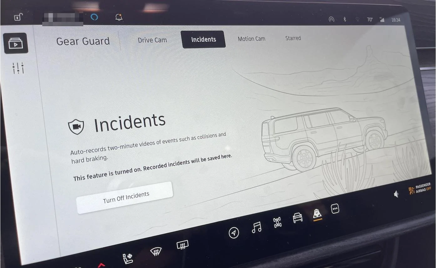

I got side swapped while driving today. No drive installed, but my understanding was something should still record in the "incidents" tab. I honked the horn thinking I read somewhere that it would save the last XX seconds to the car storage. No such luck.
Perhaps I need to enable the main Drive Cam, and attach storage. But that's not clear the way it's written. "Incident" was turned on, so fair warning. Too bad, it would have been a great video of a motorcycle fleeing police and then a van swerving onto the hard shoulder and smashing my mirror...

"When Incidents is on, Gear Guard cameras continuously record video, but no footage is saved. Incidents constantly monitors vehicle dynamics to identify incidents, and if one occurs, saves video of the event. For example, if you are cut off in traffic and have to slam on the brakes, this near-impact scenario would trigger the anti-lock braking system and, in turn, activate Incidents. The fifteen seconds of video that was recorded prior to the event would be saved, and Incidents would also save video of the following 1 minute 45 seconds. These Incidents videos are saved directly to your R1T or R1S internal hard drive; no USB-C drive is necessary."
I guess the horn is not one of the triggers for “incidents”.
Record a 2-minute Drive Clips when you choose Save Clip in the center display or when you honk the horn for more than one second (requires an external USB storage device).
