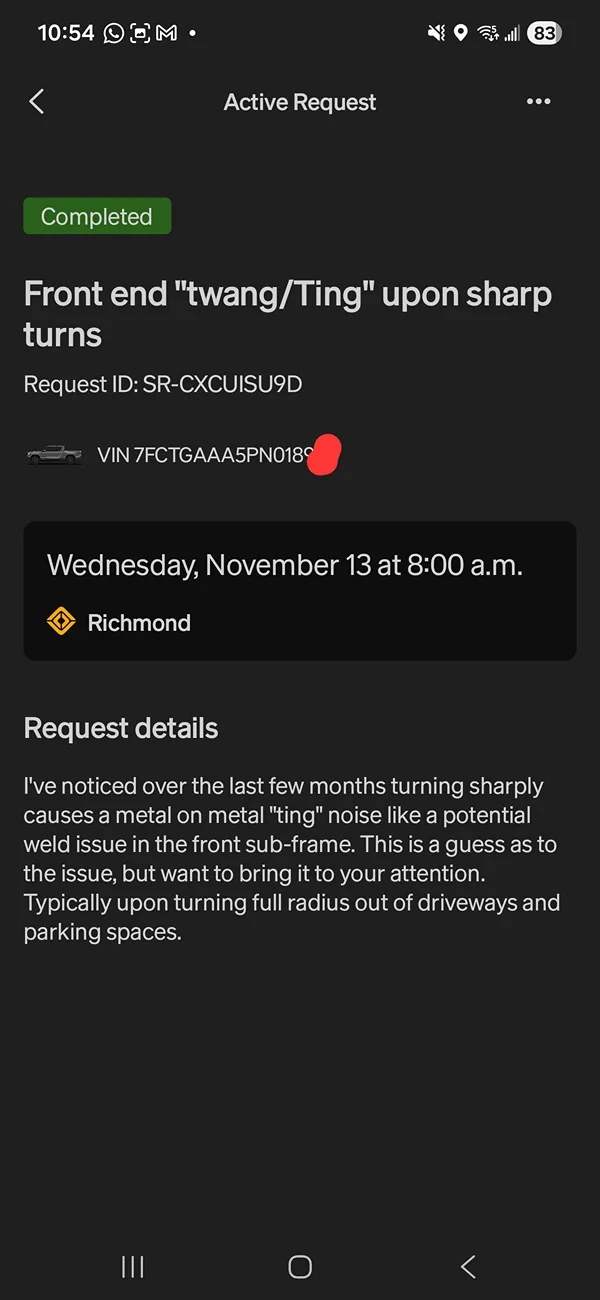

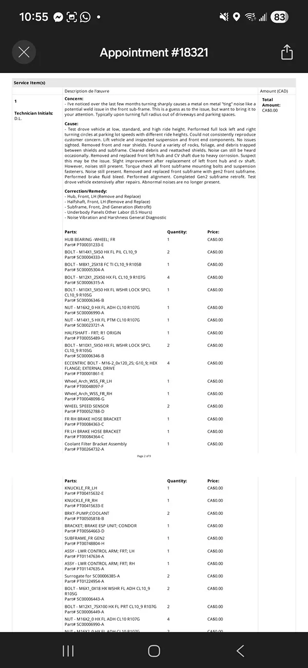

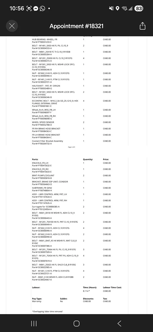

Yeah if you were experiencing it in a Gen 1 pre mid February 2023 build date, then you have a Gen 1 welded sub frame and it's the likely culprit. It hasn't come back since the retrofit.
Screenshot of the repair invoice for you.
Thank you so much!! Yes, I took delivery in November of 2022
