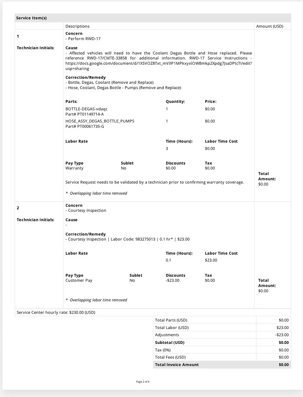

I had this done yesterday. It was a quick one day repair. Degas bottle and hose replacement. I didn’t have any warning lights or issues, SC just contacted me and said it needed to be done. I did just have the rear drive assembly replaced a few weeks ago, maybe that triggered something. Or maybe it was just coincidence. Either way, the truck is back and is as good as ever
Rivian R1T R1S TSB for Replacing Coolant Expansion Tank and Hose IMG_0049
