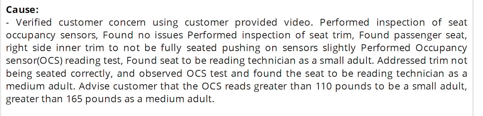

I visited the service center today (Sacramento, CA) for the same issue. The employees there were awesome and took my concern seriously. My wife weighs about 120 and it wasn’t triggering. The tech had seen this before and said a piece of trim under the seat might not be installed correctly and may be pushing up against the sensor wire. Sure enough, the tech fixed the piece of trim and now it works perfectly. Keep in mind that the sensor is at the back of the cushion and it will not trigger if your butt is not pushed all the way back (even for me). Here is the note from my service center visit:
Rivian R1T R1S PASSENGER AIRBAG TURNS OFF 1698724673509
Thanks for posting this. I will take this post into the service center next month when I have the appointment!
