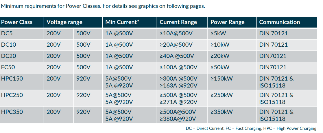

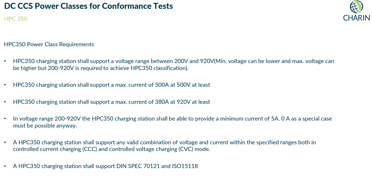

Huh. Other than a “wouldn’t charge at all on any stall at any speed” EA a couple days ago, I’ve never had a problem with any 350kW stations. EA, EVgo, even the very rare ChargePoint 350kW. Did an EA 350 kW an hour ago, and an EVgo two days ago - got 215kW peak on both.
Boosting from 215kW to 250kW shouldn’t matter for what charging stations it works with - to reach 250kW requires boosting Amperage over CCS’ official maximum 500A. So you won’t get 250kW at any existing station anyway. (Except maybe RAN if they boost the maximum amperage beyond 500A the way Tesla does.) Maybe it’ll get you 250kW at a Tesla Supercharger when the official adapter comes out though…
Not with the current Tesla superchargers. MAYBE with the v4 chargers when they arrive... but that doesn't help with the rest of the Tesla supercharger network which is v3 or less.
Tesla v3 Magic Dock chargers are rated 250kW but will only charge Rivians at 150kW and some other brands only get 100kW. No adapter is going to change that, because it happens due to the voltage and current limits of the charger.
