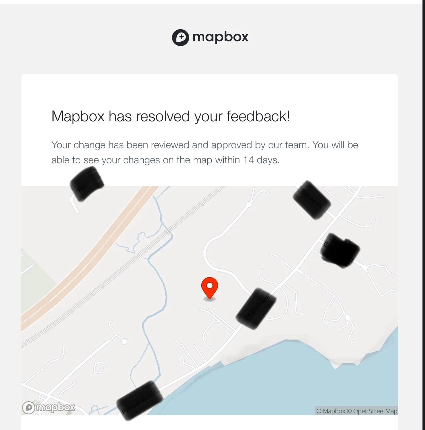

Last week, when we got our Rivian, I discovered I could not get the “Proximity Locking Off At Home” to work with the Rivian parked in our home detached garage. When I experimented with navigating from our garage to our home address the Mapbox software calculated the Rivian in our garage was 300 feet from Mapbox’s pin for our home address.
I used Mapbox’s online address correction reporting tool to submit an address location correction that moved our home address pin from near my mailbox at the street to my detached garage down our long driveway. In less than a week, I got an email from Mapbox that they investigated my request and have accepted the change - my pinned address location in Mapbox will be my garage within two weeks.
This should enable “Proximity Locking Off At Home“ to work for us. I can’t be the only one who may have experienced this issue with Mapbox.

Check your address location using Mapbox, the mapping Rivian uses. Google Maps is not Mapbox.
Here is the link: https://www.mapbox.com/search-box
