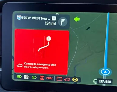

We have a 8-night work trip to northern Kentucky. Last night I packed the fridge in my R1S subtrunk with food we wanted to bring with us. Thankfully I plugged it into the 12V outlet rather than 120 (more on that in a bit). I turned on the outlets for 2 days (so I didn't have to worry about it) and went to bed. We left the house shortly after 5am this morning and roughly an hour into our trip we got this:
Why does shit like this happen ONLY when you're leaving on a long trip? Anyway, our R1S spent two weeks in the Malvern SC in January for the same issue and it hadn't happened again since we got Rosey back so I thought it was fixed. No biggie - we had a decent shoulder on the road, so I pulled over and did a full reset and we got back on our way. I didn't think at all about my fridge - just that we're going to be an 8+ hour drive away from home in a car that may give us issues.
