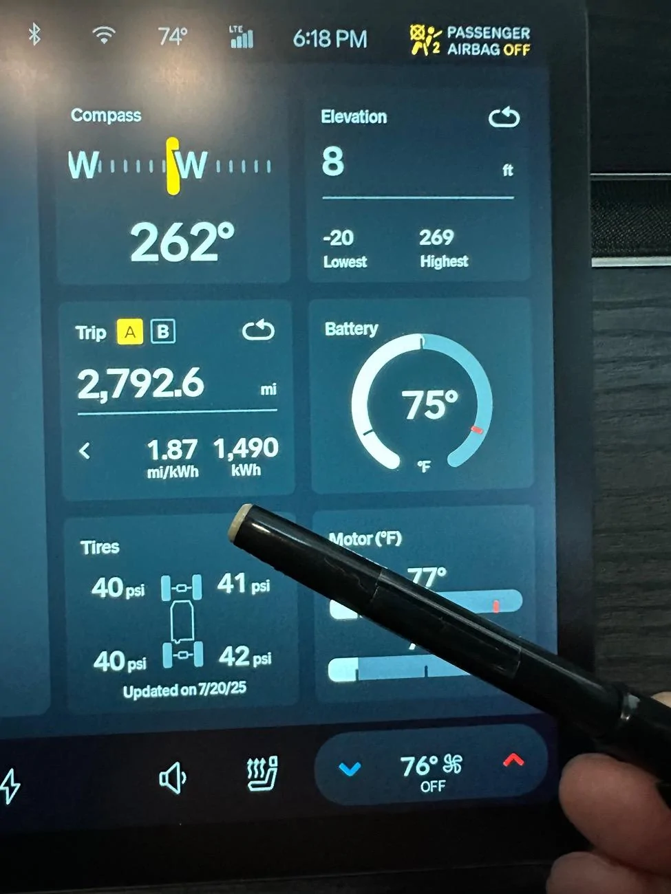

Manufacturer's spec for energy consumption is 410 miles (range estimate) ÷ 141 kWh (battery capacity) = 2.9 mi / kWh. I confirmed this with Rivian Service support.
I am getting 1.87 mi / kWh. Photo attached for reference. Trip A is total vehicle mileage (never reset). Rivian Service is looking into the issue.

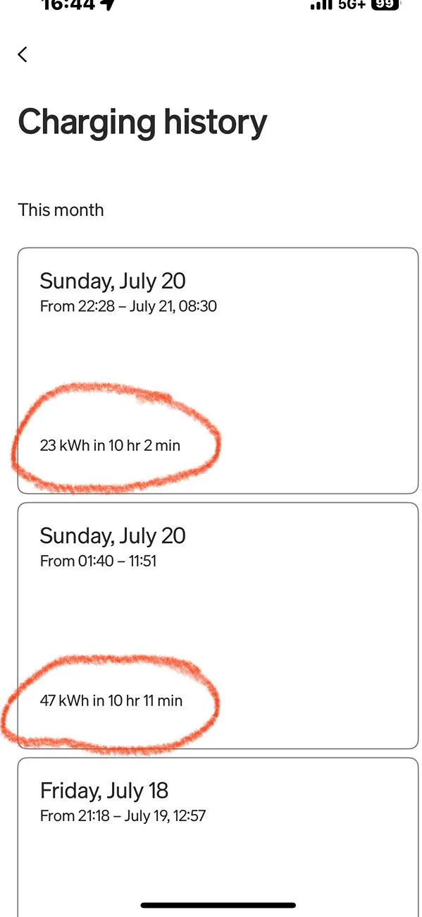

Manufacturer's spec for Rivian Level 2 charger energy supply is 11.5 kW up to 25 mi per hour charge rate.
Since put into service, historically, I am averaging around 2 to 4 kW per hour charge rate on all charges large or small no matter what time of day. This is taking way too long. Photo attached for reference. Majority of charging is during the 22:00 - 14:00 charging schedule that I have set to take advantage of utility company's least expensive rates. Rivian Service advised me to contact the Manufacturer because the charger is not covered by Rivian Service.

Your mileage does seem rather low however, lots of things can dramatically affect efficiency. Does the number on the efficiency graph in the driver display match to what's in the trip computer or are they different? On my Gen 1 Quad with AT 20 wheels and tires, my lifetime efficiency is a bout 2.0. About 1,000 miles ago I changed from the stock Pirelli tires to the Goodyear Wrangler tires that are an inch lower in overall diameter and are more efficient. Since then my efficiency in the trip computer has been about 1.85 miles/kWh yet the efficiency graph shows a lot higher. I've attributed this difference to its summer, the dog goes everywhere with me, and I leave pet mode on. Pet mode will affect the overall efficiency. I'm going on a long road trip and will be curious to see how the mileage stacks up then.
Other things to check are tire pressures and uneven wear which could indicate a bad alignment. Either of those will cause extra friction on the tires and could affect efficiency.
I've also noticed since having the EV that any little thing had a bigger effect on efficiency: wind, elevation, temperature, towing, adding a bike rack, etc.

I see a few problems already. Look at your tire pressure it is very low and will result in poor range. Also you speed, hills, wind play a big factor in efficiency.

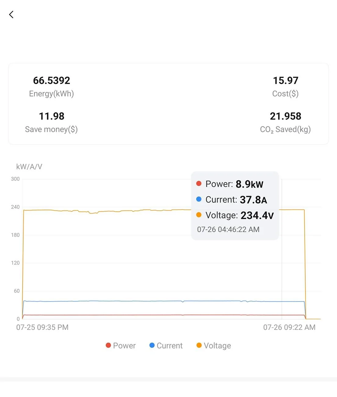

I have the same spec as you (R1S G2 Dual Motor Max Pack). The onboard charging data tends to start when you plug-in the Riviran, not when it actually charges, and will give you a skewed view on how much energy the Rivian is taking over the charging period. Because of this, I have started using the charging report from my Emporia charger. Also, you did not state what amperage you are wired for (48 Amp?). Have you checked what the current limit is set to in the Rivian? It could be set to a lower current limit than your charger is capable of delivering.

2900 miles over the past almost year suggests a lot of idle time, which will translate to vampiric loss, which will clobber your total "efficiency" as shown on the meter. Best bet is to charge to 70%, do a drive at normal speeds (highway + city), and see what you get over 50-100 miles.
Back-of-napkin math:
2900 miles, assuming standard efficiency: 1000kWh
1.5kWh/day vampiric losses (350 days): 525kWh
Total: 1525kWh
2900 miles / 1525kWh = 1.9kWh/mile
Your tire pressures are too low. Not sure which tires you have but this is definitely too low and will reduce efficiency.

Will pay close attention to energy consumption after next 70% charge and inflating tires on 22 wheels to 48 psi factory recommendation. BTW received the vehicle returned from previous Rivian Service Center with tires at psi indicated in photo (above). Of course that's an owner responsibility but suggests it was not checked during that service appointment. Rivian Service stated TPMS alert does not activate unit below 20% recommended tire psi.

2900 miles in a year? I don't think you have broken it in yet.
You will never get 2.9 eff, BTW. Unless you drive at 40 mph. This is probably a combination of low tire pressure and short trips. I have a similar config and my avg after 23K miles is 2.5 miles/kwh.

I also have a 2025 R1s dual max preformance. Most of my miles are around town and I get 2.5 - 3 miles/kwh. Road trip and highway miles are much less efficient with accessories mounted and driving 80mph. Our average over almost a year is 2.5 miles/kwh after 12k miles.
No issues with home level 2 charging. Rivian app matches what the emporia charger puts out. Miles add up as expected.

If you are only getting 2-4 kwh charge rate, I'm assuming it is not full when you go to use it. That would mean you have an issue. Otherwise you may be plugging it in and 2-4 hours later it is full but you leave it plugged in for ten. You need to look in the charge history to see the rate while charging.

ISSUE 2
I don't believe that there is anything wrong with your Rivian charger. No power cycling, rebooting, etc. needed. I believe that the issue might be the Rivian app itself. Once again, Rivian software experts, god love 'em.
I keep very detailed logs on my EVs charging sessions; noticed this issue of seemingly very low charging rate lately as well and confirmed that the app information is erroneous. At least for the two charging sessions I Initiated since July 25. Not sure if related to software update 2025.22.01 installed on 7/23.
Reason #1
The Rivian infotainment GUI shows for the last charging session 40 kWh in 3 hours, 50 minutes or 10.4 kWh. The Rivian app, on the other hand shows in the History section that this charging session lasted 11 hours 16 minutes or 3.6 kWh. Third-party logger I use and my own data say that charging rate was 10.4 kWh. Typical charging rate is between 10 and 11 kWh.
Reason #2.
Next-to-last charging session: charging history on app says 53 kWh in 11 hours and 20 min., or 4.7 kWh. My own data as well as third-party logger showed that actual charging rate was 10 kWh in 3 hours and 56 min.

My Autel charger is nice because it logs every detail of everything.
