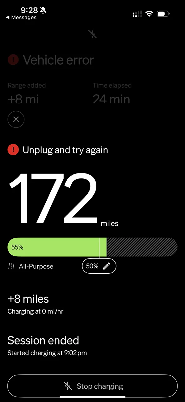

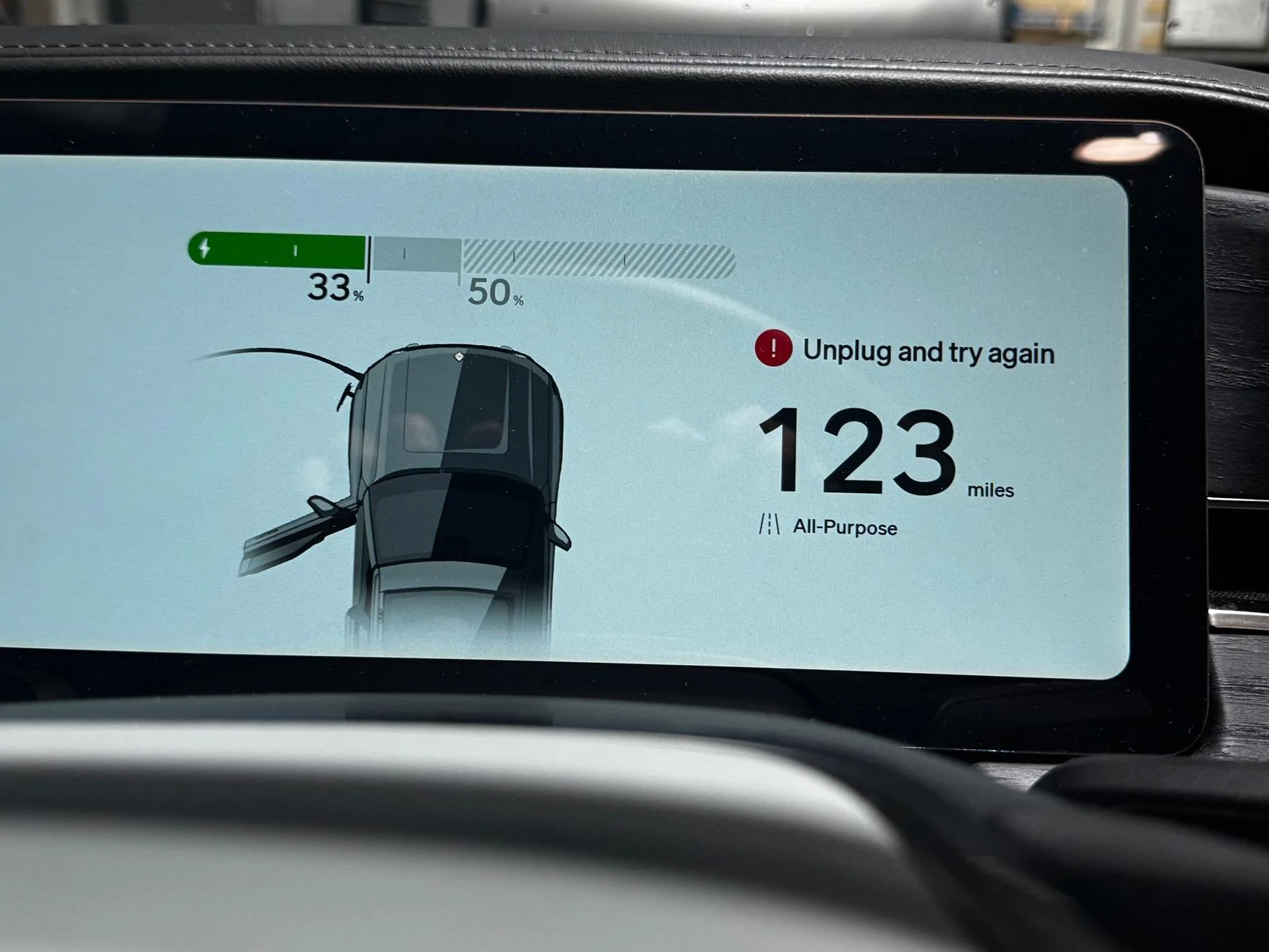

I just got my Rivian last week, gen 2 R1S. I've had this error with the included Rivian portable EVSE. For some reason, when I first put it in, it defaulted to 33 or 34 Amps. I turned it down to 32 and thought it fixed it, but it happened again last night. It'll start to charge, give the error, then some time later finish up charging. So, it hasn't been an issue yet, because I haven't gone on any long trips yet. It could be annoying if it happens when returning home with a low battery %SOC.

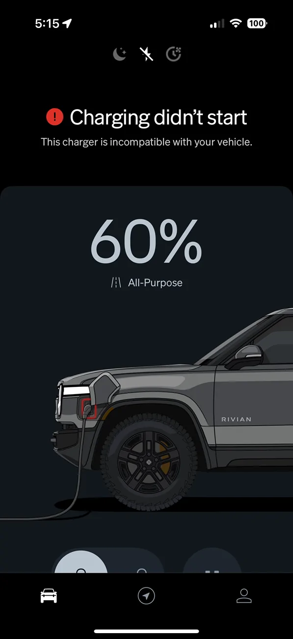

My R1S will no longer take a charge using the Tesla universal EV charger, even in compatibility mode. It start yesterday and I’ve tried everything… rebooting the car, rebooting the charger, resetting the charger to factory settings then manually loading firmware updates. Are there any other tricks to get this to work? I don’t want to spend a bunch of money charging at various stations around the city or have to install another charger.
