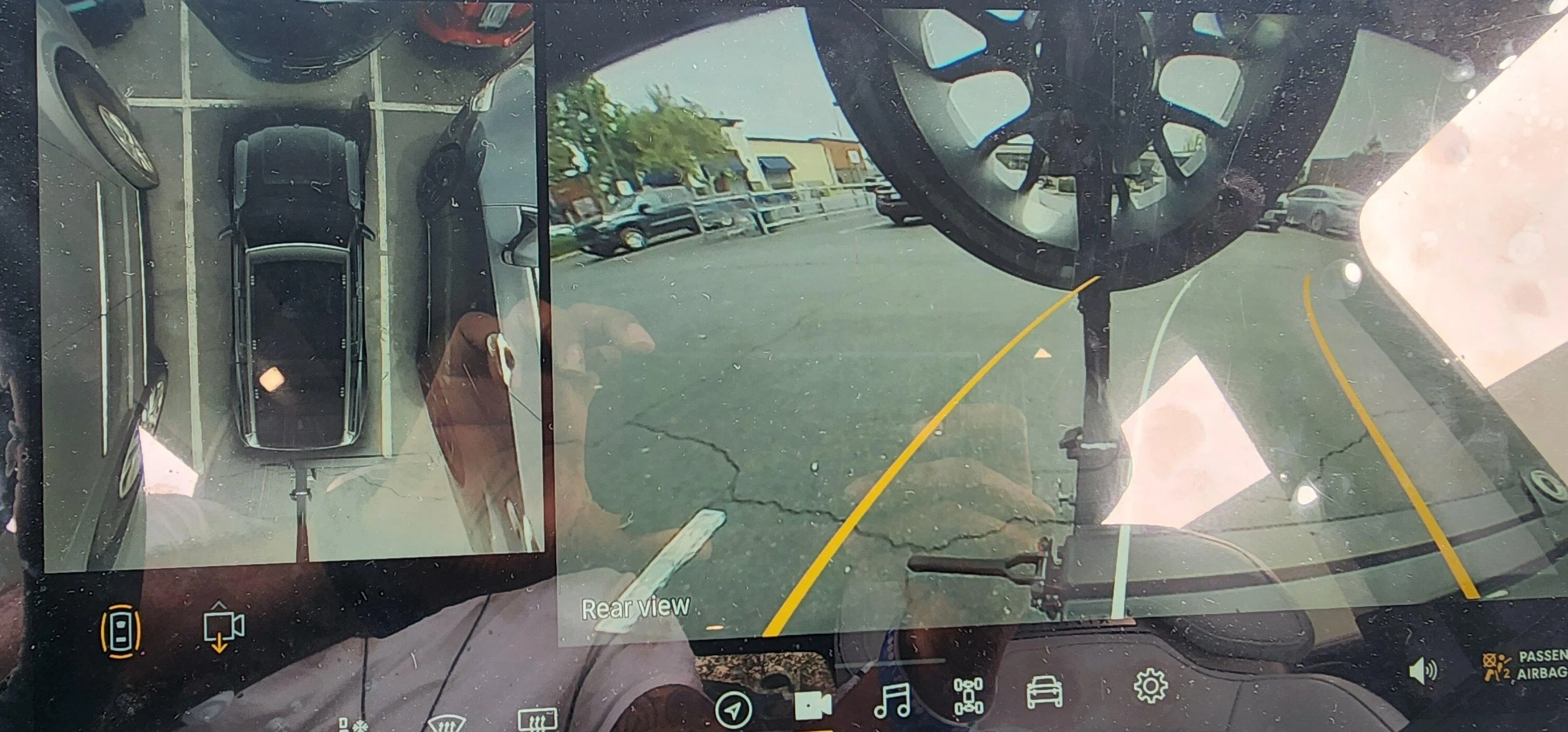

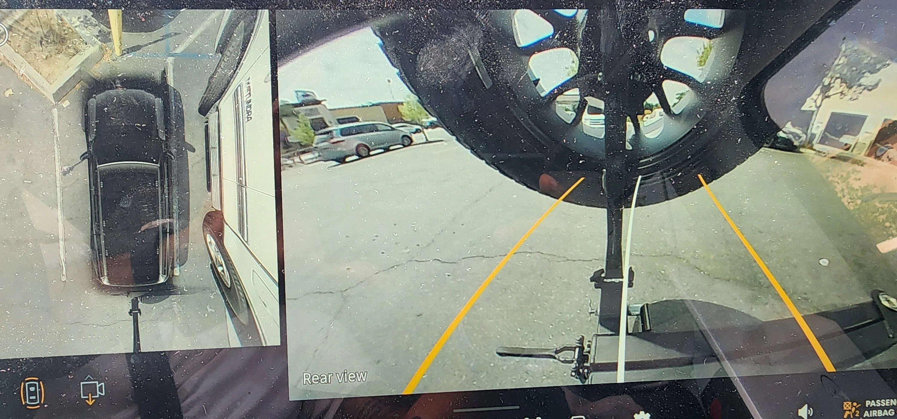

In reference to your question re: backup camera views...here you go...and this was fully expected:
Rivian R1T R1S R1S Spare tire hitch mount options? 20230810_105615
Rivian R1T R1S R1S Spare tire hitch mount options? 20230810_105629
Rivian R1T R1S R1S Spare tire hitch mount options? 20230810_143329

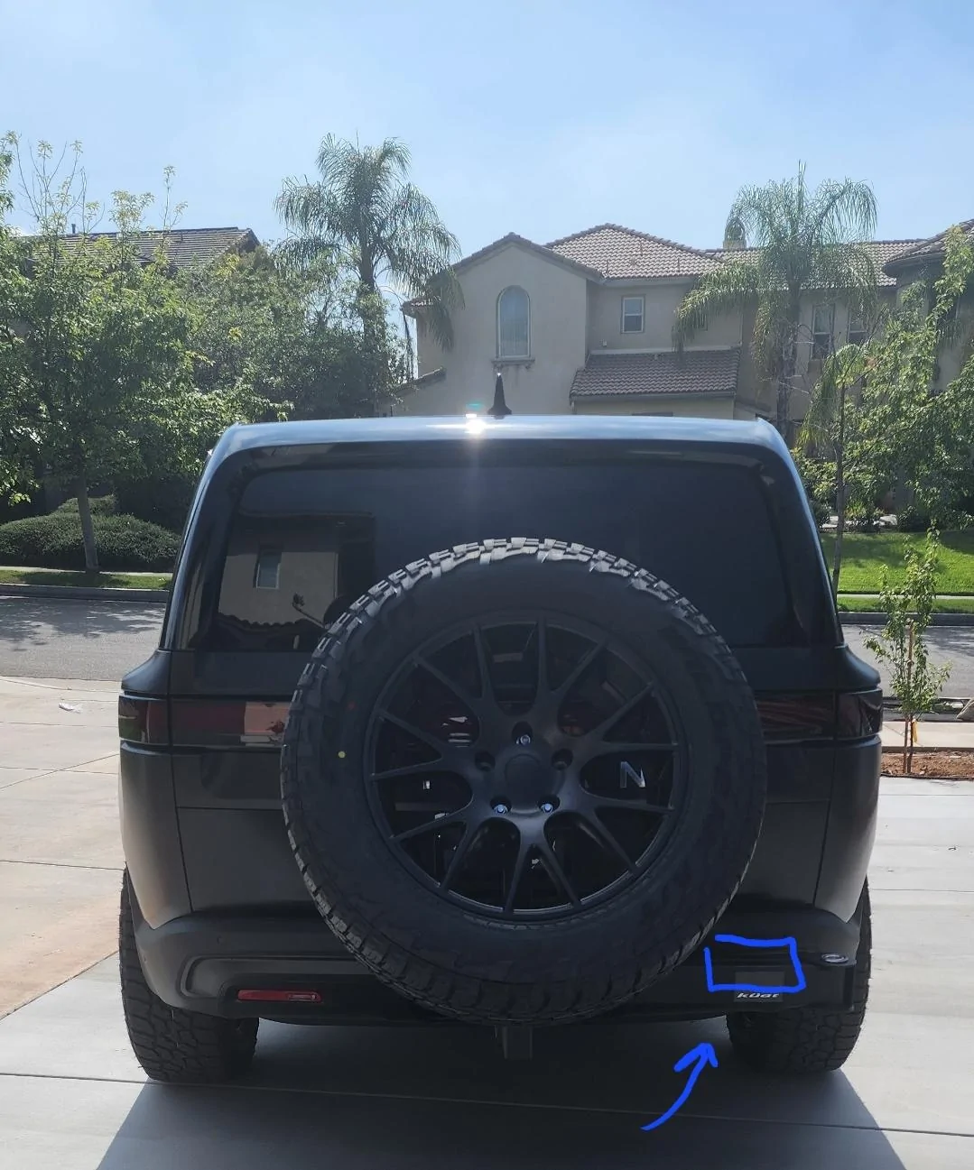

So here's the latest on my newly converted off-road setup...
Everything worked out exactly as I had hoped! I'm just going to add a few security-related items later, but this setup is functional...and sturdy. NOTE: I'll mount my license directly to the upper part of the hitch swing arm, to the right of the spare.
-Kuat Pivot v2 hitch swing
-eTrailer spare tire carrier
-Factory Reproductions FR70 Dodge Ram Hellcat Replica Wheels 20x9 +25offset
-275/60/20 Falken Wildpeak AT3W
Rivian R1T R1S R1S Spare tire hitch mount options? 20230810_161304~2
Rivian R1T R1S R1S Spare tire hitch mount options? 20230810_161438
Rivian R1T R1S R1S Spare tire hitch mount options? 20230810_161522
Rivian R1T R1S R1S Spare tire hitch mount options? 20230810_161539~2
Rivian R1T R1S R1S Spare tire hitch mount options? 20230810_161630~3
Rivian R1T R1S R1S Spare tire hitch mount options? 20230810_161747~2
Rivian R1T R1S R1S Spare tire hitch mount options? 20230810_161819
Rivian R1T R1S R1S Spare tire hitch mount options? 20230810_161836
Rivian R1T R1S R1S Spare tire hitch mount options? 20230810_161918~2

Thanks for the back up camera pictures! All things considered it isn't terrible. Might get a bit worse if you end up cutting the carrier closer.

This is actually way better than I expected to see with your solution. I don't think I have a photo of mine but I originally opted to keep the wheel quite a bit lower.

Totally agree with that consideration if/when I trim the carrier shank to bring it closer...but the other good thing is that I can always shift the carrier back if needed/desired.
Here's where I'm going to simply drill two holes and mount my license plate to the upper swing arm:

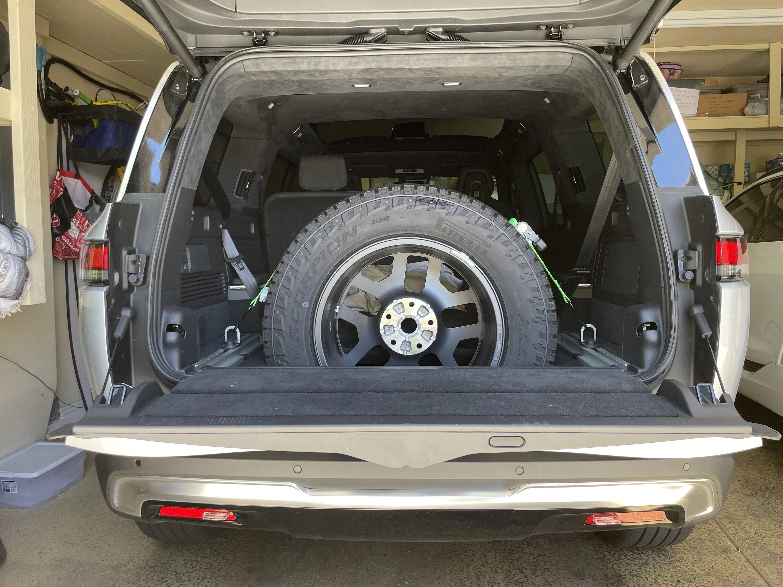

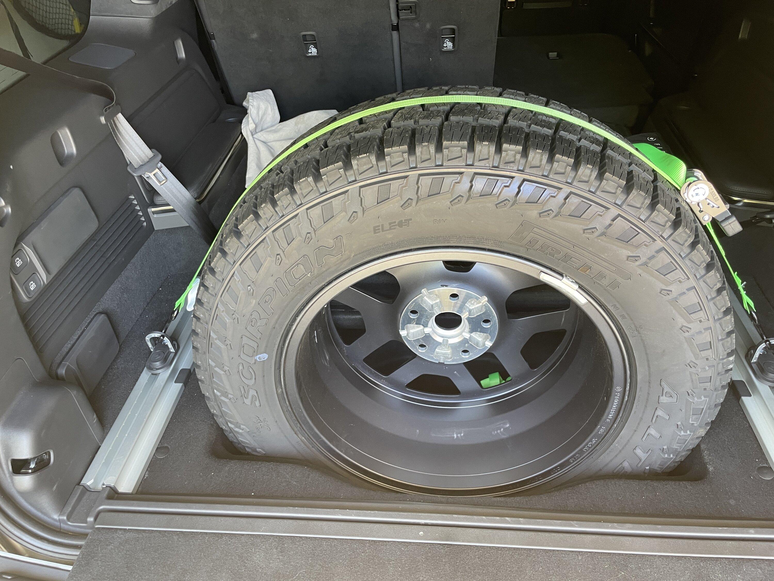

Temporary measure for newbie:
I think I saw a YouTube video from Riviandad or another owner doing this and just wanted to try it myself. This is a 20” AT upright in the empty spare well. It literally fits like a glove and the built in tie downs are perfect for securing. Still decent cargo space with back row folded, and recovery gear goes to the frunk. It will at least buy sometime until more options are available. Downside are loss of cargo, potential of sticking filthy blowout into the well, and perpetual rubber smell in cabin.
I was going to get the setup that OP has, but I’m concerned about the dynamic stress in the lateral direction if there is a lot of yaw during trial riding. I get tossed around just taking speed bumps at an angle lol. The eTrailer spare mount, I think, is rated for 200 lbs, but is that just directly over the mount? Any concern from OP?

Its like the space was meant for that tire!
