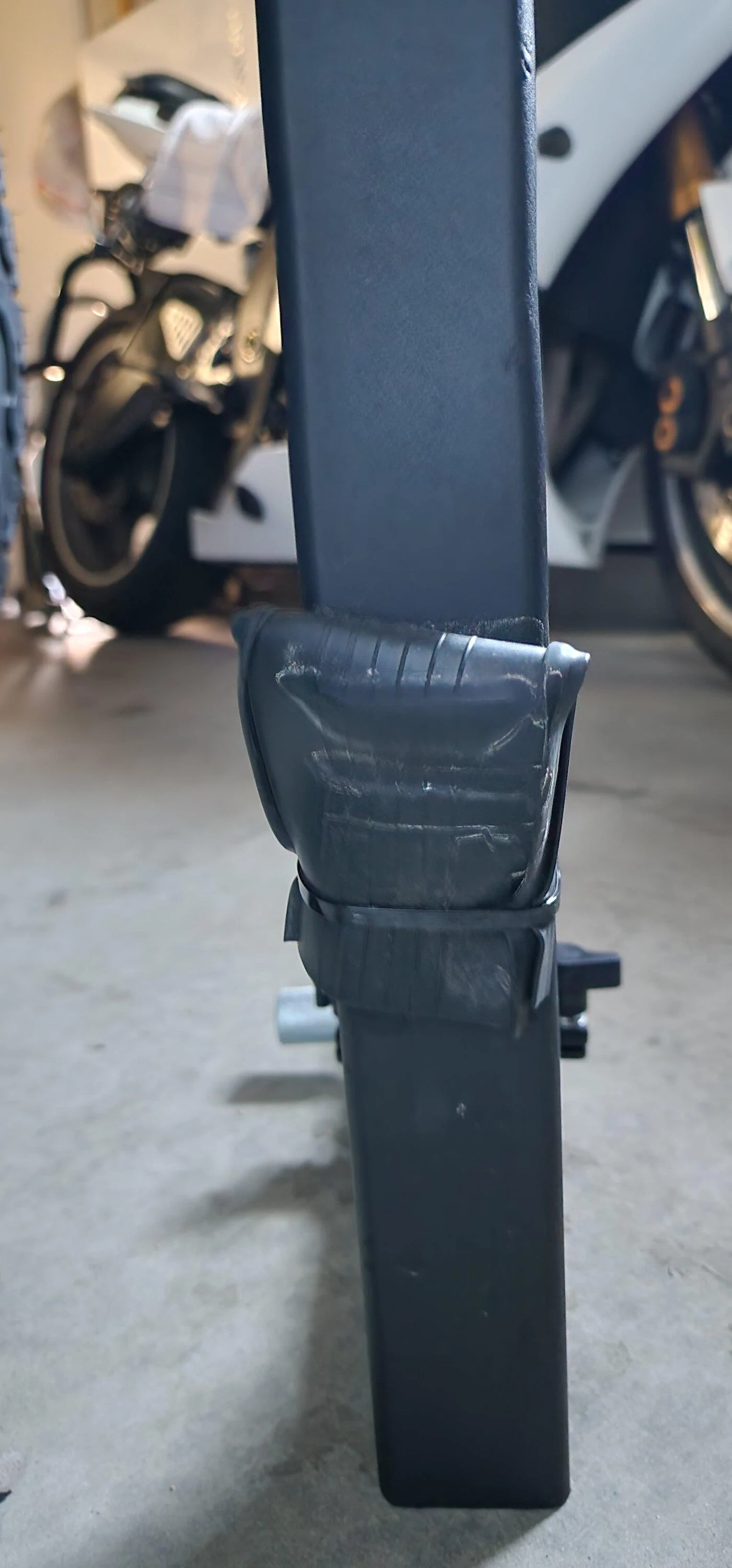

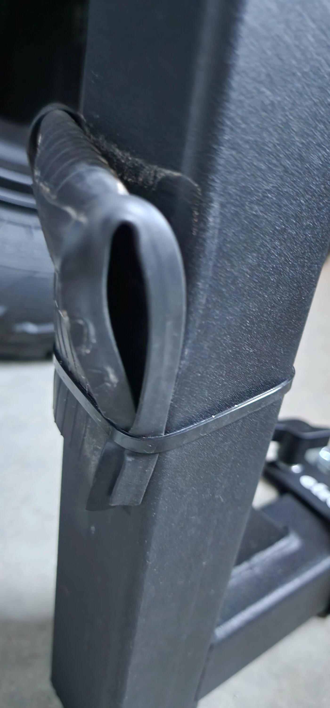

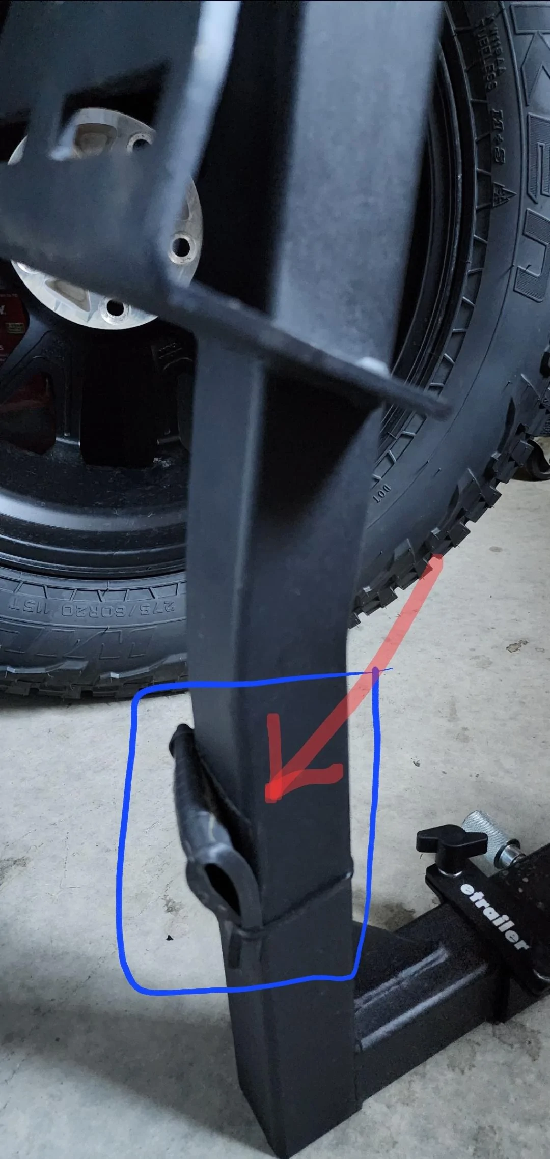

I just received my Etrailer order and unfortunately the stock Rivian 20” staple wheels are shaped so deep that the center of the wheel doesn’t sit flat against the angled support (not angled enough) of the hitch mounted tire carrier (https://www.etrailer.com/Spare-Tire-Carrier/etrailer/e98ZR.html). For the moment, I’ve inserted some foam where the inside of the bottom of the wheel well rubs the vertical post, but I’m now uncertain about the long term possibilities of the creative low cost option mentioned in this thread, for my application. There’s going to be a lot of pressure on the carriage bolts since the wheel isn’t solidly resting on the angled steel support. As for adjustability, the bottom two bolts of the carrier can only move laterally, so I don’t see how to overcome this issue. If I turn the wheel around, then the angled steel support of the carrier will scratch up the face of the wheel.
I also had to buy longer carriage bolts to get to this point. And it took quite a long time just to get the wheel / tire mounted to the carrier. Much more tedious, awkward and frustrating than just throwing the (heavy) full size spare in the back of the R1S. I certainly won’t be doing this as often.

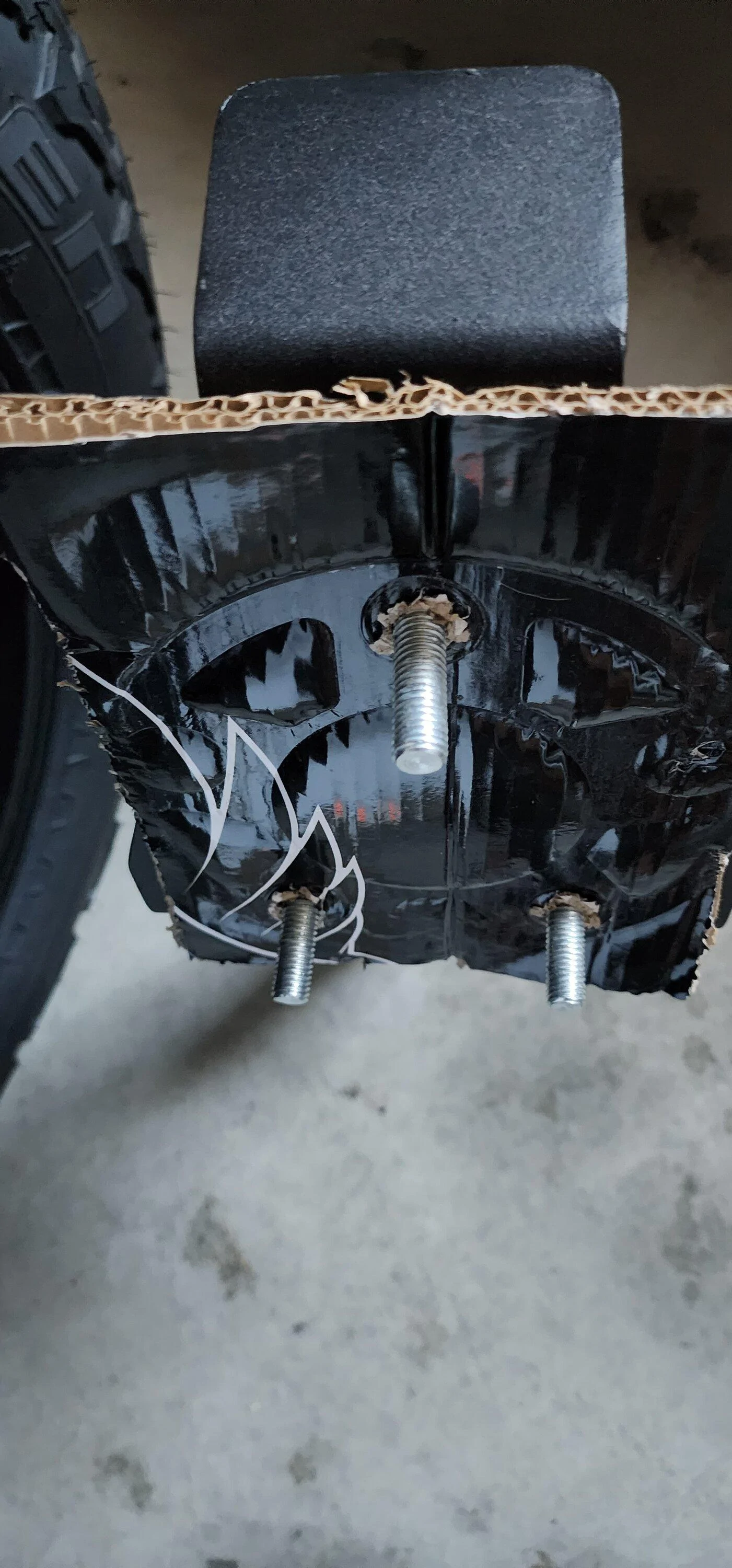

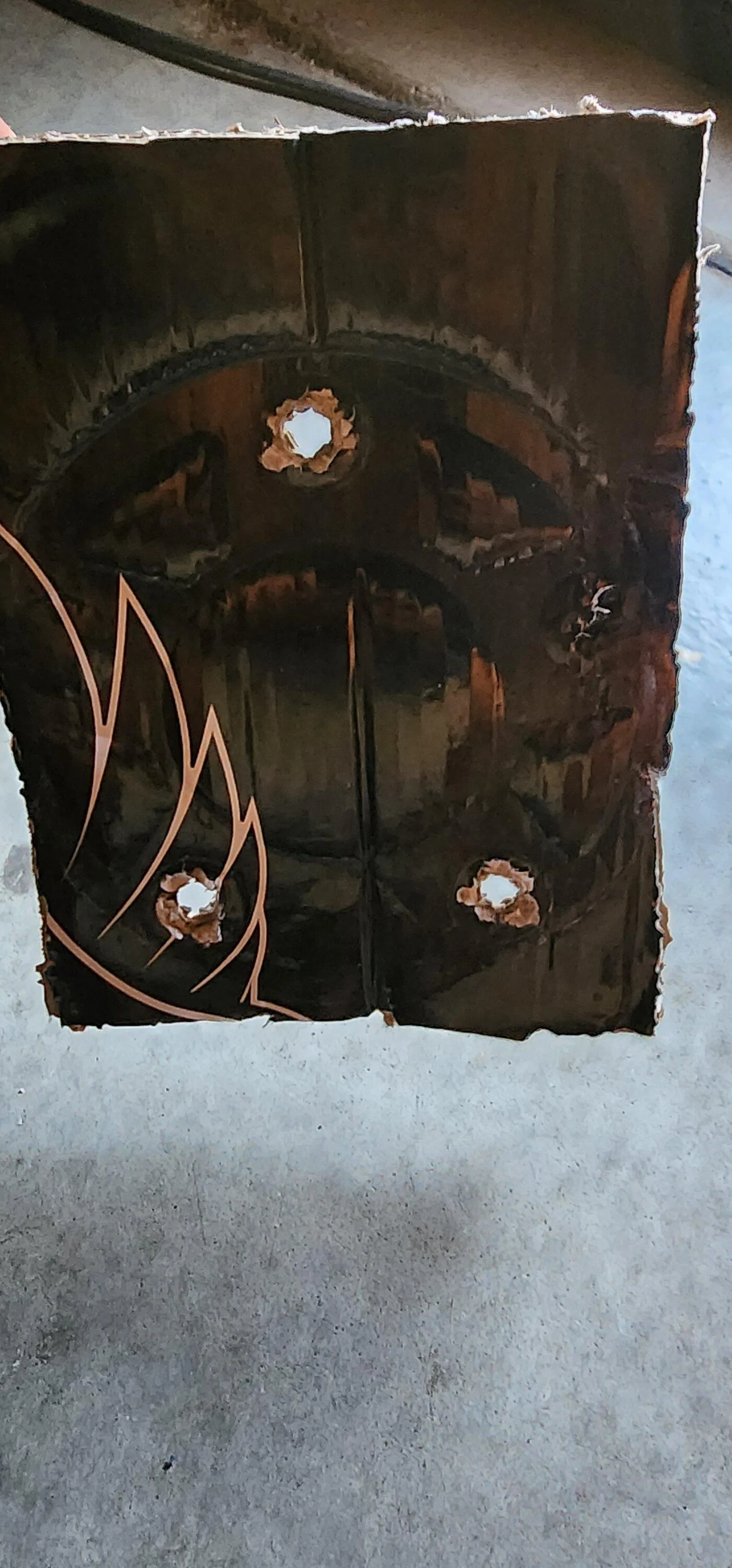

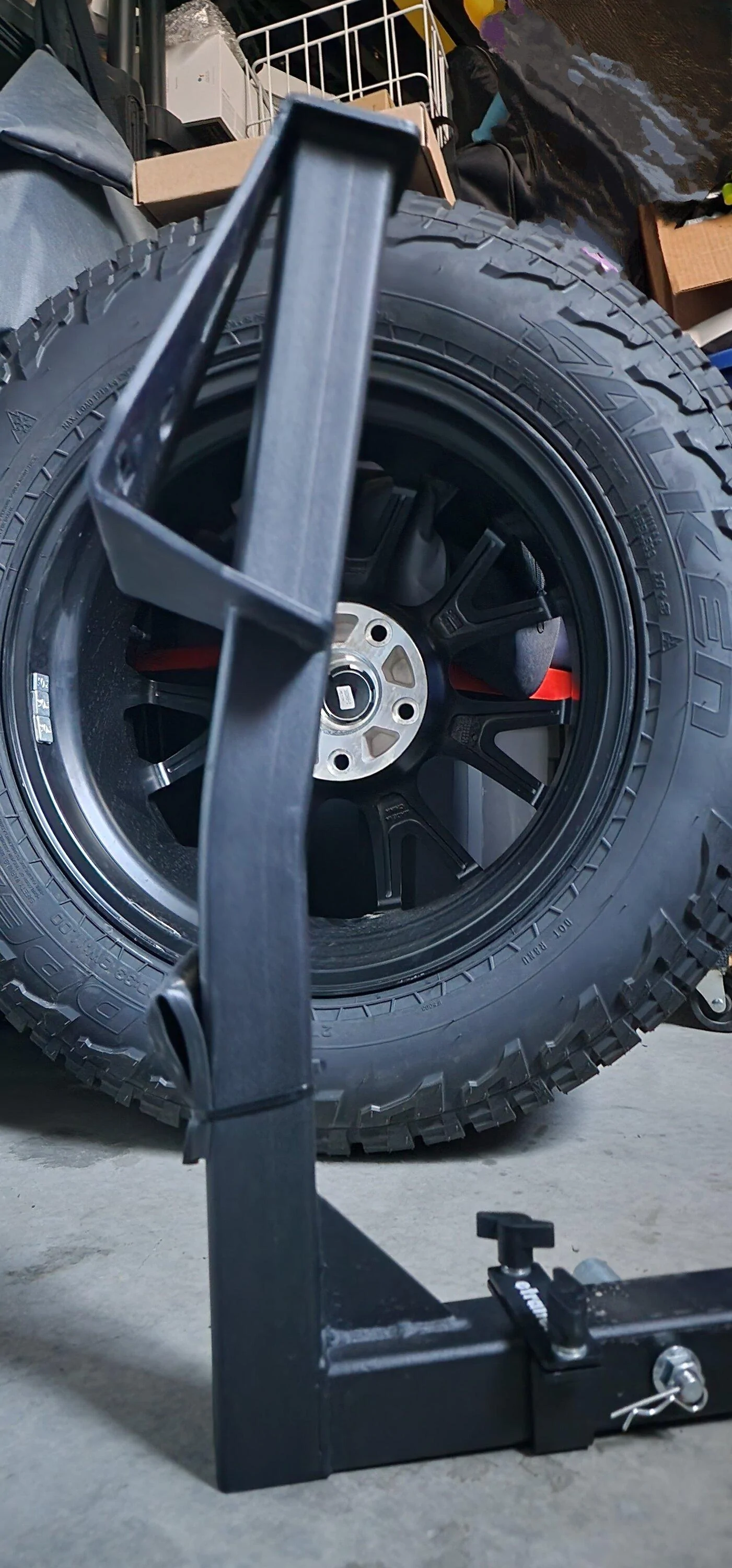

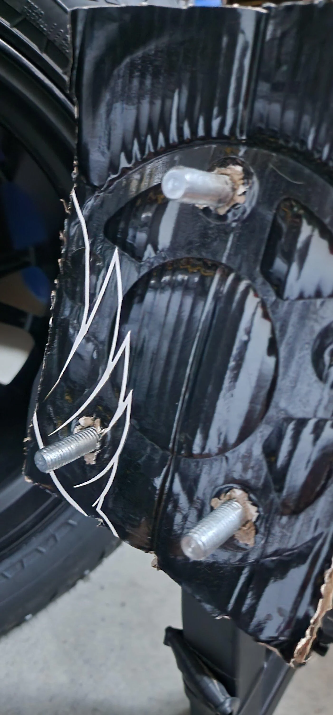

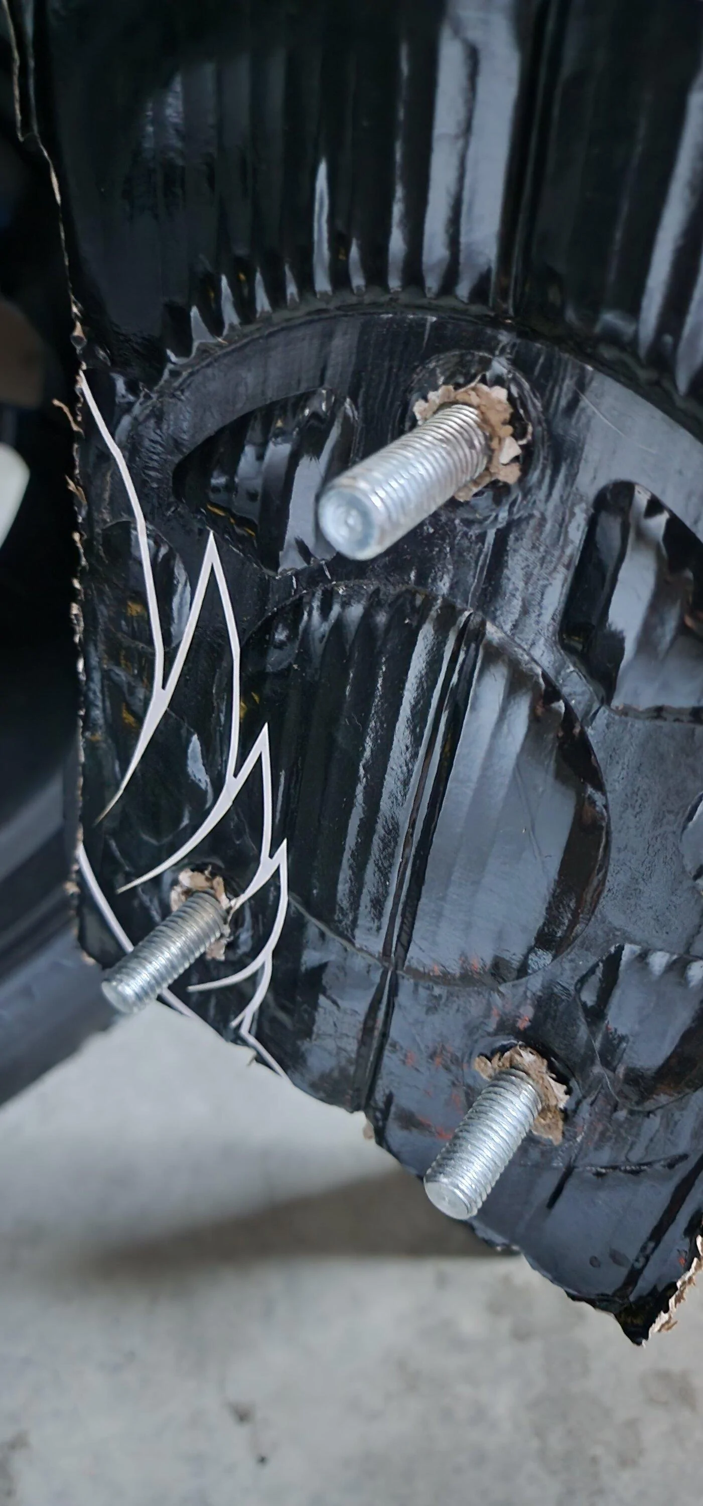

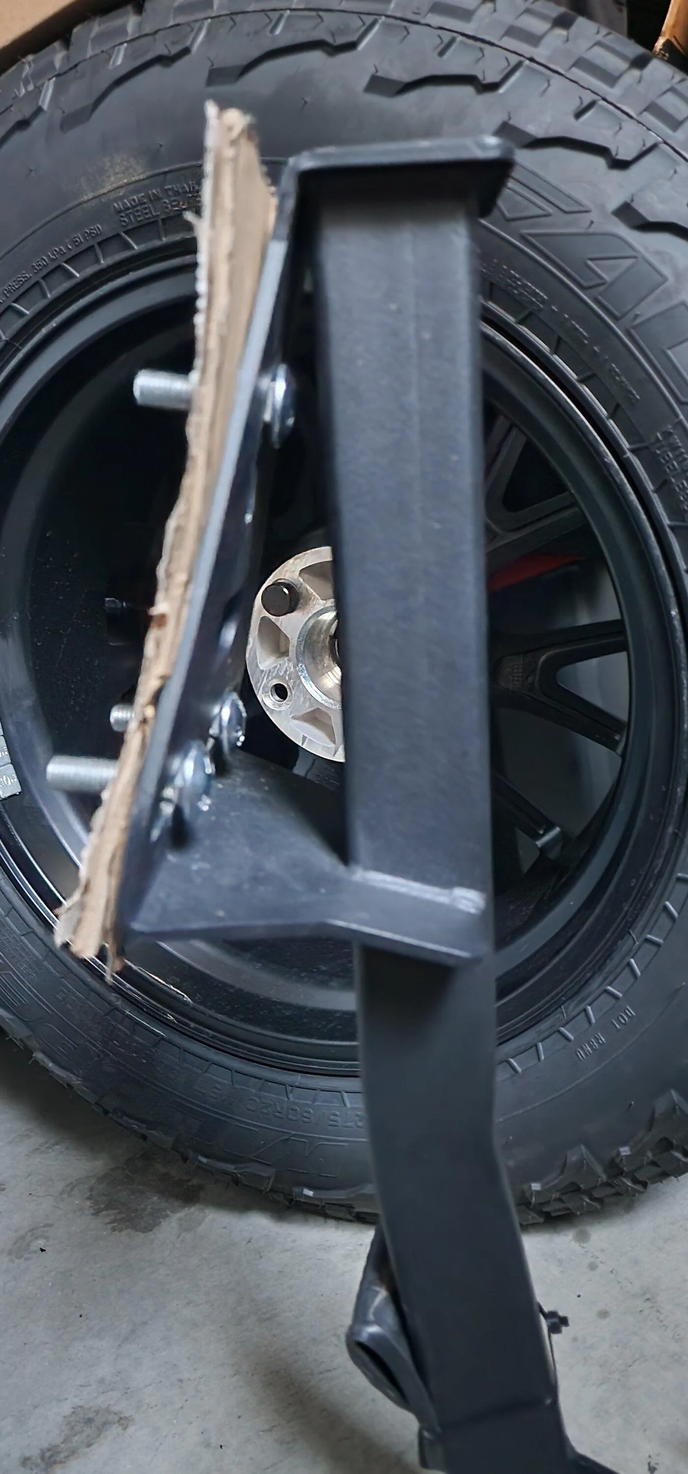

This is interesting...and I think useful for this thread. The offset on my aftermarket wheels is +25, and the lower, inner, part of my wheel/tire does make some contact with the tire carrier arm as illustrated in some of my earlier pics, however, the contact is very minor. I am able to securely mount the wheel at all 3 points to the carrier, however, I acknowledge that it can be difficult to line up the holes initially, so I came up with a very-temporary, low-tech solution for this, which was to take a piece of cardboard, place it on the back of the wheel, then poke 3 holes through the wheel and the cardboard for alignment (DON'T JUDGE ME ? ). From there, place the bolts in the carrier holes, then secure the cardboard to the carrier and bolts, then secure the lock washers onto the bolts. From there, it should be much easier to mount the wheel to the carrier. I've done it multiple times with ease. Again...don't judge me, but it works!!! Additionally, to mitigate rubbing/abrasion of the wheel on the carrier, I devised a rudimentary rubber pad and zip-tied it to the carrier arm where the wheel contacts the arm. Problem solved. See pics below for context.
Now, as it relates to your initial, and largest problem with the stock Rivian +48 offset wheels not sitting flat against the angled support arm: I think @csharp has a great idea...which is to simply use a spacer between the carrier mount and your wheel. I think that, along with your longer carriage bolts should solve this problem.

So the two 1/2” spacers weren’t nearly enough. Looks like 2” is minimum with potential contact of the eTrailer vertical bar with the wheel. So really need 2.5” of additional clearance.
I mocked this up using 2” hitch and one of the 1/2” spacers, which gives about 1/2” clearance between the post and wheel (see pictures).
Problem: apparently no such thing as a 2.5” spacer, at least in the 5 x 5.5 bolt patter needed.
I just ordered a two inch spacer and will pair it with one of the 1/2 inch spacers I already received.
Will post new trial tomorrow.
