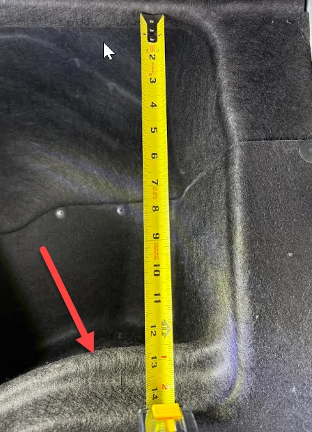

I don't have a spare for our R1S and would like to use that space to fit the largest dual-zone electric cooler I can. My 1st-world "problem" is that dual-zone I want is the Bodega 38QT which is 14.1" from front-to-back. As you can see from the photo below, I only have about 13 inches with which to work:
Here's my question: What's behind/under the trunk liner where the arrow is pointing above? Specifically, could I compress that part of the liner with a hammer-like tool to "encourage" the cooler to fit properly without doing any damage to anything other than the trunk liner??
My fear is that it's where Rivian hides the secret glass vials of corrosive brown sticky stuff that, when the vials are broken (think of the codex in The DaVinci Code), leak all over your wiring harness and destroy your vehicle. Just kidding, but is there more of a purpose than to support the tray that holds the first aid and compressor kits?
I thought about using some of my tools to pop up the liner to look under it, but if someone has already done that I'd really appreciate you sharing what you learned. I don't think I'd have to do much compression, but don't want to break anything either.

When the tech came to install my inflatable spare, he easily just took out those plastic pieces and the whole liner came out. The spare comes with its own liner, which goes back in.I can’t recall if there’s extra space under that specific area ( though I doubt it) that you’re looking at, but it’s easy to see what’s there just removing that liner.

Thanks - It doesn't look too tough to remove, but historically I've been less than graceful doing things like that. I may give it a go this weekend. It would also probably be easier to adjust the shape with it out of the sub trunk. Heat it well with a hair dryer (I've had some issues with heat guns in the past) to soften it and change the shape enough.

I will - I looked at it quickly this morning and realized that I'll have to remove the tie-down rails to be able to pull out the liner to have a look. I'll try it and take some photos - hopefully this weekend.

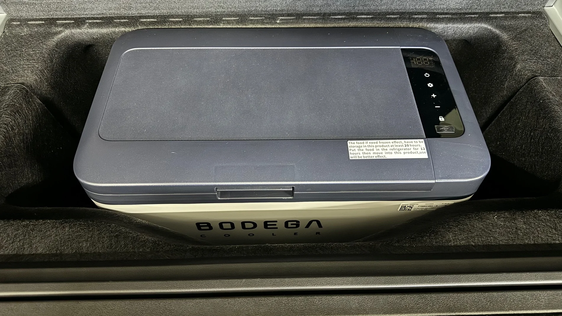

The smaller 27qt Bodega (13x24x14.1) fits just right on my Gen1 R1S sub-trunk with and u might be able to squeeze in that 38qt model (14.1x28.4x14.4).
https://a.co/d/3gcRbuI (Bodega 27qt Amazon)
Rivian R1T R1S R1S Sub-Trunk - What's Under the Covers? IMG_0281

Thanks for the post and especially for the photo. I really want dual-zone functionality and that only starts with the 38qt. It's that additional 1.1" of depth and the little "bump-outs" at the rear of the sub-trunk that seem to be incompatible. Before I purchase the 38qt I'll remove the tie-down sliders and see what's under the sub-trunk liner. I promise to post photos!

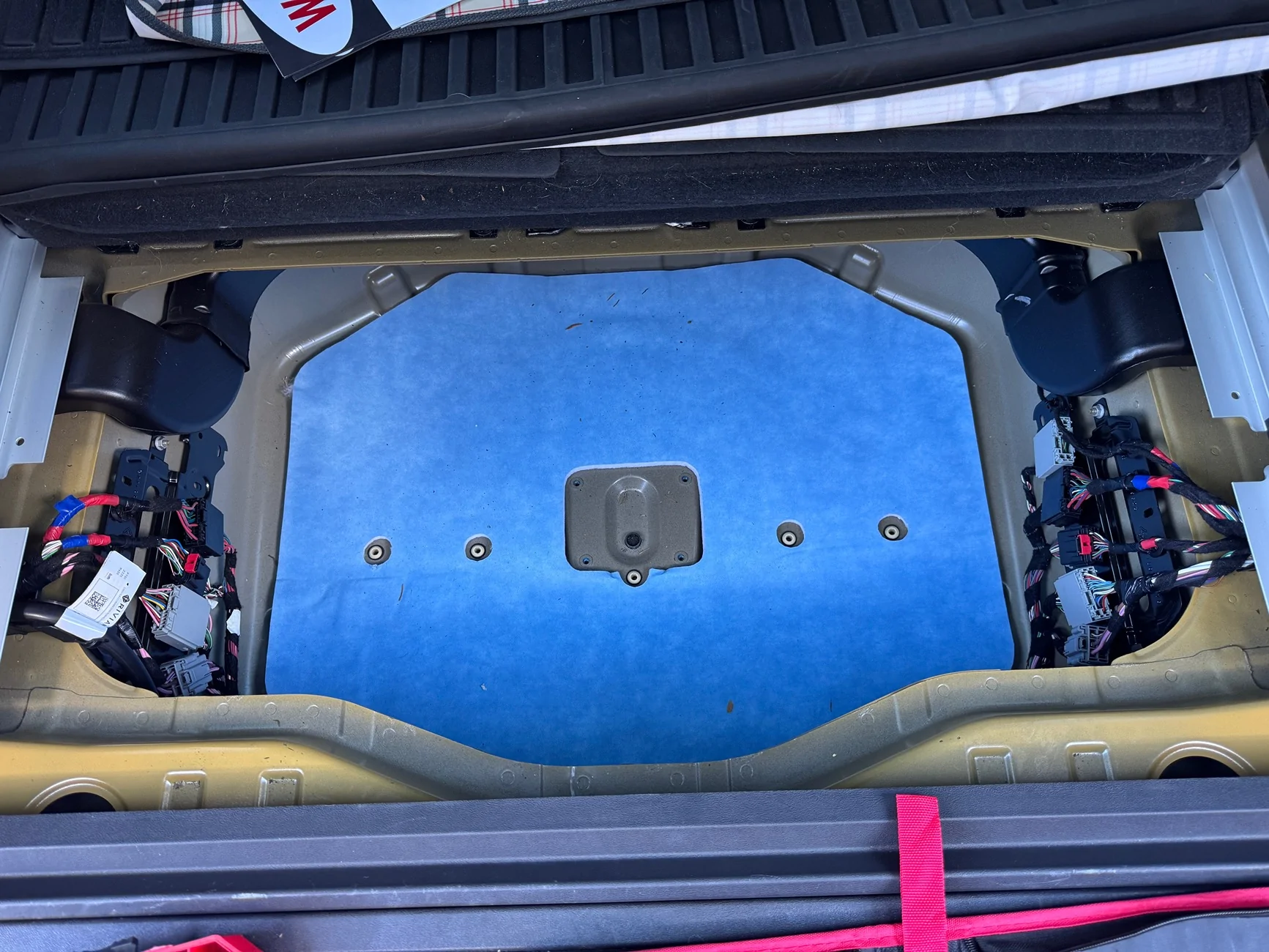

There’s a bit of a metal lip, but it doesn’t take up the full space of that ledge. Be careful hammering.
Rivian R1T R1S R1S Sub-Trunk - What's Under the Covers? IMG_7426

I’d be really careful and make sure you do some sort of weather/waterproofing of this space just in case the compressor leaks or builds condensation/etc. looks like a lot of harnesses could get messed up if a little water gets in the wrong place. Though I’d ask someone more knowledgeable than me on what those bundles are and how they are connected to weigh in on the level of risk. I’ve heard a story either here or on Reddit of a spilled drink in the trunk causing a significant repair bill not covered under warranty.
