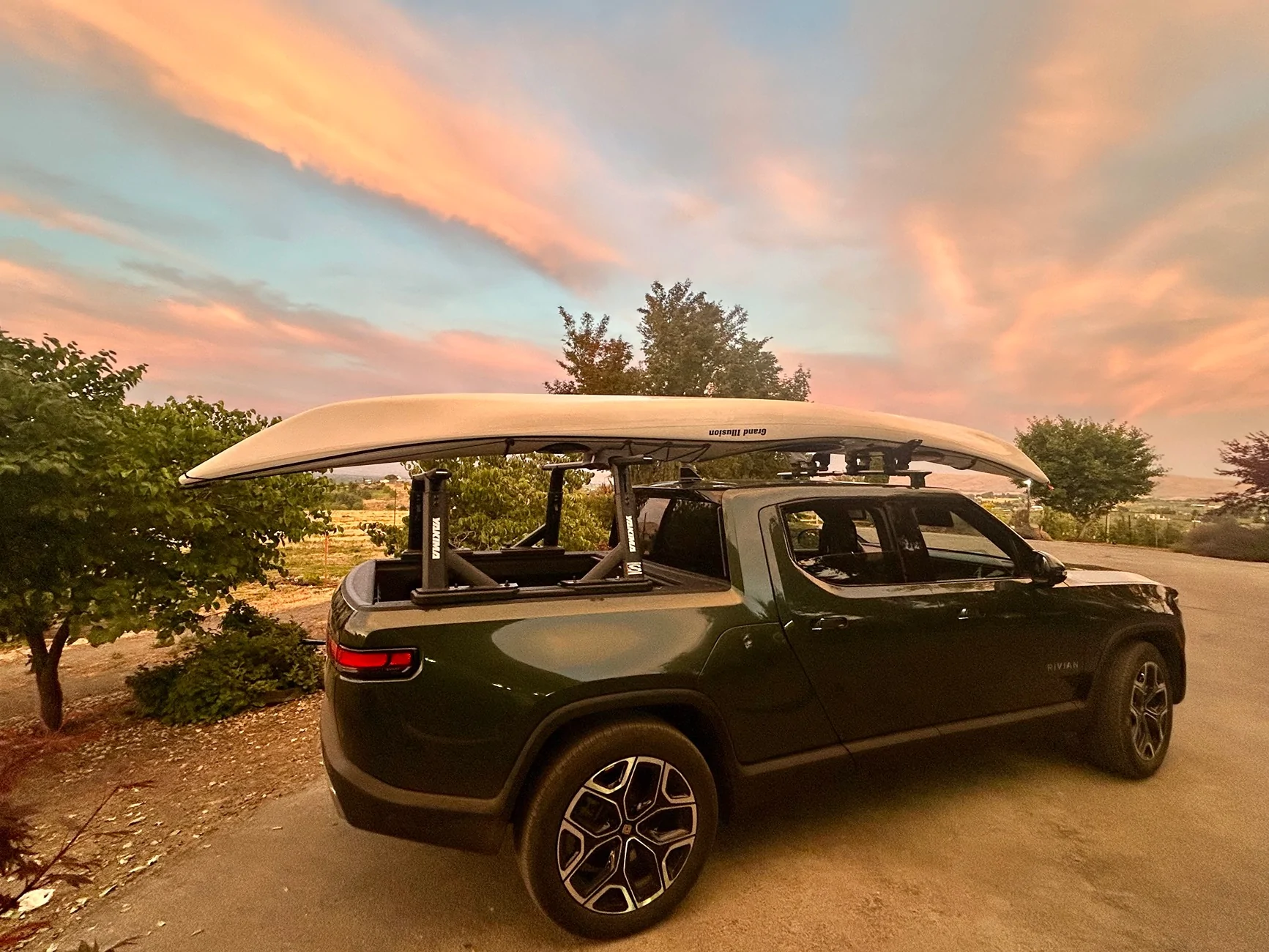

Hello all,
I've started the process of shopping for bed racks capable of supporting a future collapsible hardshell tent and have noticed most of fhe aftermarket bed racks have a weight capacity of around 160-200 lbs.
Do I need a specific bed rack to be able to carry the weight of 2 adults and the tent system itself?
My solution has been complex, but should support 1000# static and has easily handled two 18 ft sea kayaks at 70 MPH.
