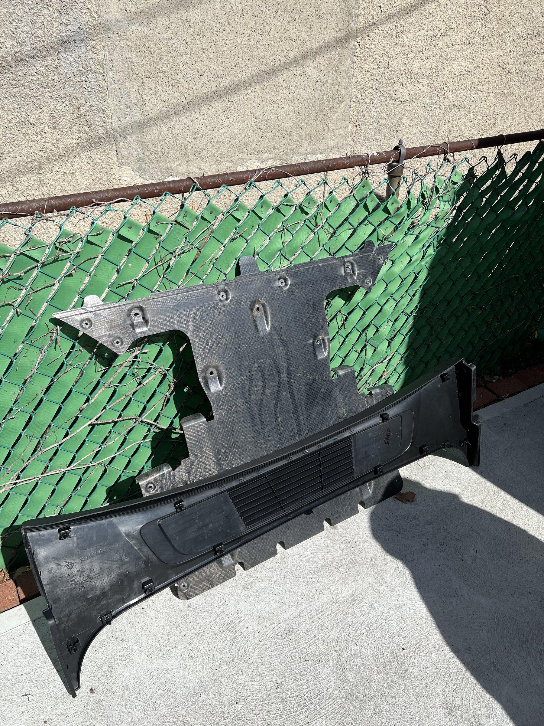

The underbody armor looked like it was all carbon fiber to me, which is how it was described in the past—as a sandwich of carbon fiber and other materials.
In fact, this is the first time I've seen obvious carbon fiber, rather than something that looked like a simple plastic shield.
here I can make it more obvious lol
