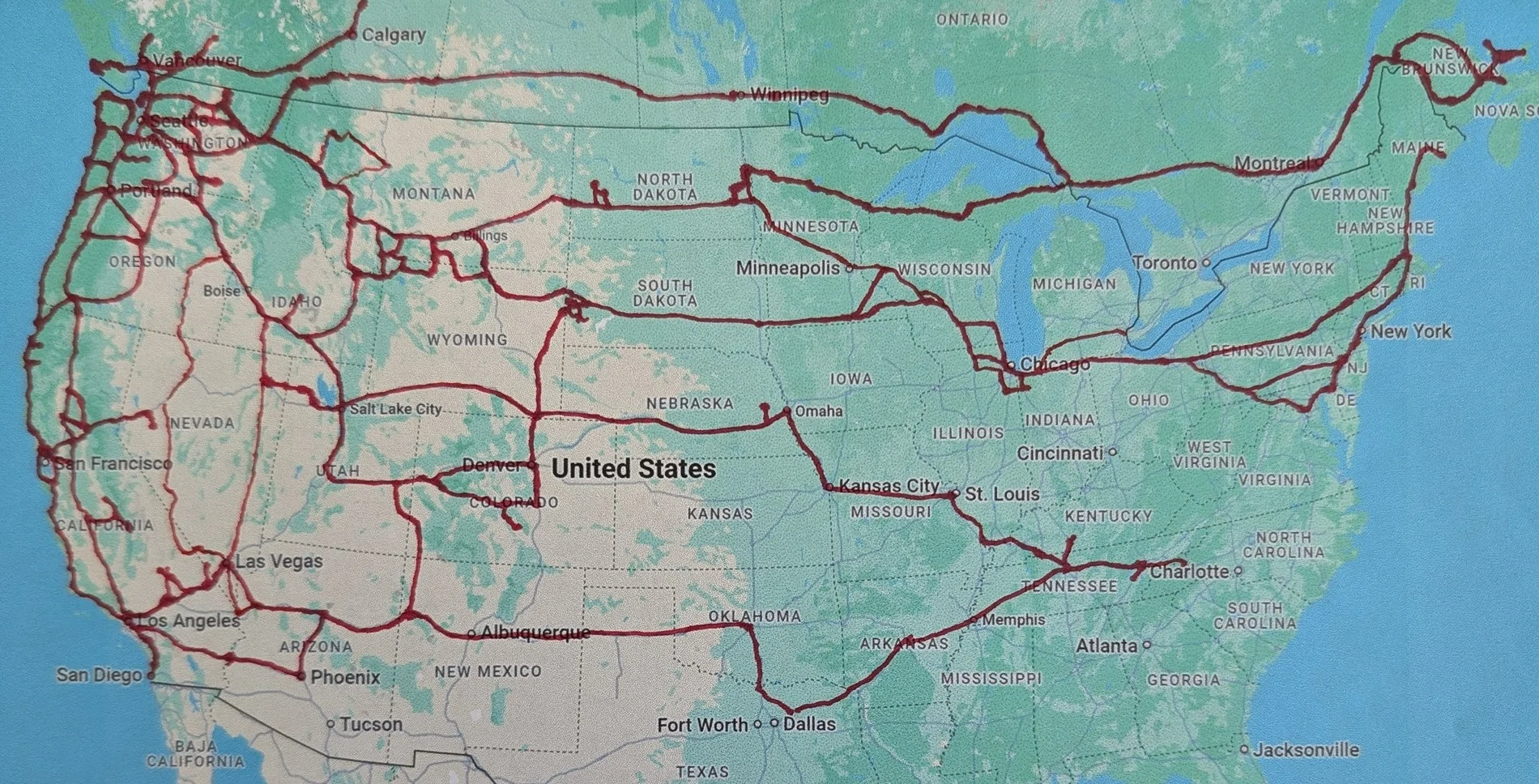

R1S (LG, FE, 20"), Tesla Model X
Just piling on...
My only concern (for OP) is the same as BigSkies': the distance to the service department. If OP can live with that, and OP is otherwise fine with one car, so I don't see why it can't be an EV.
While we have two cars, they have both been EVs since 2009 - not only do we not have any regrets, we far prefer it this way. And it's not like we don't like to travel, here's where we have been in our EVs:
