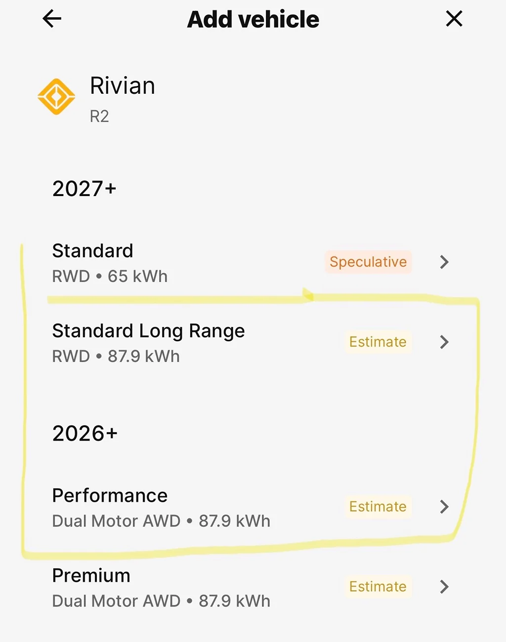

ABRP now has Rivian R2 specs loaded, and the implied highway ranges are interesting:

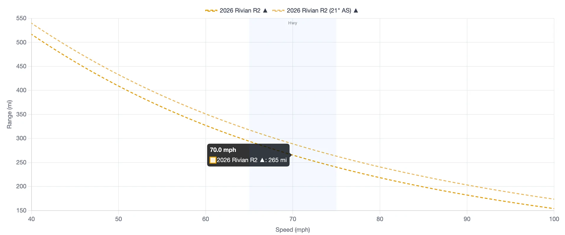

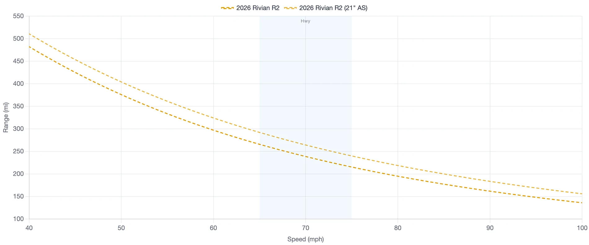

Tracks the EPA dynomometer coefficients pretty well, though falling more aggressively with speed, which makes sense given the shape and the lack of the EPA data to account for anything over ~75mph.
21” R2
65 mph: ~300 miles vs 292mi
70 mph: ~255 miles vs 264mi
75 mph: ~225 miles vs 240mi
20” R2
65 mph: ~270 miles vs 266mi
70 mph: ~225 miles vs 239mi
75 mph: ~205 miles vs 215mi
My calculator - EVBench EPA Data
Rivian R1T R1S R2 range based on ABRP (implied highway ranges) 1783452612750-wc
Note - if I plug in 5500ft elevation, we get a perfect match (265mi) for the State of Charge range test of 260mi with 4mi in reserve on the 20" wheels

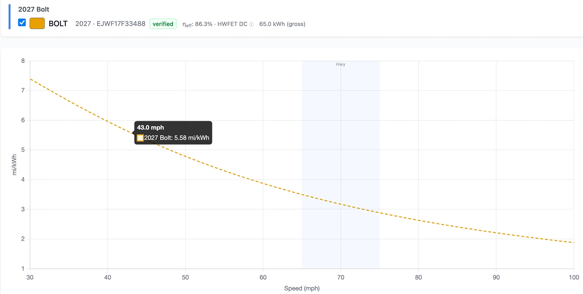

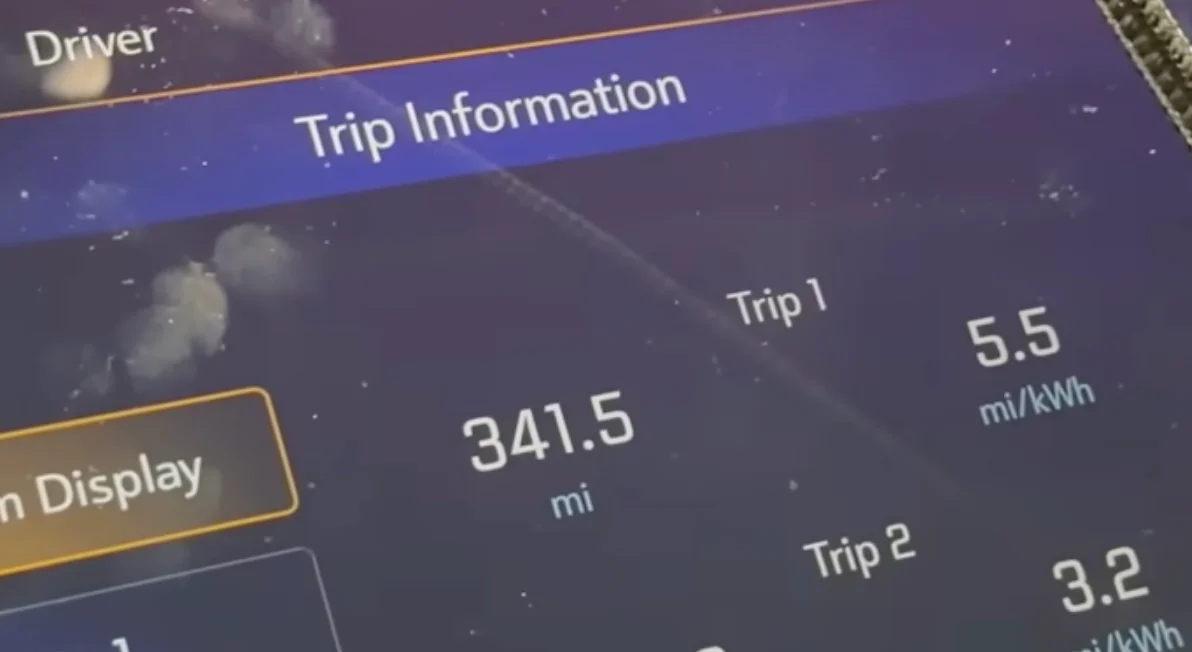

As an example...
On the recent Bolt Ionna trip, they needed to make it 341mi on a single charge in a Chevy Bolt. They averaged about 40-44mph and got 5.5mi/kWh, which matches why my calculator estimates :)
But that's a tough comparison. On one hand they were drafting during a lot of it. On the other hand, they had to fight snow and rain. On the other other hand, they went way up in altitude... Lots of messy variables.
