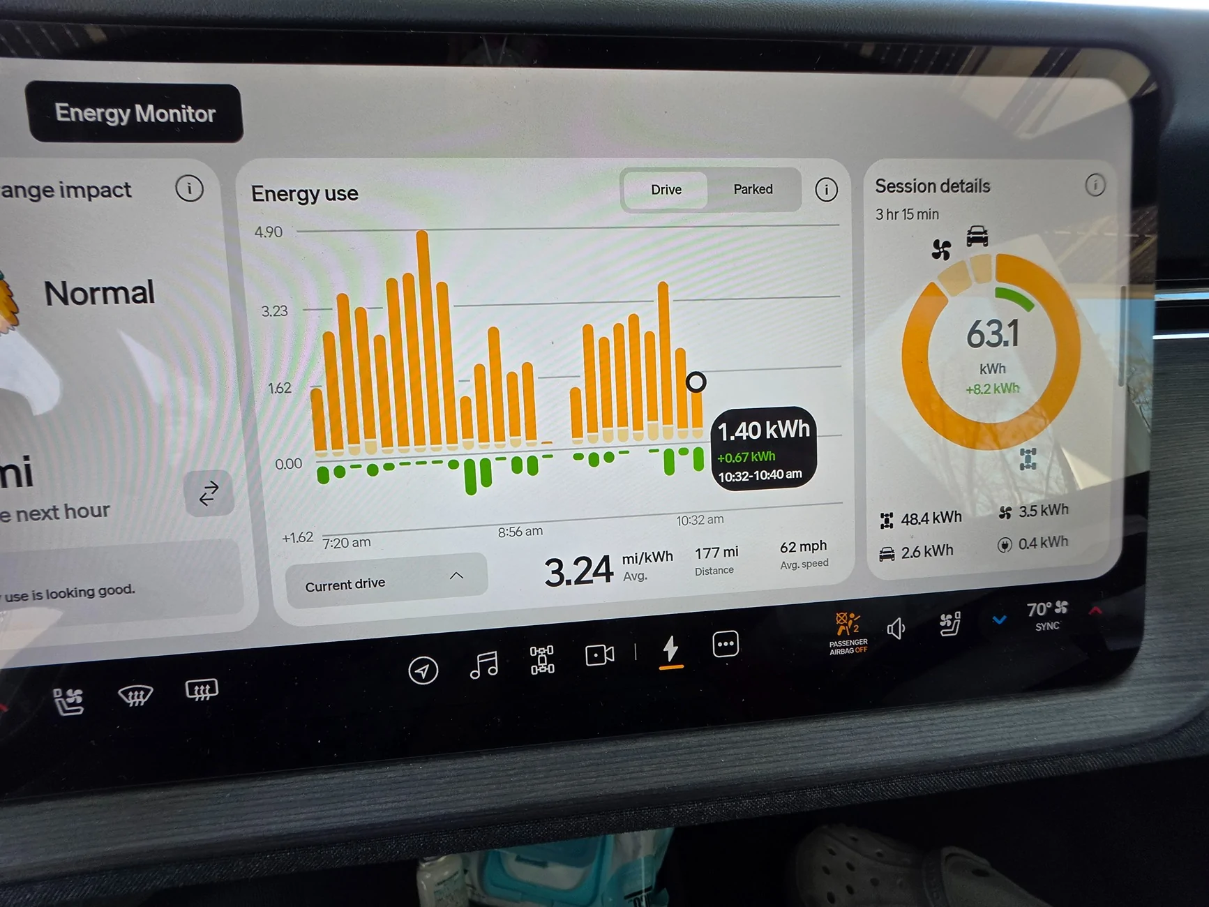

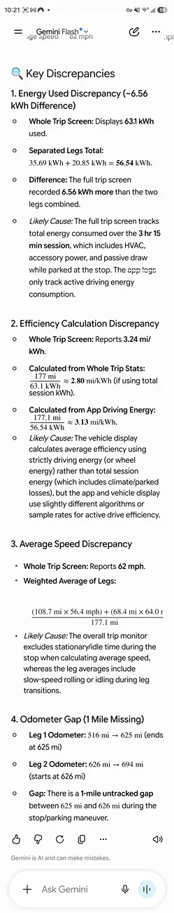

That is just a bit of slop. At one point it says that the app ONLY uses drive energy to compute kw usage (not sure how it would get just that data anyway). And then later it says the in dash display only uses drive energy. ??? So sadly not an answer. Hmmm

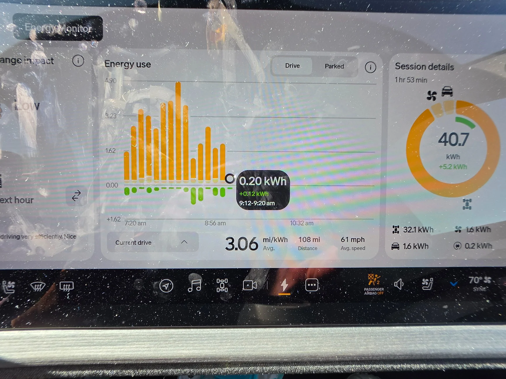

Does Rivian Roamer only use drive energy? I won’t be able to test this until I get an R2, but if anyone wants to post session details and RR data from the same drive, that will help us figure things out!

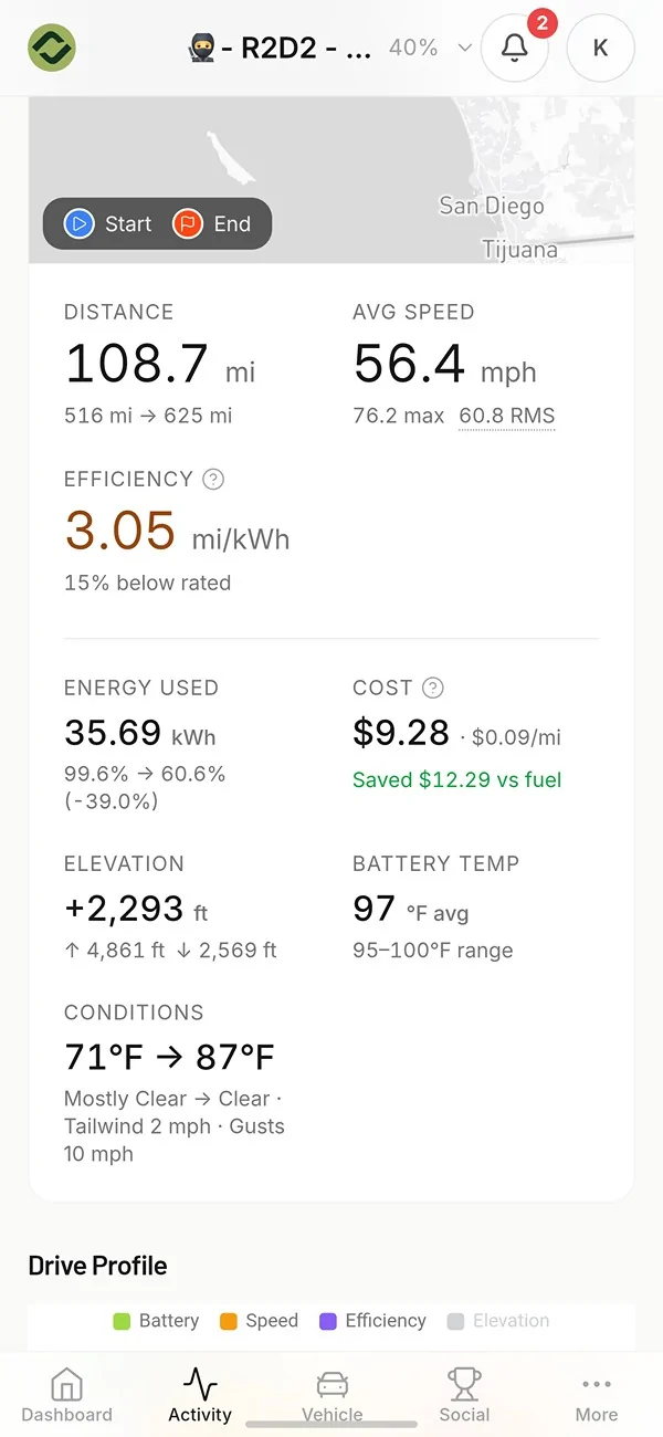

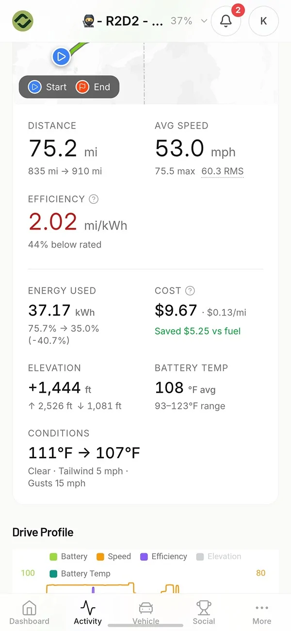

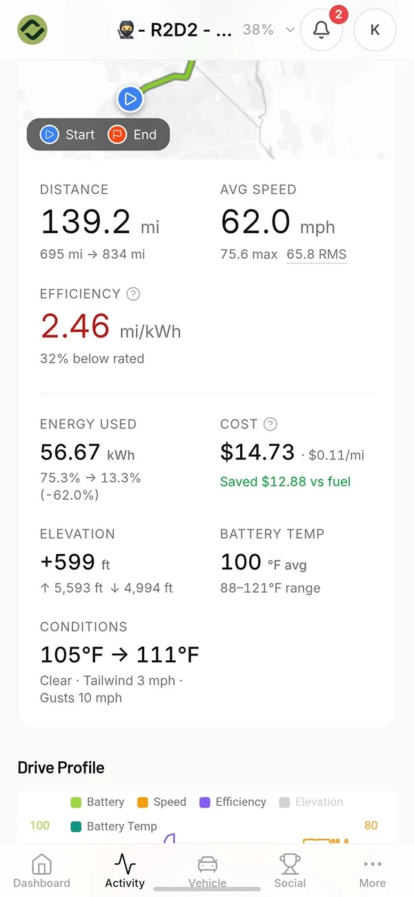

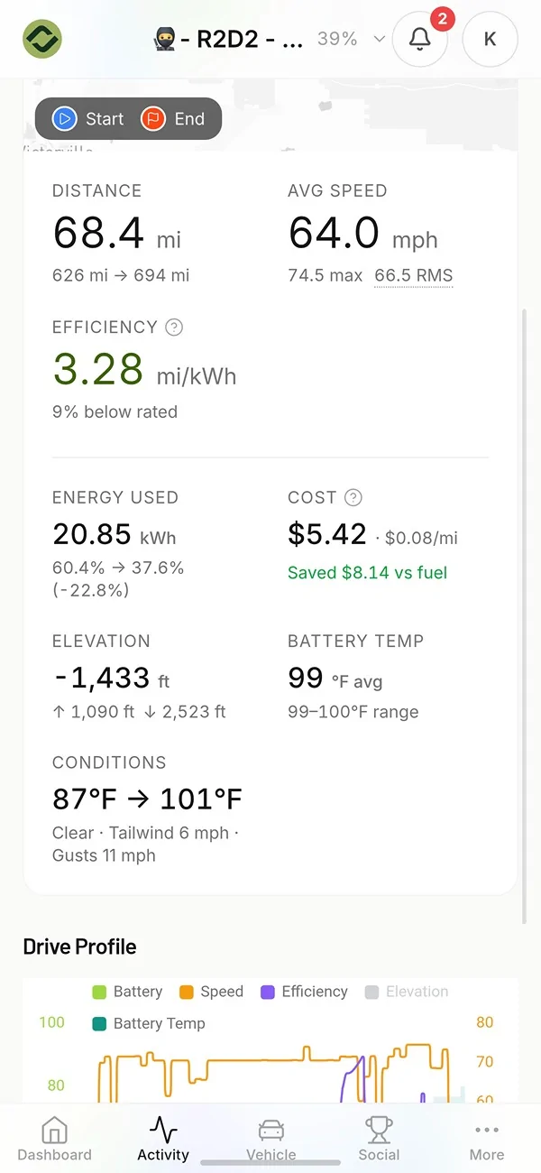

From Rivian Roamer's FAQ
Why does my efficiency on Rivian Roamer not match my in-vehicle display?
Rivian only exposes battery percentage and net battery capacity through their API — not the actual energy consumed.
This means Rivian Roamer has to calculate energy usage based on the change in battery percentage and reported capacity. Due to rounding and the thermal reservation mentioned above, these calculated values may not always match what your vehicle displays.

Rivian Roamer is only able to use what's exposed via the app (and a few extra things). All I have access to is SOC and battery capacity. This means there is a decent standard deviation in efficiency accuracy. It's wider for shorter drives but gets more accurate the longer the drive is.
This is a limitation on source data. Though I may have found a sneaky way to make it much, much more accurate.
