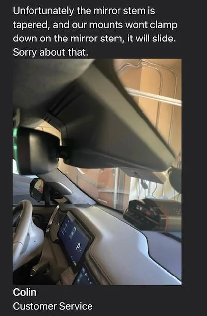

I checked with blendmount to see if they were working on a Rivian specific mount for a V1.
Booo. Hopefully someone figures something out. I have zero desire to rely on a sticky cup.

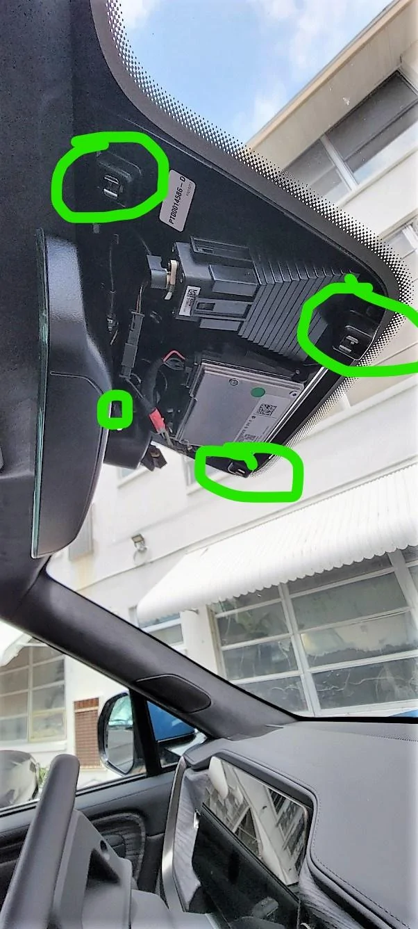

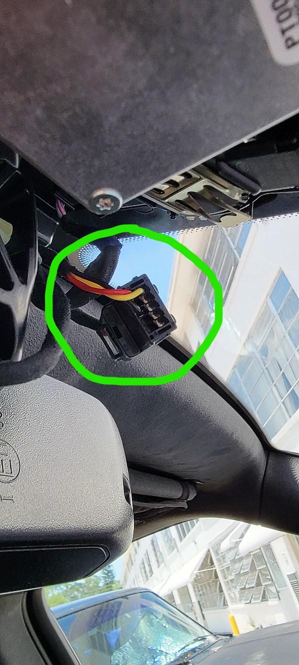

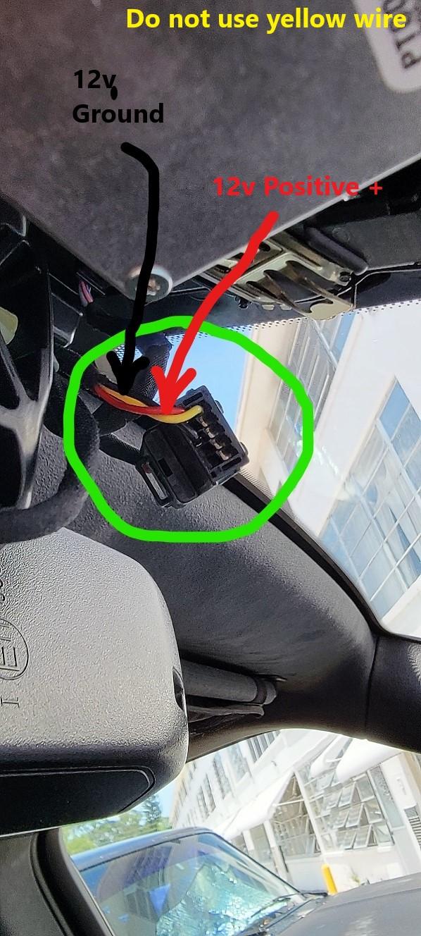

It's fairly easy to run wire to the 12v socket in the center of the dash, just pushing the wire into the edge of the headliner and A-pillar, and then pulling off the under-wheel knee plastic. I did so for my dashcam and will do another for RD soon. It's worth a little extra effort to run accessories off the circuit the car expects unknown loads to be on.

I ran it to the 12v under the dash. I didn't want to overload the circuit for the mirror, Plus the techs at Rivian said they are working on a dash cam app for an over the air update in the future.
Are you sure the 12v under the dash is ignition on I ran a 12v cigarette plug with a led on it and it remained on even when the car is locked.
whereismyr1t
Randy
Mar 12, 2022
56
91
Oklahoma City
Network Engineer
Yes it does shut off, just not when you lock it. You have to wait for the truck to go to sleep, then it will shut down.
rivian_panda
Apr 4, 2022
51
Bay Area
Genius, Millionaire, Playboy, Philanthropist
So your camera stays on until it goes to sleep? Is there any battery drain from doing that ?
whereismyr1t
Randy
Mar 12, 2022
56
91
Oklahoma City
Network Engineer
My radar detector stays on until the truck goes to sleep which is within a minute or so of walking away.

Hmm r u sure the 12v is running off the 135kw battery and not the regular standard car battery… to power accessories.
You said your Tesla this is a Rivian have you test how long before it goes to sleep or if it does sl
I have!!
See attached photos

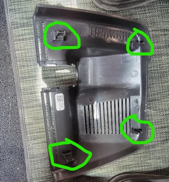

Stupid question. how do you pull off the plastic cover? I tried its really on there. Do I have to really pull and pry tool it?
