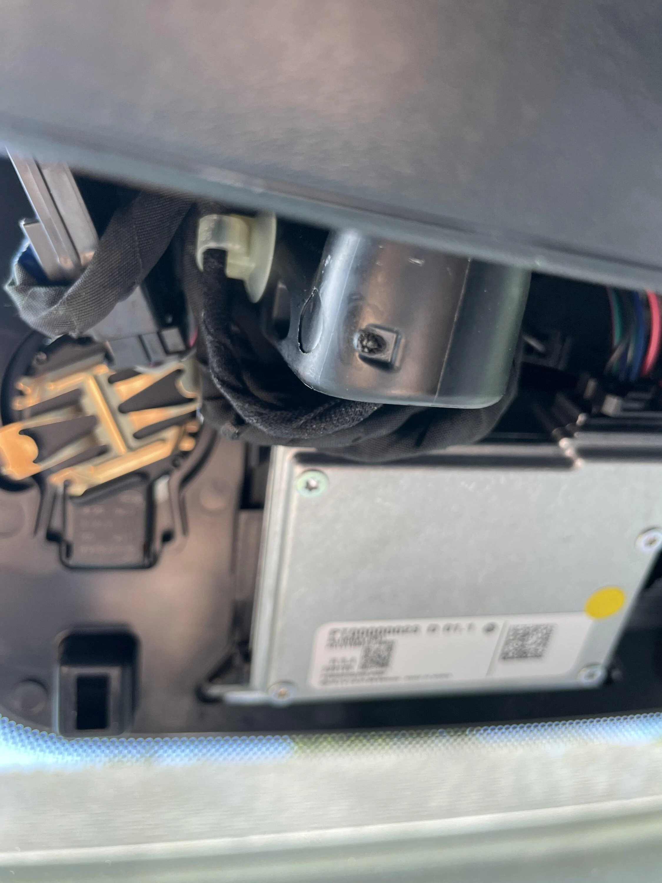

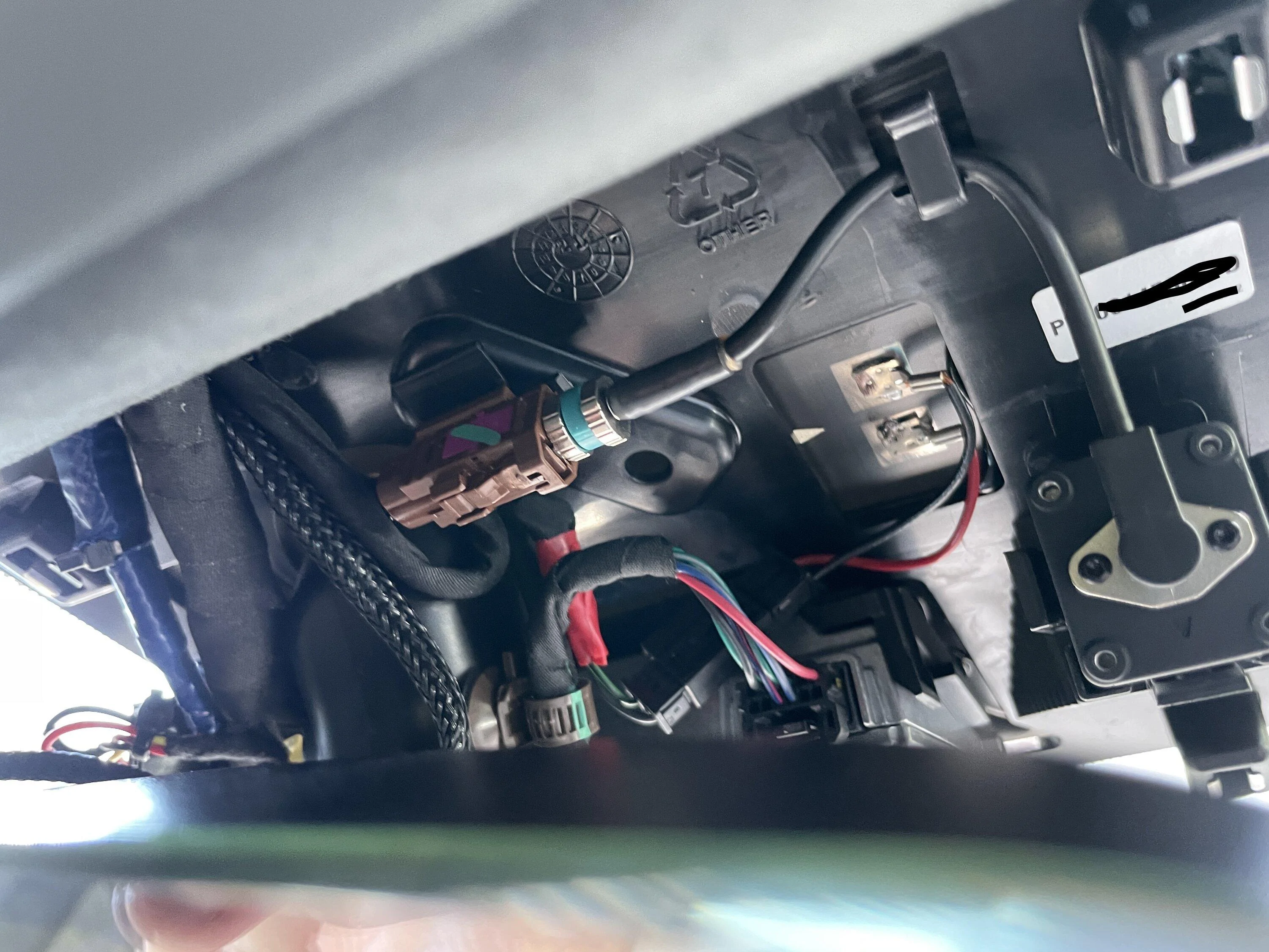

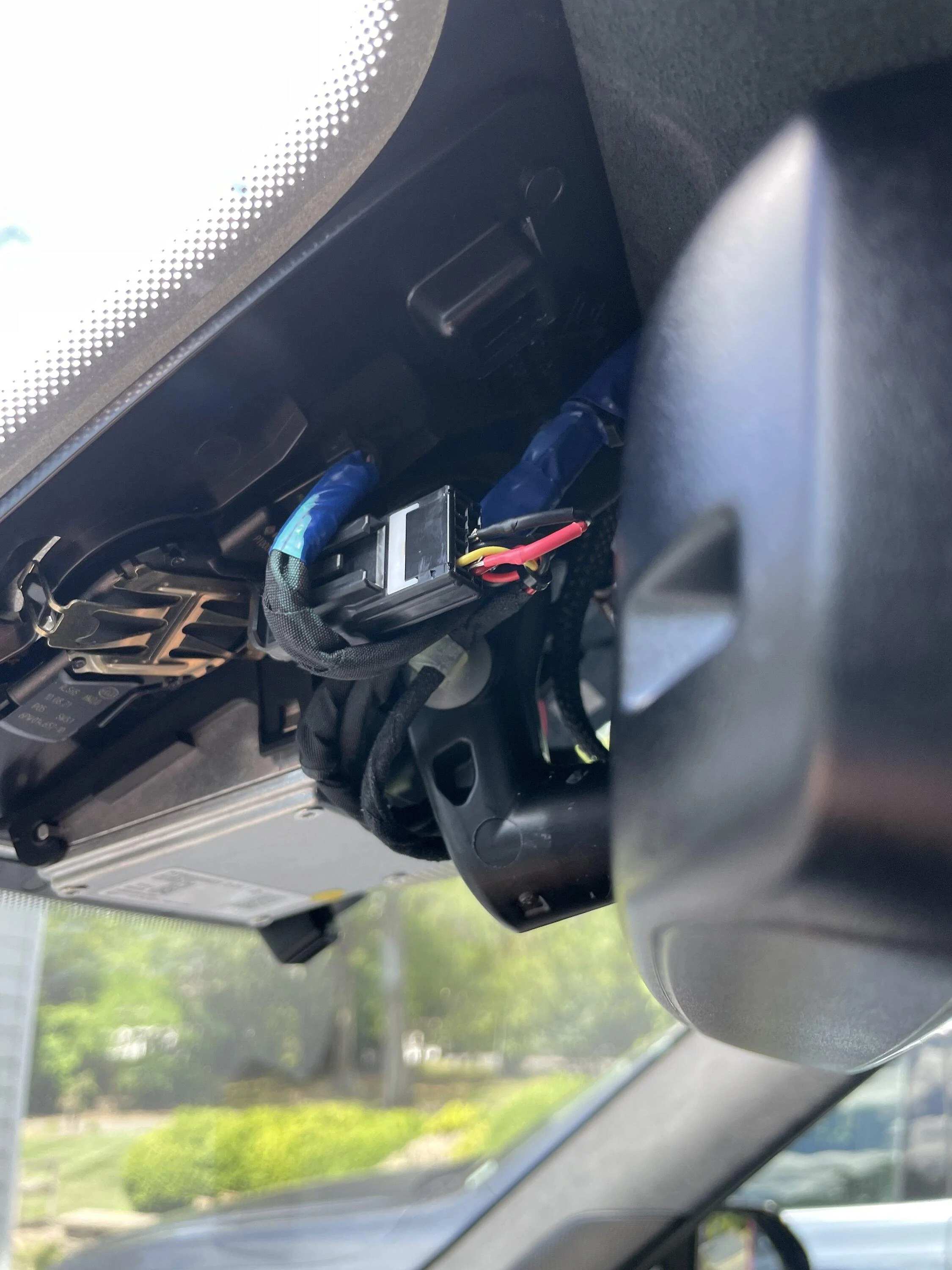

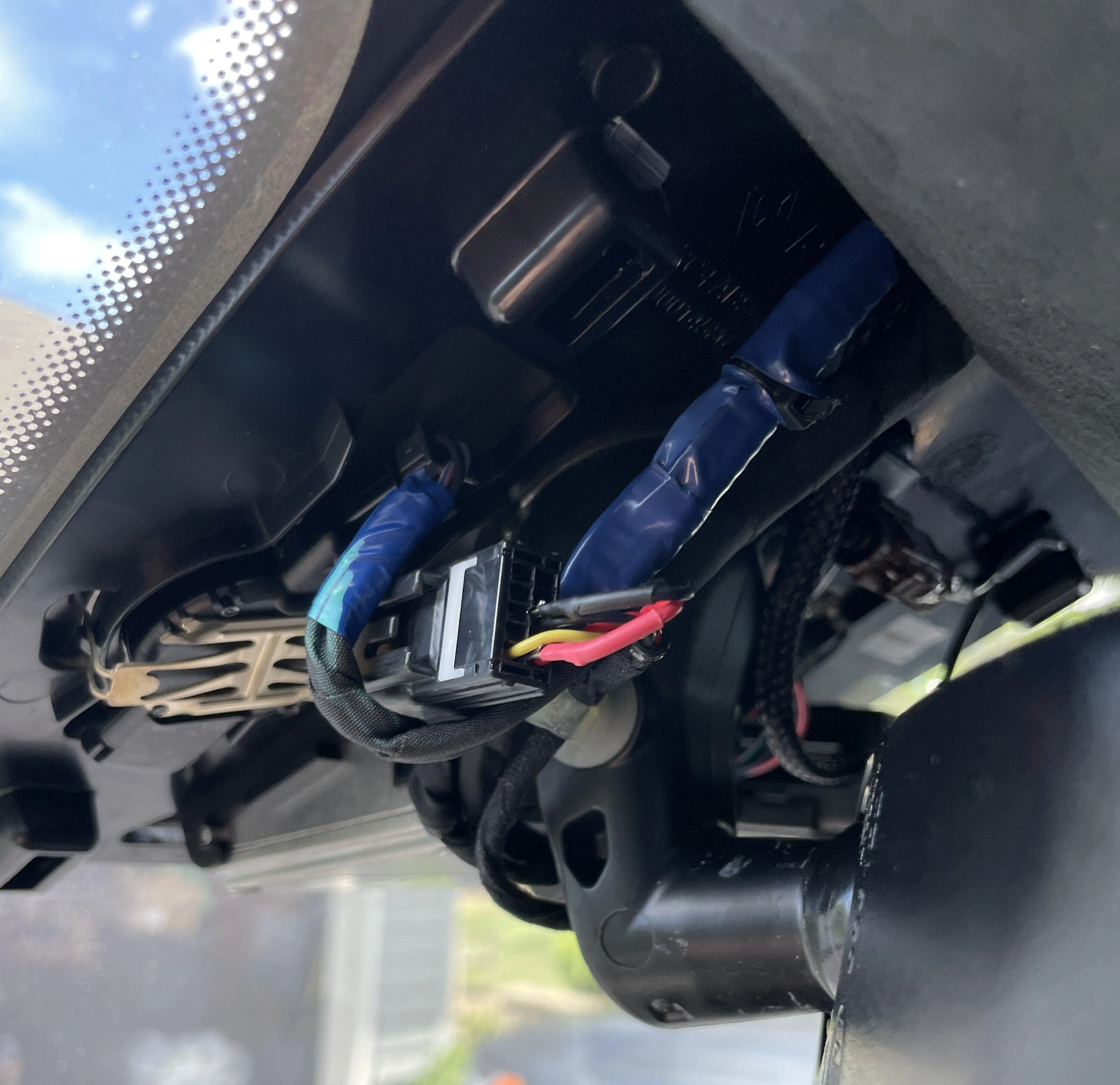

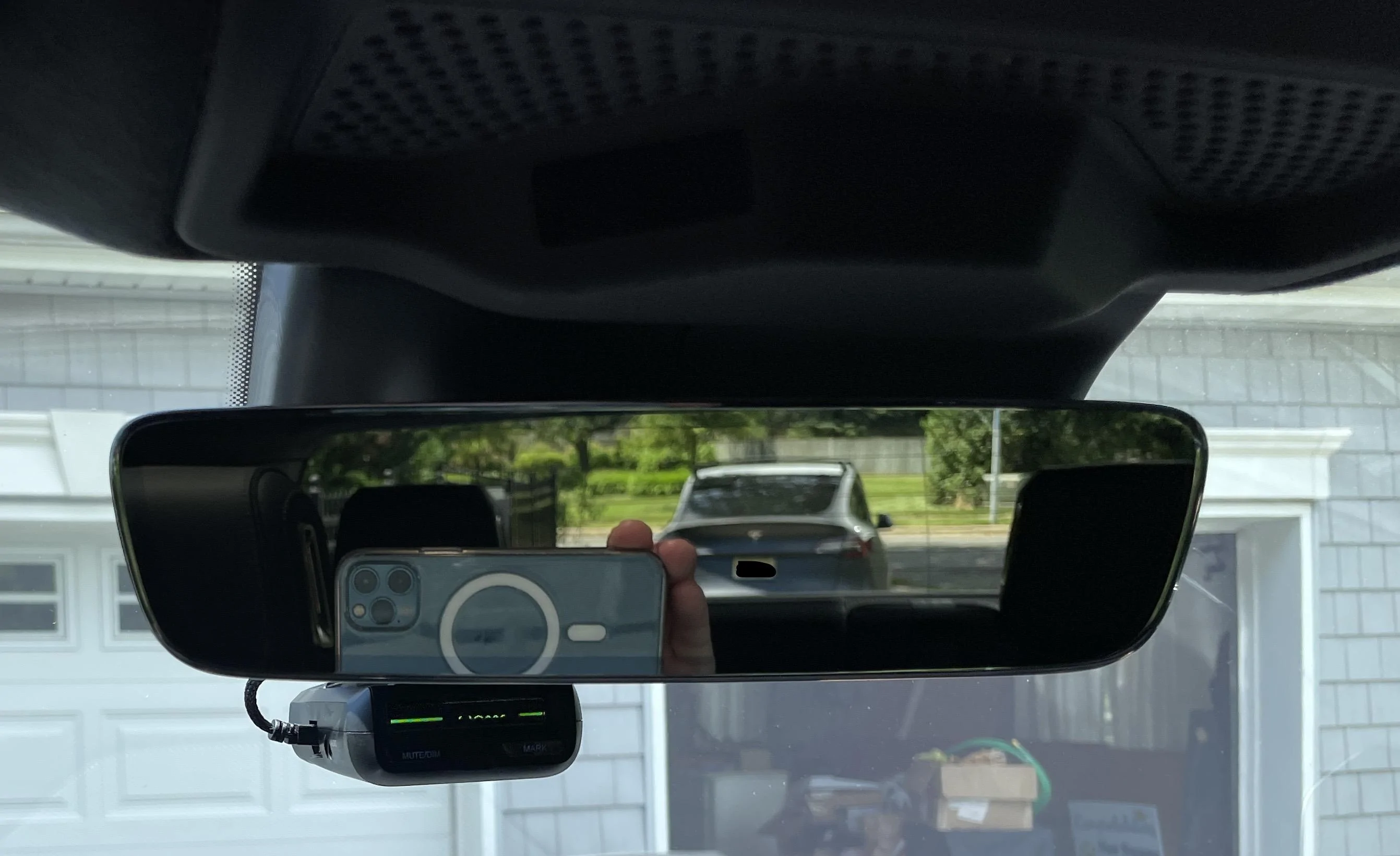

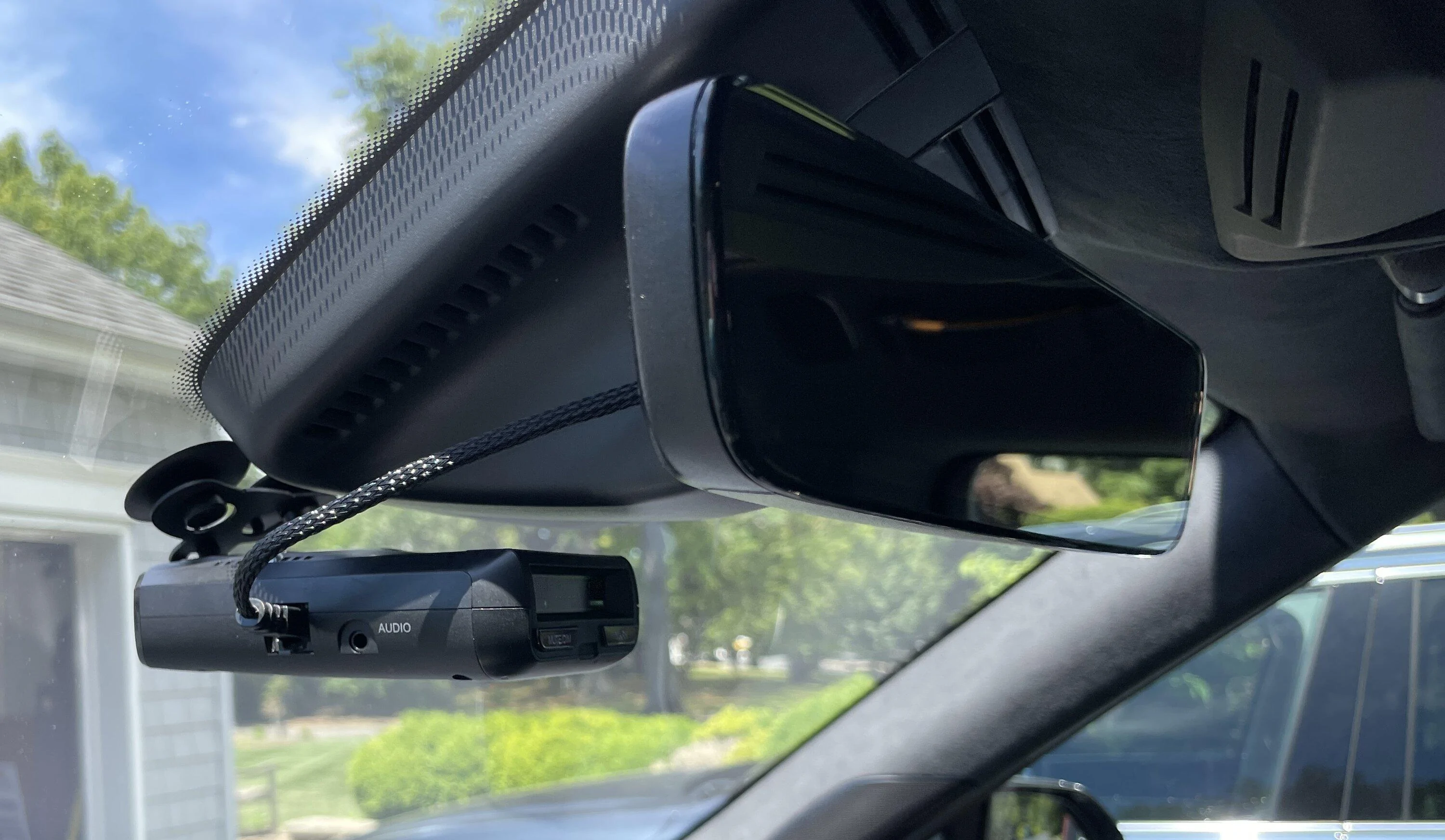

I included some more photos of the wiring under the cover. A few suggestions that may help the next person:
1) The cover is difficult to pop out, even with a plastic pry bar but what worked for me was doing each corner a bit, then moving to the next one.
2) the cover is actually in two parts, the main cover and then a smaller section that comes off to allow the cover to go over the mirror arm and then goes back on behind the mirror. This is hard to get off by itself but it came loose as I was prying off the main cover so I would suggest just doing that.
3) the wiring kit I have for a Uniden R3 had two sizes of pins and I used the smallest ones and they worked just fine. This is the kit I used: Uniden wiring kit
4) I ran the wire out along the top of the mirror arm. I removed a little bit of the material from the bottom of the small cover part where it covers the top of the mirror arm to provide enough room for the wire.
5) I removed the metal clips from the main frame so I could try the cover fit without having to wrestle it back out of the clips each time. It's easy to do this, just pinch the two sides of the metal clip together and pull it out. Then you can just fit the cover to make sure nothing is getting pinched or is in the way.
6) There is a large silver metal box that you will see in the photos. I suspect it's either a hard drive or a processing unit of some sort. It gets VERY hot. The cover has an opening /gap where it meets the windshield just in front of that box. I would make sure not to cover that or any of the vents in the cover. That needs as much airflow as possible.
7) I used a small plastic tie to hold the pin wires to the existing wires feeding into that molex power connector, hopefully, this will avoid them working loose over time. I also wrapped the wires and spare pins with blue electrical tape, again to minimize movement and also to dampen and noise from vibration.
8) I tested the unit before reattaching the cover and it worked the first time. Then I replaced the metal clips, attached the main cover, and tested fit and location of the radar unit to ensure it wouldn't block mirror movement, sun visor movement, or too much of the driver's view. Once I had it in place, then I replaced the small cover over the mirror, and the job was done!
Take your time and this is an easy job.
