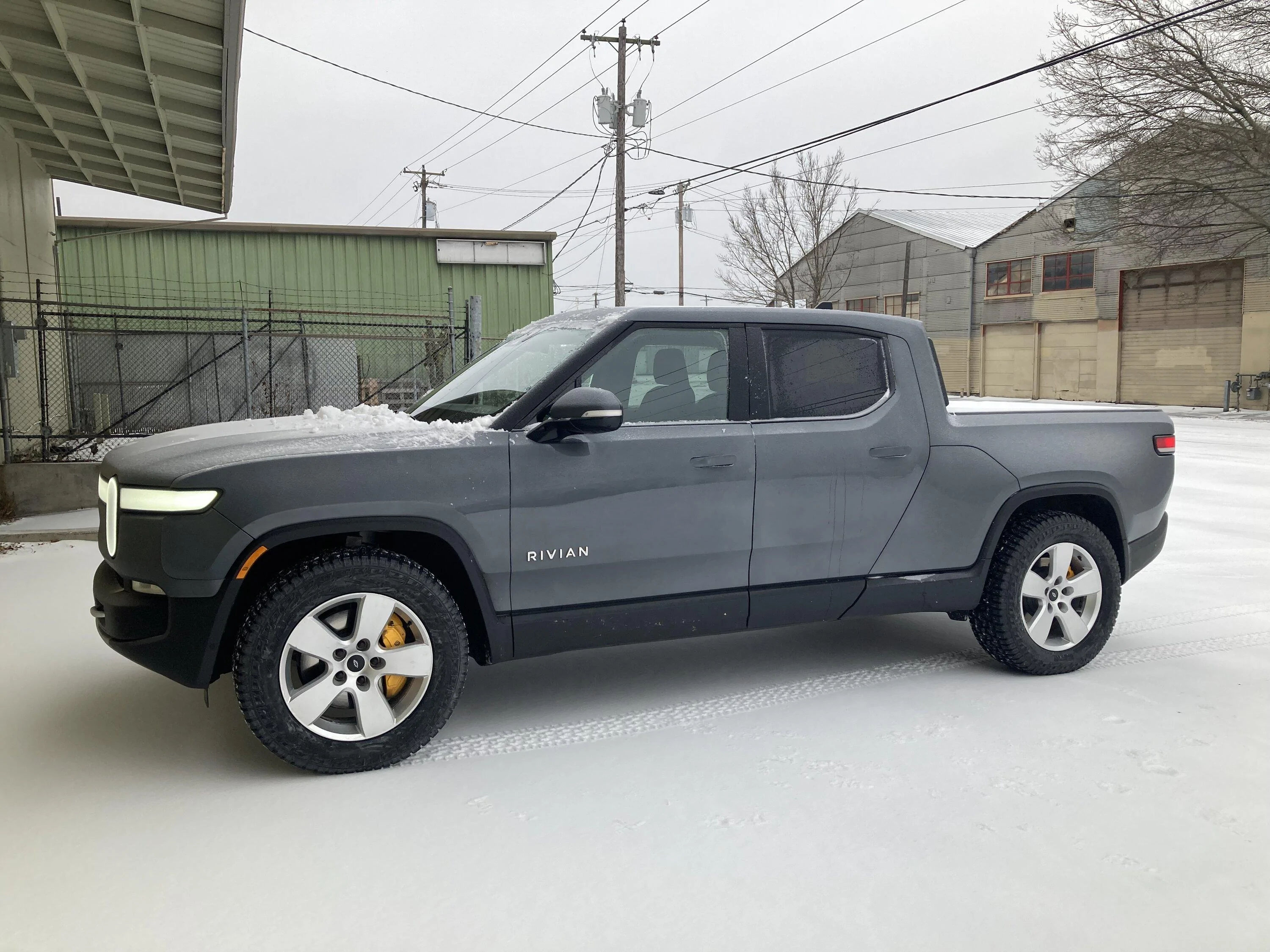

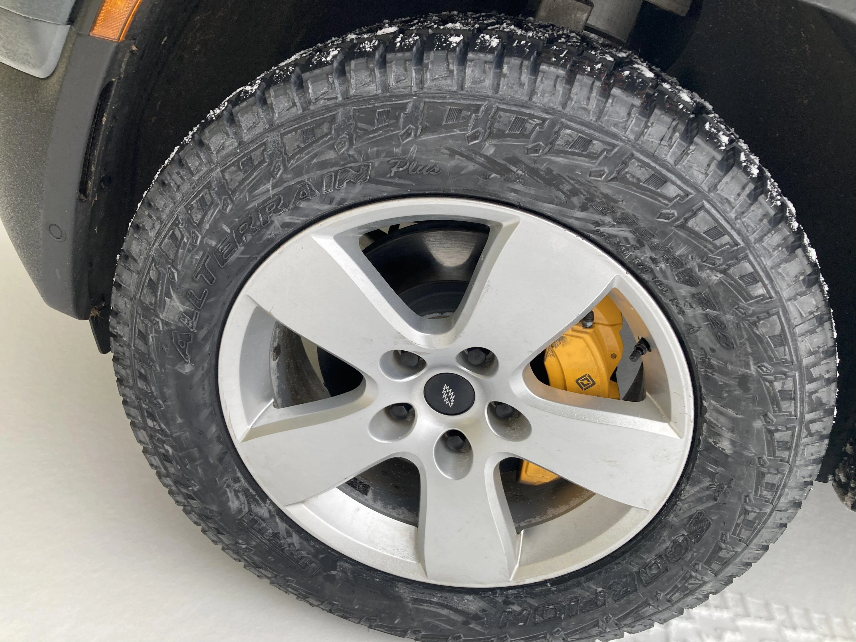

Not too bad for new wheels. For reference I have about $2100 in my set of 5 with Nokian Outpost tires. That is including center caps, TPMS, hubcentric rings, and Cerakote.

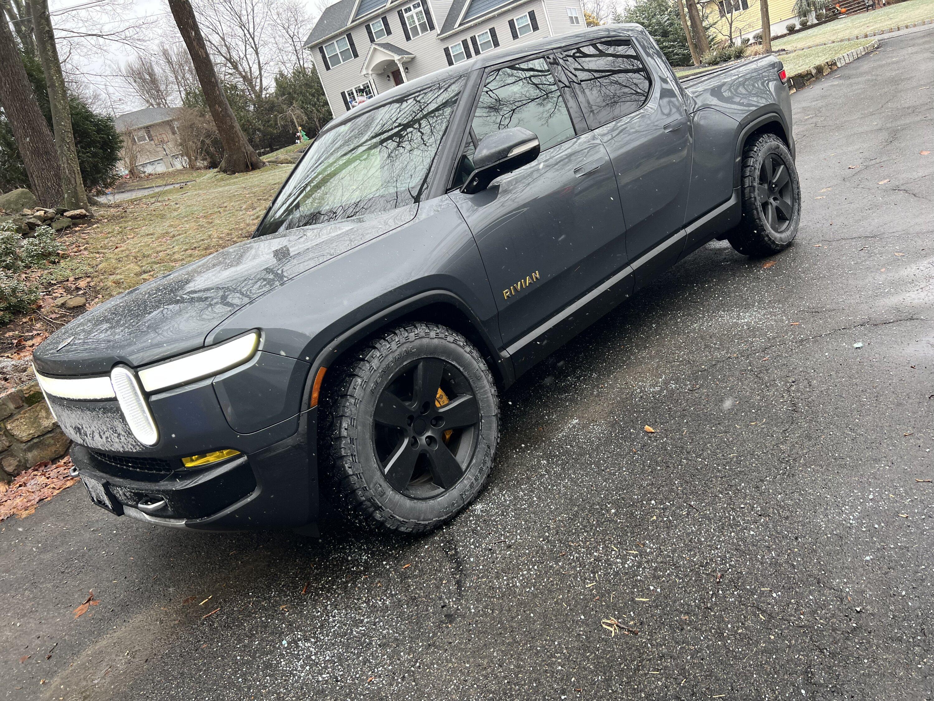

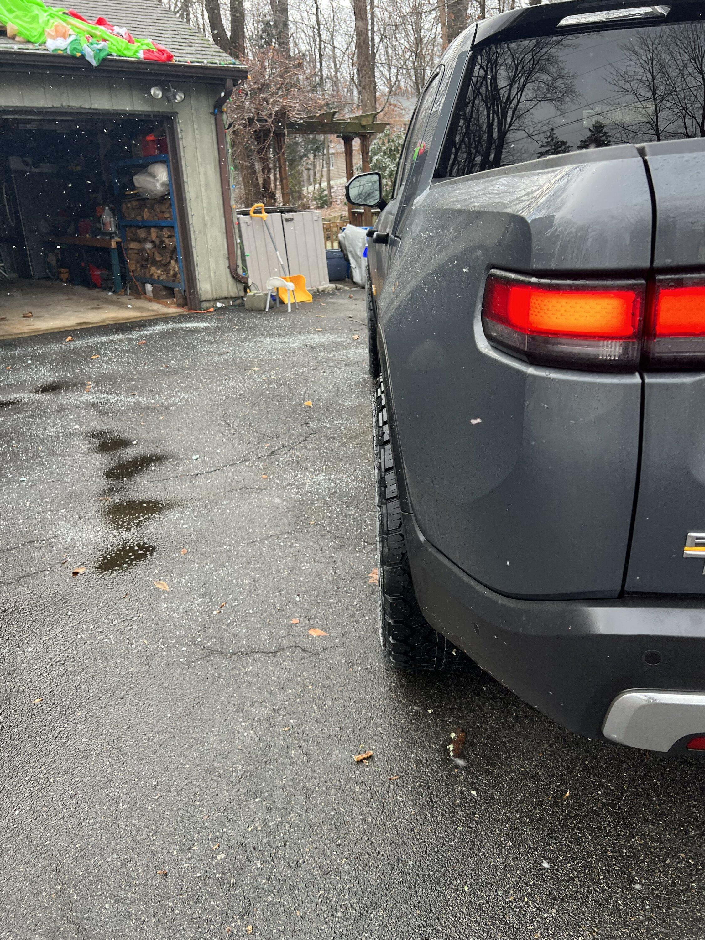

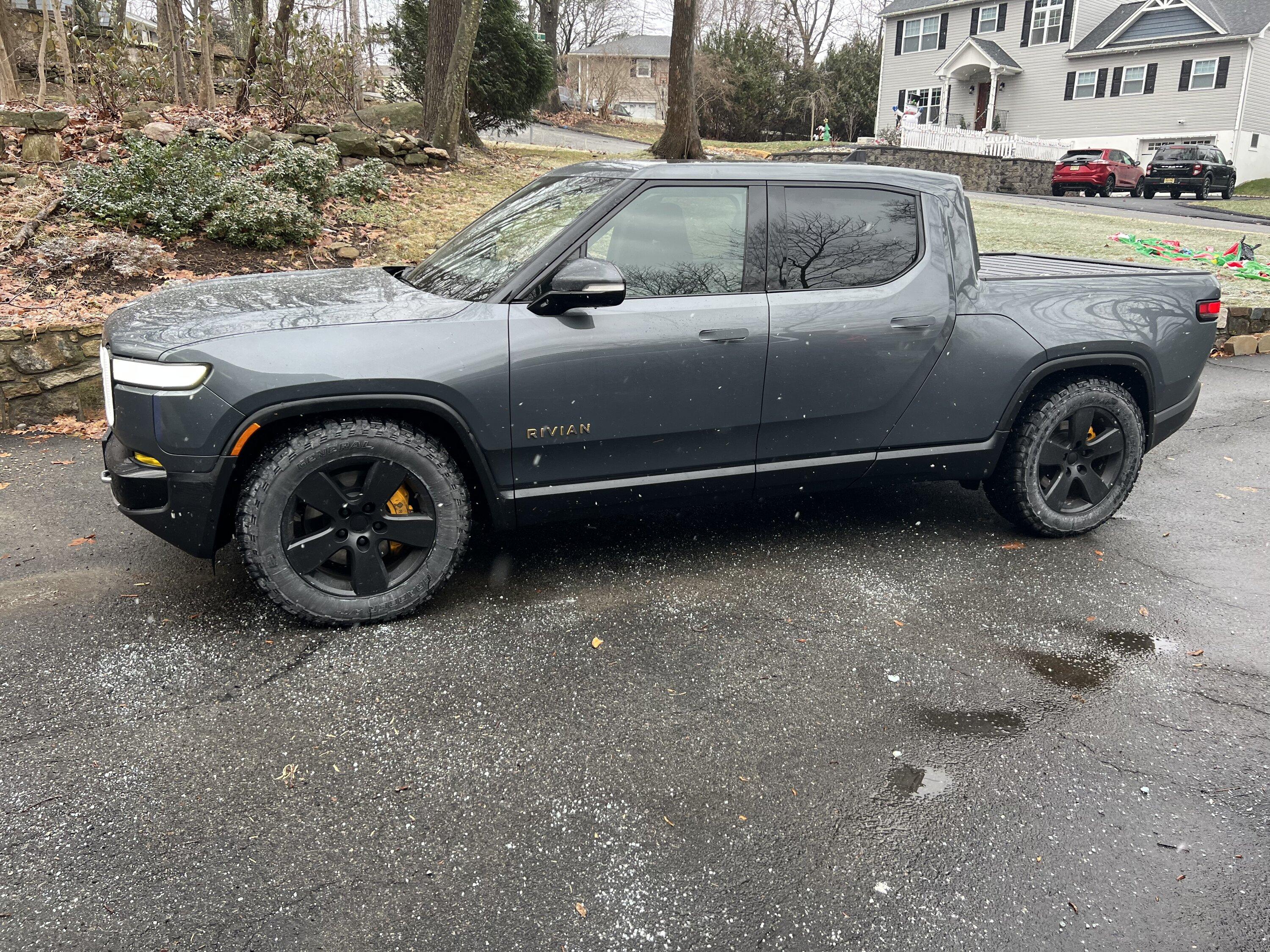

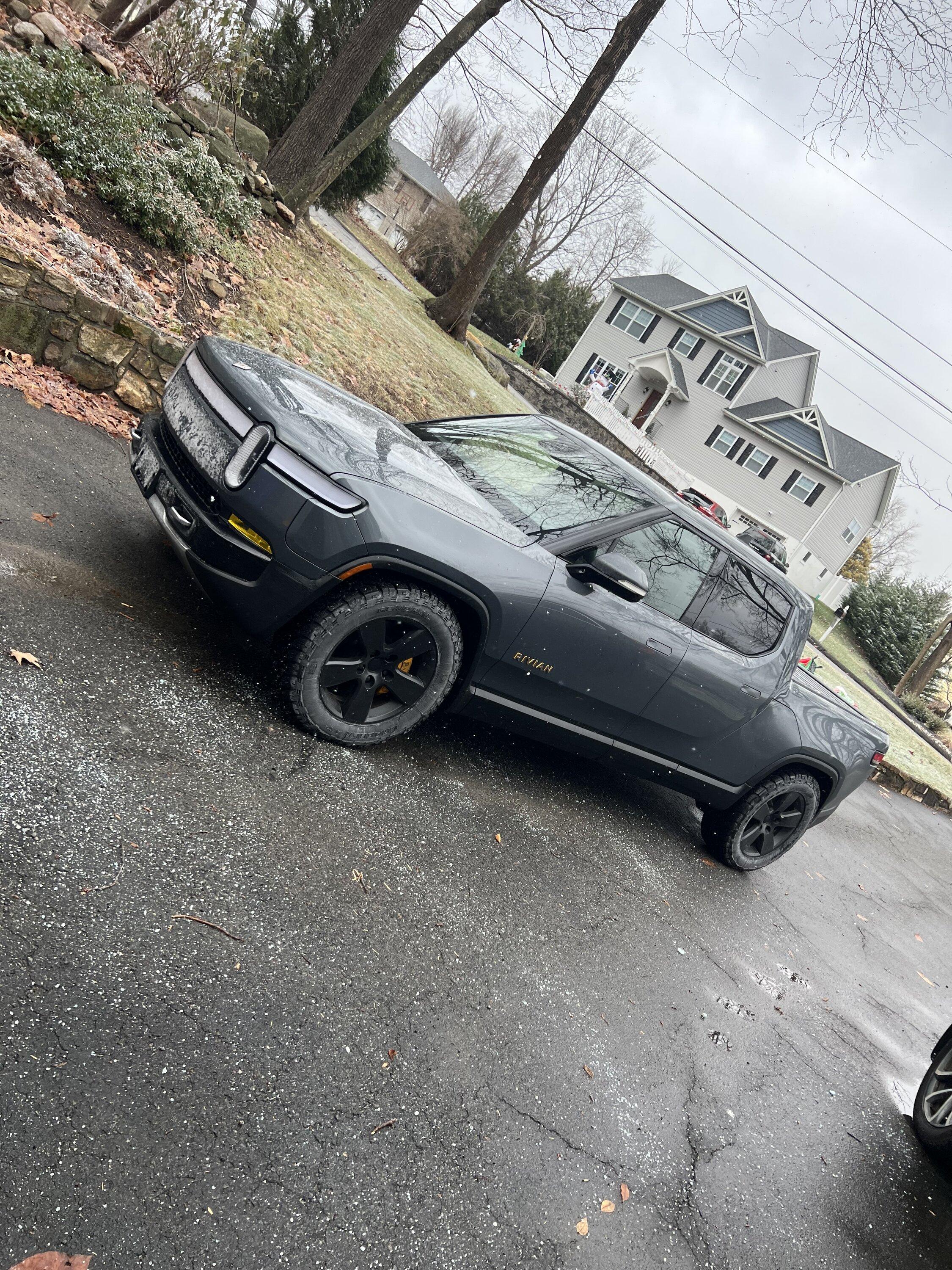

So I ended up going the dodge wheel route, so far so good. Followed a guide by someone on a diff forum, ended up going with a 275/60/20 general grabber ATX. It’s a heavier tire so I’ll see how bad range gets. Fitment is good with zero rubbing, can kneel etc no problems. Road noise isn’t that bad, ride quality is good. This is coming from the 22s. TPMS sensors still a mixed bag, not sure they’re gonna work. They go in and out. Also not sure how to tell the vehicle I don’t want the tires at 48psi.. so I think I’ll be stuck living with the tire warning on.

I had a rub on a pothole in the lowest setting, but regular low is fine, no issues at all.
