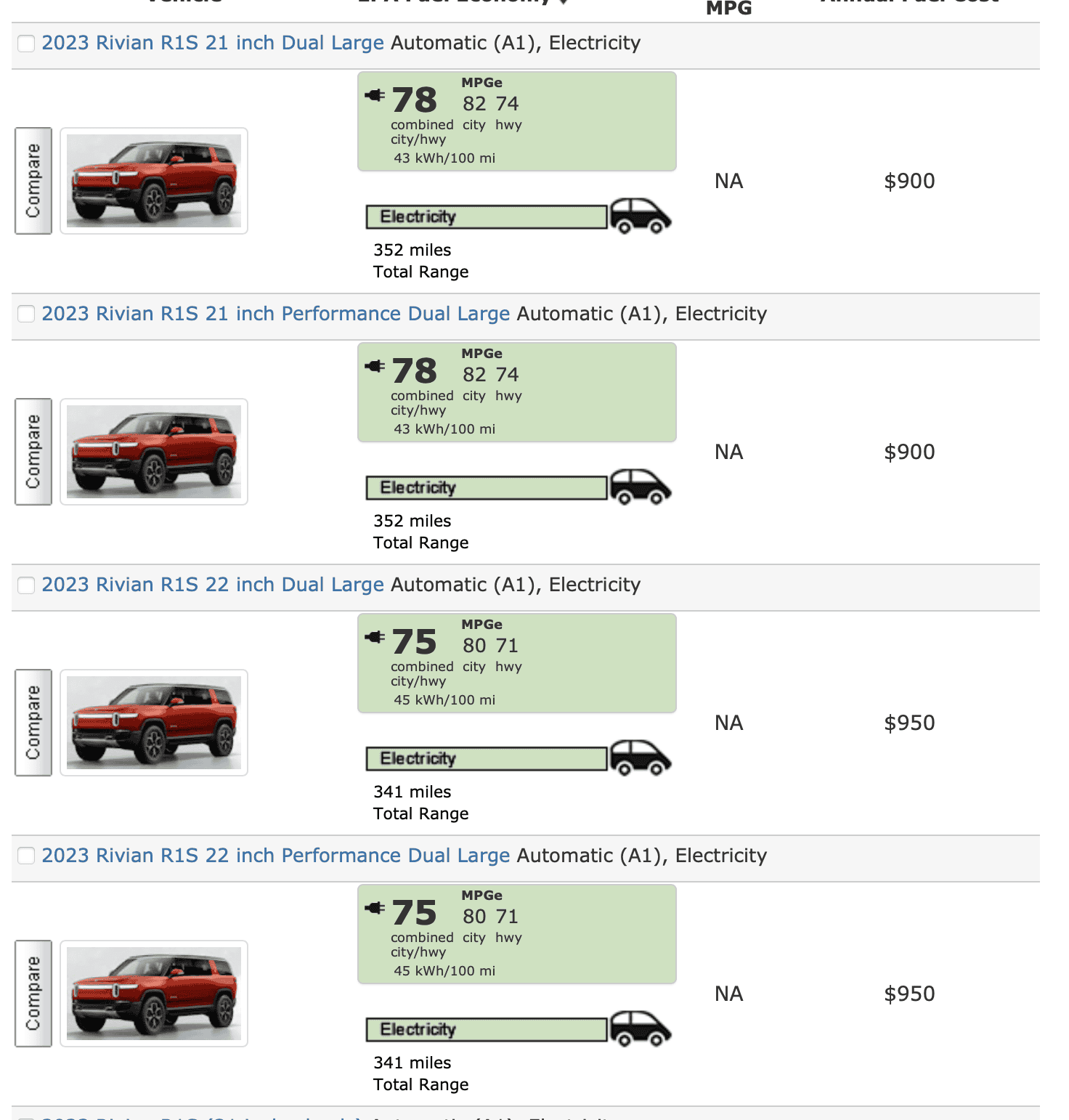

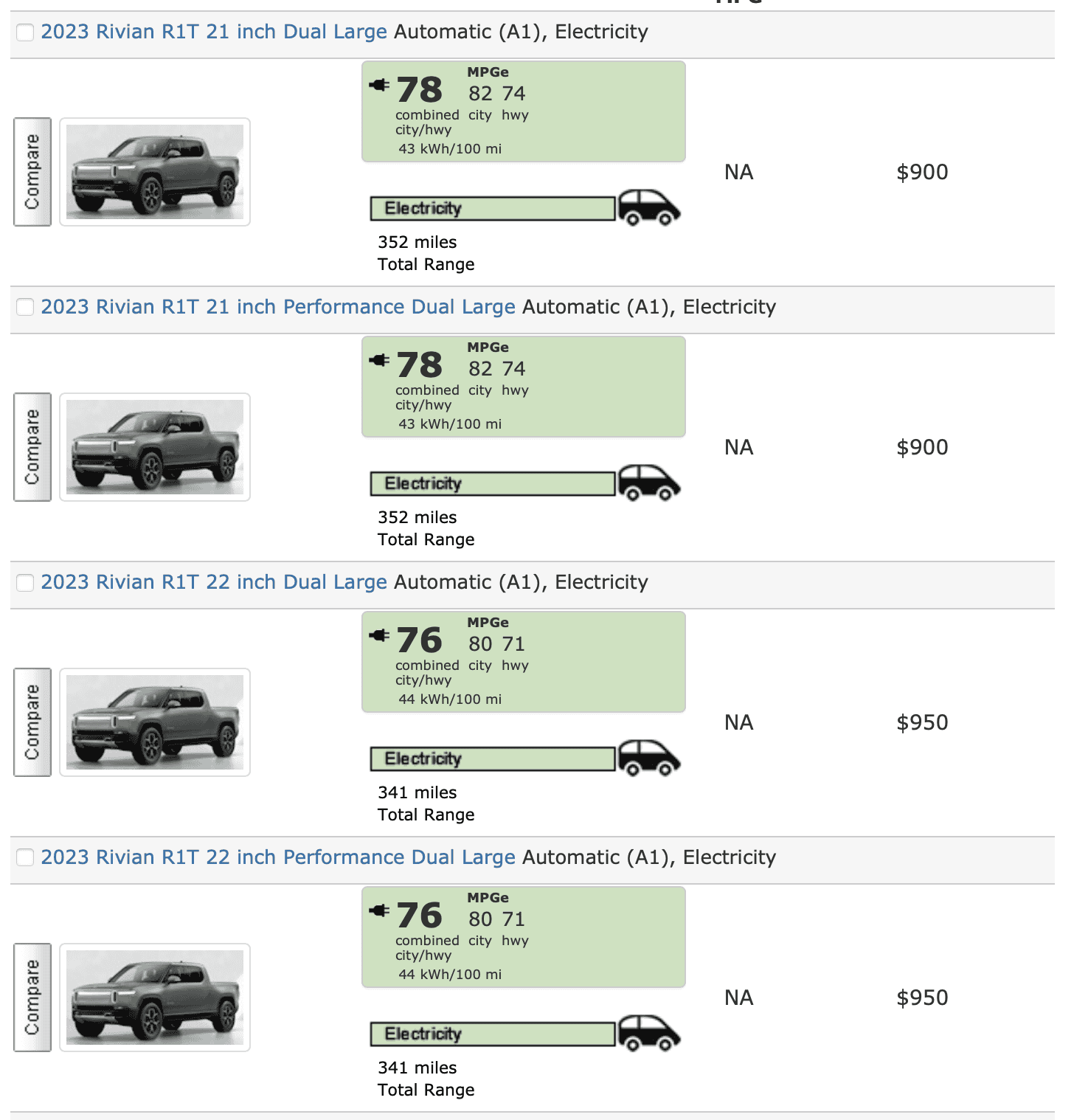

Looking at the now-posted official EPA numbers for the Dual Motor R1S / R1T on fueleconomy.gov I noted that the R1T and R1S are identical and the 7 mile range differential has now disappeared. Strange. Also, Rivian has still not updated its configurator (still showing 340 and 350 for the S / T respectively).
Official numbers 21" tires - 352 miles; 22" tires - 341 miles (307 miles for 20" tires but only showing for R1S on EPA site).
Rivian R1T R1S Range Identical for Dual Motor R1S / R1T? Screenshot 2023-08-07 at 13.22.57
Rivian R1T R1S Range Identical for Dual Motor R1S / R1T? Screenshot 2023-08-07 at 13.22.22

How can the R1T on 22"s with a 135kWh pack @ 44kWh/100 mi indicate a 341mi range
and..
An R1S also on 22"s with the same 135kWh pack @ 45kWh/100 mi indicate a 341mi range?
The new math?
I think someone at the EPA made a slight error ;)

^ Battery size is not important here, point being you have two vehicles with the same size/capacity battery pack:
One travels 100mi using 44/kWh
One travels 100mi using 45kWh
They can't possibly have the same range from the same size battery. One vehicle is less efficient than the other and will have 6-7mi less range than the other assuming a 135kWh pack capacity.
