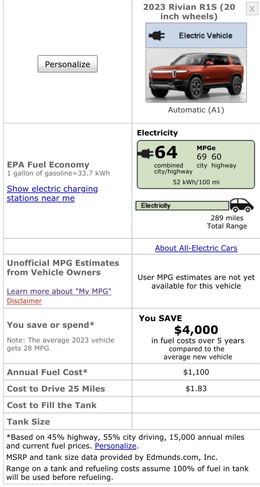

This gets even a little more confusing because the official EPA range for a 2023 R1T with 20's is listed as 289 miles.
Rivian R1T R1S Range Variation between Studio and Configurator Screenshot 2023-06-09 at 12.01.52 AM
I haven't seen an explanation as to why the configurator is now listing a range of 274 miles. However, I am wondering if it's because testing is now with the "off-road package" rather than just the 20's alone - i.e., there is now a little extra weight from the Reinforced Underbody Shield and Spare Tire. But if that's the case, I'm surprised the latter results in a 15-mile decrease in range.
Whatever the case, I would like an explanation.

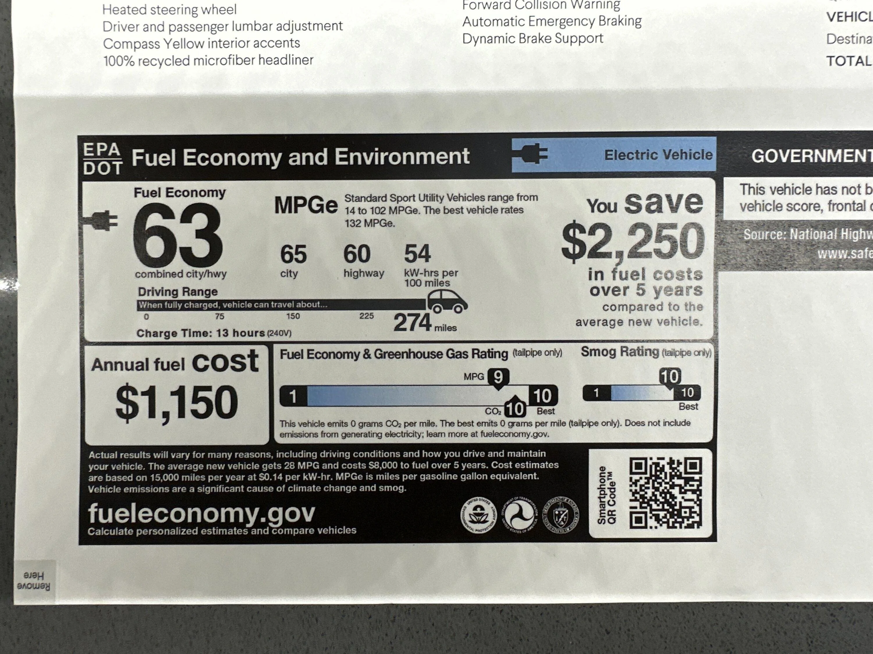

Our window sticker shows 274:
.... interesting. I wonder what pushes it down lower than the values Rivian presents in the vehicle.

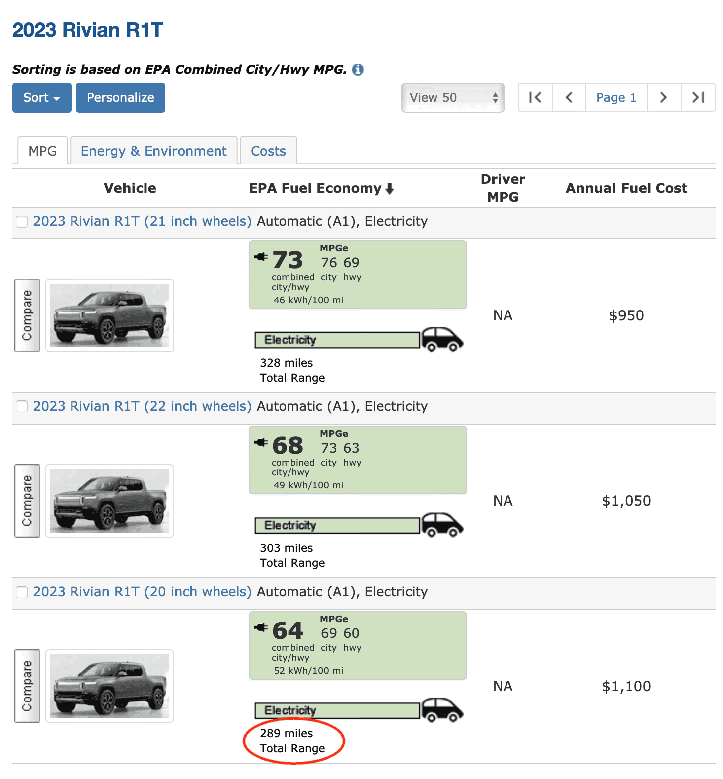

Thanks for posting that. This is different than what’s on the Fueleconomy.gov website:
Rivian R1T R1S Range Variation between Studio and Configurator IMG_2247
As I mentioned above, my best guess is prior testing was with 20” tires only and updated testing includes the reinforced underbody shield and spare. Again, that’s just a guess.

Given that ours has the All Terrain package (wheels + underbody shield + compact spare) I think @shrink may be right and that package reduces the range as far as the EPA is concerned.

It does reduce it per the EPA, but our modes should bracket the EPA rating since the EPA rating is a mix of modes. As @VSG mentioned, I wonder if they're just using the old EPA rating on the window sticker and website.
