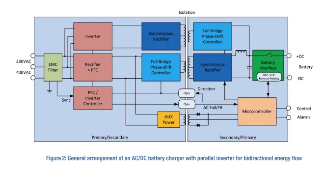

I don't think the hardware necessary to run the AC to DC converter backwards is that significant. It just needs to be part of the design from the beginning.
I think the 120V is on its own 12V to 120V inverter, and it is not a DC to AC conversion going on.
The Rivian 120 VAC inverter uses the ~400 VDC HV Battery as its power source. @Dark-Fx did a detailed teardown.
Regarding bidirectional, It does need to be part of the design from the beginning. I looked at a generic design of a bidirectional inverter a few years ago when the this topic came up. Keep in mind that charging is 240 AC -> ~400 DC, while V2H is the opposite. That reference design used two sets of IGBTs - one set for "inbound" charging power, the other set for "outbound" home power, with additional supporting circuitry to manage the bi-directional operation. In a sense, it is two separate inverters on a single board. It's nowhere near as simple as just reversing the power flow through the existing hardware. Here's a block diagram, note the opposing pairs of rectifiers and phase controllers.
