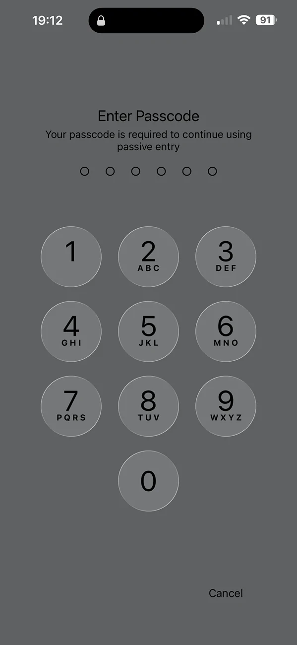

Anyone else getting this every so often? I've noticed my phone randomly buzzing and when I look at it this is the screen.

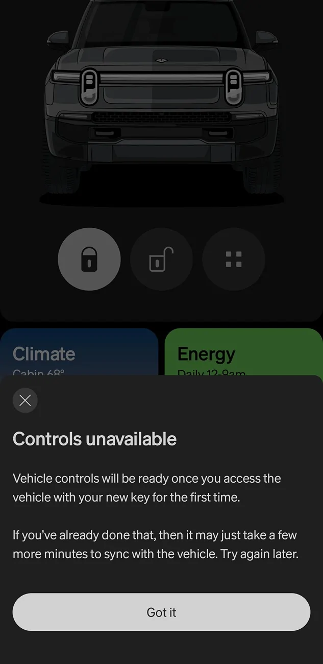

I dont know whats wrong with mine, the r1s opens drives and closes with the digital key just fine. But i can't control the vehicle from the app. Keeps showing this error message which is obviously wrong since I've been using the digital key since yesterday to drive the Vehicle
Any ideas?
Any ideas?
did you set it on the center console after pairing?

But as I mentioned on my post above. All control functionally isn't working still. And yep I did put the phone on the charging pad when I transitioned to the digital key.
