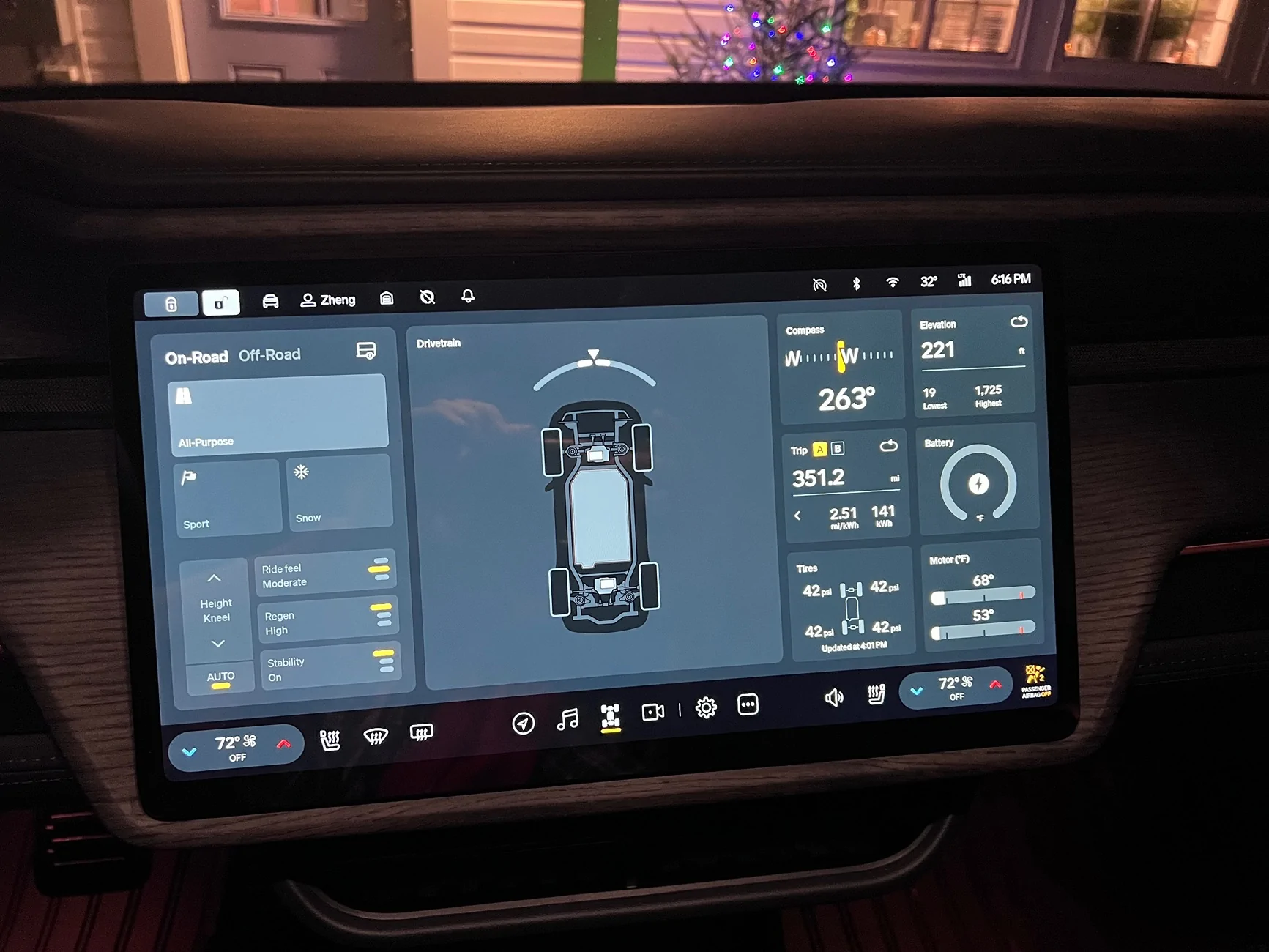

Just did same trip of around 350 miles to Maine as I did in October when I had done whole trip without charging with 50 miles to spare at destination. But yesterday with temperatures between 30°- 40°, I would have done it again with 0% on arrival but I opted to have one charge at supercharger for 8 minutes, 10 kWh and $5. At destination I had 17 miles and 4% on the dial. Average efficiency 2.51 mi/kwh. Nothing to write home about but surly a very easy trip.

These types of trips may occur once per month, so not the primary use case.
Even 1x per month, if legitimately -20 and 5 hours might make the case against EV at the moment.....unless you have fast charging along the way and don't mind the stop (not an issue for me because I would want to stop for bathroom and/or food/coffee within that time period anyhow.
