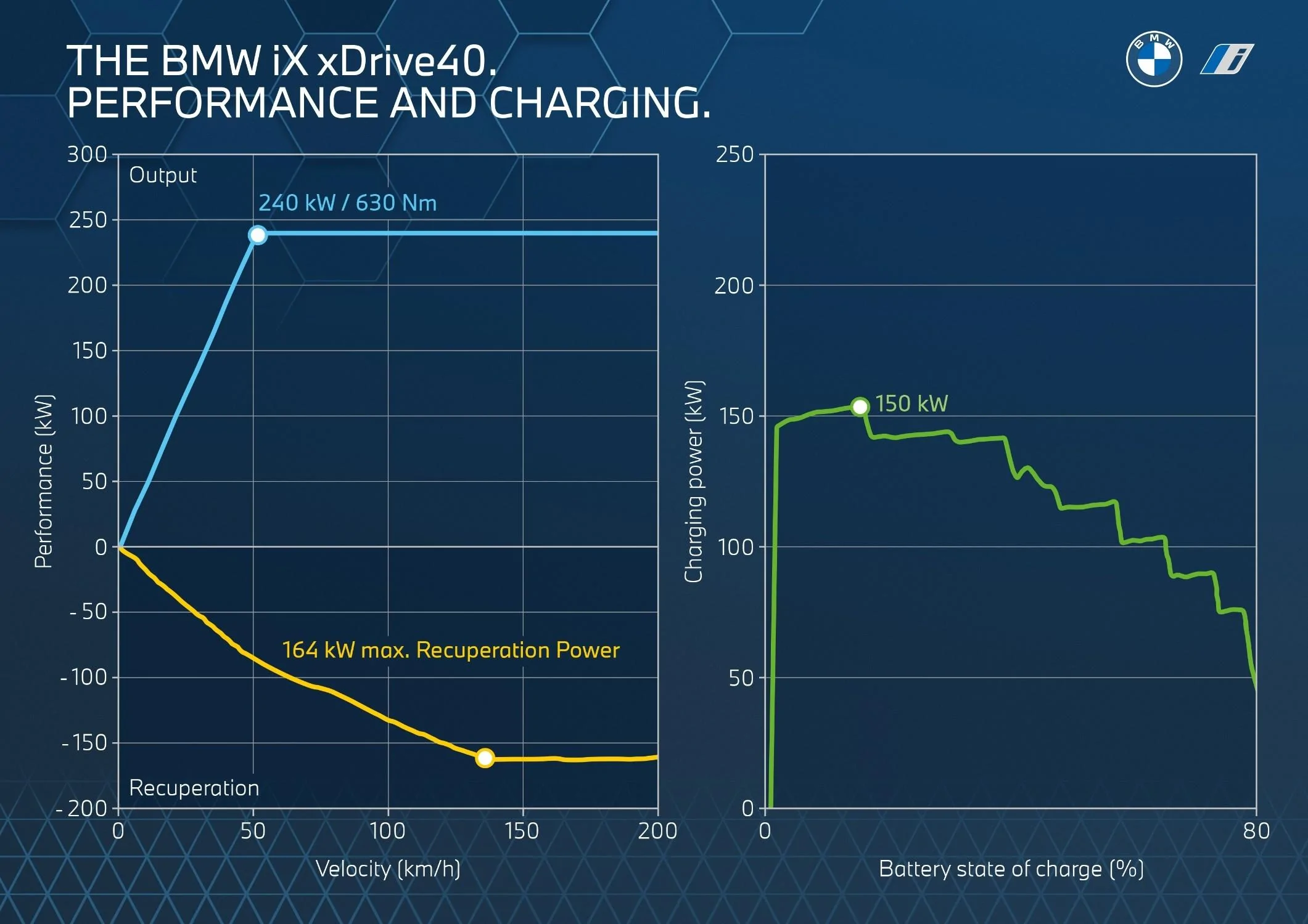

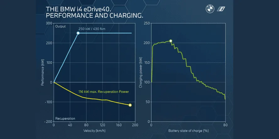

Rivian can do what BMW did for the i4 and iX. They provided the charging curve and power delivery for both their vehicles,
Rivian R1T R1S Rivian is doing itself a disservice by not publishing a charging curve bmw-i4-2021-leistungs--und-ladekurve-des-i4-m50
Rivian R1T R1S Rivian is doing itself a disservice by not publishing a charging curve bmw-i4-charge-2021-01-888x444
Rivian R1T R1S Rivian is doing itself a disservice by not publishing a charging curve P90423871_lowRes_the-bmw-ix-performan

To be fair on Rivian/Rivian Employees, no other manufacturer other than BMW has provided an official charging curve. Even Tesla does not provide it.
The reason they don't is because there isn't one. The vehicle manages the charge rate taper according to the conditions that pertain during the particular charging session based on SoC, temperatures etc. As the battery becomes fuller the charge rate will taper. We can go out and measure individual charge profiles and get general ideas about the manufacturer's general approach (i.e. manufacturer X maintains high charge rate to higher SoC than manufacturer Y) but you will learn more by looking at the total time to gain a given amount of charge than by concerning yourself with the curves for your individual charge sessions. For example I know that it will take me about 1% of an hour to pick up 1% SoC. I know that's not true in going from 90% to 91% and I know it's not true in going from 10% to 11% but then I don't do charges in those regions.
Knowing your overall average rate makes planning charging stops very easy.
