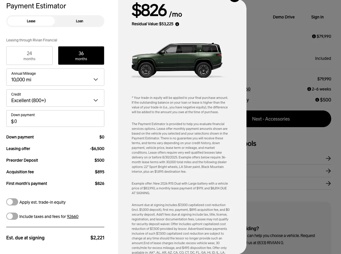

I feel dumb for asking this, but is the $7,500 EV credit already factored into the price that Rivian lists on its lease deals?
I am looking at a $79,990 dual standard R1S that qualifies for the $6,500 Endless Adventure lease bonus. That particular bonus shows up in the payment estimator (-$6,500) but when I calculate Est. due at signing , plus monthly payments x35 (first mo already down), plus residual value, I come out to $84,356 (without taxes) for a model that is priced at $79,990 and supposed to have a $7,500 EV credit and $6,500 lease credit. If those $14,000 in incentives get the price down to $65,990 (plus tax) then I would be in the market for a new lease/immediate buyout, but if thats not how it works then I am likely relegated to used.
Don't feel dumb for asking, that's what the community is here for, to help and bounce ideas around
I took this exact config, which I think is same/close to what you pictured:
https://rivian.com/configurations/i...27842cf6877a41353774ee/build?postalCode=92660
Then you have to make sure you click the "taxes and fees" slider.
I worked it up in my calculator, specifically for your config (here is a copy just for your specific numbers), see here in this hyperlink
The key numbers ... let's talk all inclusive cash out the door vs price + tax/fees/etc, as thats what hits your bank account!
1. If you straight up buy it with a bag of cash, with taxes/fees, you've got ~89k out the door. Sanity check me here by comparing the "Loan" amount in the payment estimator, it has ~88701 "financed", which is ~89k minus the 500 deposit amount.
2. If you lease + buyout, with taxes/fees/etc, your cash out the door is ~78k
3. that means you save ~11k roughly with lease + buyout, a ~13.5% discount. Some of the 14k incentives get washed out by a portion of first months rent charge + lease acqusition fee, etc, but you get to capture a significant material discount on this asset! :)
