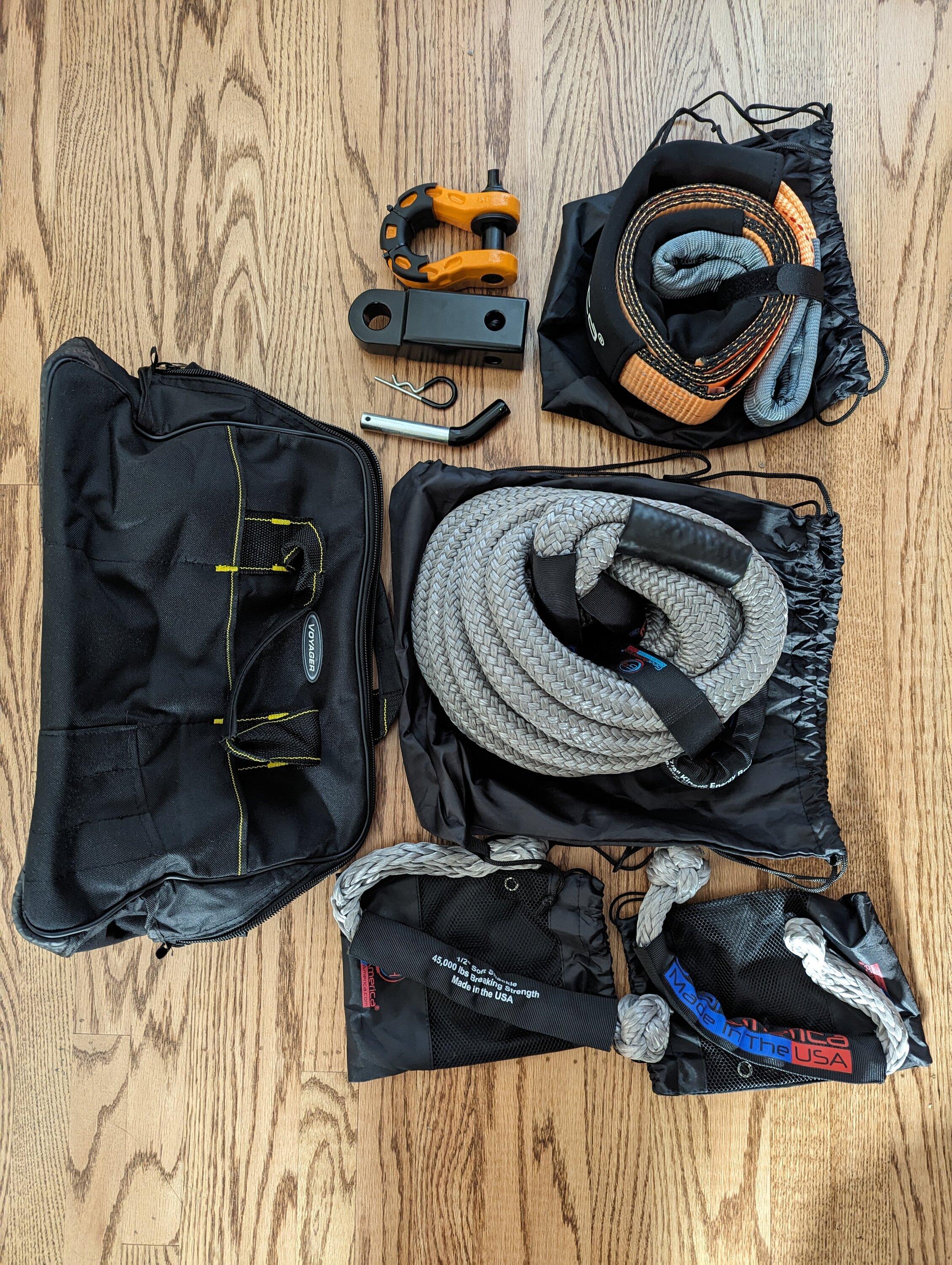

My recovery kit:
$82 (2x) GearAmerica Synthetic Soft Shackles 1/2” Grey – Made in The USA – 45,000 lbs (22.5 US Tons) Strength – for Off-Road Recovery, Towing & More – Stronger Than Steel D Rings – Bag Included https://a.co/d/iN1ke7q
$156 GearAmerica Kinetic Recovery Rope – 7/8” Heavy Duty Snatch Rope – 28,500 lbs MBS – Stretches to Absorb Energy Then Recoils – Recover Vehicle – Proudly Made in The USA – 30 ft, Grey https://a.co/d/5rKNajo
$55 GearAmerica Aluminum 2”x2” Hitch Receiver & Mega Shackle – 32,000 lbs (16T) MBS, 16,000 lbs (8T) WLL – For Heavy Duty Towing and Off-Road Recovery – Includes Shackle, Washers & ⅝” Pin – Black & Orange https://a.co/d/06SUFrK
$24 GearAmerica Tree Saver/Winch Line Extension Strap 3" x 8' – Certified 35,053 lbs (17.5 US Tons) – Off Road Towing and Recovery – Extreme Weather Resistance, Heavy Duty Triple Reinforced Loops https://a.co/d/a0prQSI
$14 https://www.harborfreight.com/25-pocket-mechanics-tool-bag-61468.html
Total cost: $331
Weakest link: 14 ton MBS.
