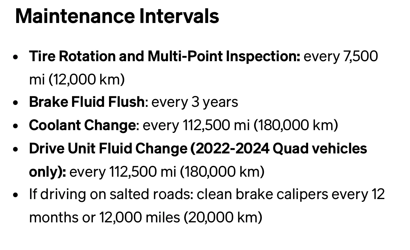

I don't see them as apples and oranges. More like different varieties of apples. Both cars use brakes infrequently compared to an ICE vehicle, and that carries with it the risk that the pistons in the calipers may seize, the pads may chunk off due to more frequent sticking to the rotor, etc. My 2015 Model S needed brakes at 50k as the pads had partially seized in the caliper due to infrequent use and likely little to no maintenance during 4 years in the snow belt. I also had to use the brake when slowing to a stop as that car only had induction motors. Rivian recommends brake service (clean and lube) every 12k if you drive on salted roads. Tesla does now as well. I'm not sure if that recommendation was always in place, however.
