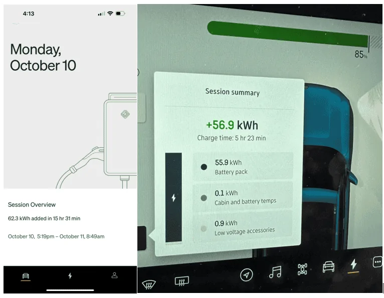

Looks like two different charging sessions... One was 15 hours long and the other was 5 hours long.... Also it is not kW, it is kWh.... One is a measure of power (rate of energy flow) and one is a measure of energy.......
The app view for the charger measures charging sessions as total time plugged in, not the time actually spent charging.

Looks like 1kW didn't go to the battery... not 5kW.
The electricity draw measured by the wall charger is likely what is dispensed to the actual charger in the vehicle. It has some efficiency loss and this is relatively normal. I suspect the vehicle screen only actually displays the losses downstream of the DC voltage conversion.

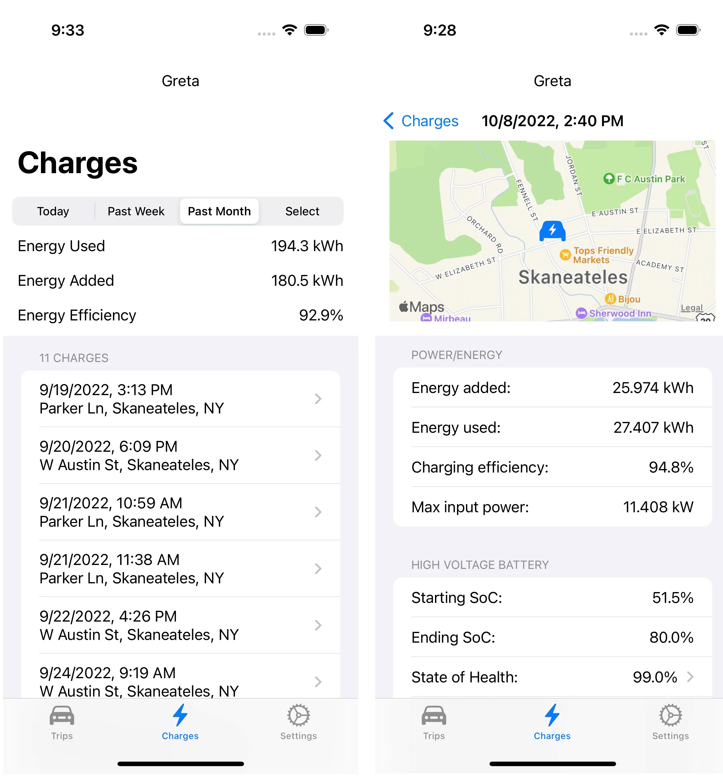

You are seeing the loss converting from 240V AC to ~360V DC where the efficiency is the kWh delivered to the battery (energy added) divided by the kWh measured at the charger (energy used) times 100. There are other small resistive losses but AC to DC conversion is the big one.
About 10% percent is pretty common, here is a snapshot of the past months charging sessions on my Mustang Mach-E with the session details on one:

Has anyone see and more importantly know how to correct this charging issue with the Rivian Charger. It seems to waste approximately 5kw of power per charge. This coupled with all of the Vampire Drain makes for a very inefficient vehicle to own.
Does it though?
Let's see. Assuming these charging session numbers are correct (and I'm not so sure they are) it's 5kWh x $0.138/kWh*. So 68 cents worth of power lost in this charging session. Ten miles maybe. ¯\_(ツ)_/¯
