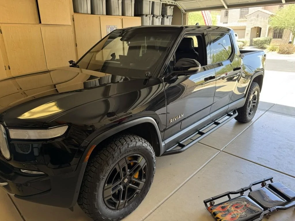

Funny, the design is exactly why I do like them. I don't want any involvement with the battery bolts. They included higher strength bolts than what ships with the truck. So far I haven't heard of anyone damaging their vehicle from them. I've come about a foot down onto the slider with both wheels on that side staying in the air the whole time, and didn't have any problems. Material is also thicker than the competition.

I have the GOAT for a few reasons.
1. The step board things are ugly. I think of a 70s station wagon with running boards. But you can get that if you want, on the GOAT sliders. I will privately mock you, LOL.
2. The EV Sportline and some others have an insanely complicated installation. It's a joke. It's a huge mess and way harder than it needs to be. The GOAT mounts are simple and solid. After downloading and printing the EV Sportline instructions I said, "HELL NO."
3. The owner of GOAT used to own Ace. Those rails are well proven on Jeeps, and I've had them on all my Jeeps which got abused hard.
4. Factory jack puck points are not messed with; some/most/all of the others do. This has been an issue at service centers and tire shops. I've experienced a SC issue with a much more minor mod that wouldn't affect anything and they were assholes about it.
In short, IMO there's simply no reason to consider the others. I've looked at all of them for months and just didn't like the options. When GOAT first contacted me, I was elated.

I live in AZ. What is "rust?" Confused. ?‍♂ But in any case, they'd just get surface rust that won't mean much, since the metal is so thick. You can always hit those areas with CorrosionX.
I cut the panels. That took more time than the actual sliders, seriously. I don't know if it matters, but decided to. I did not try to make them pretty or a tight fit, which would take much longer.

It's a compromise, I personally find that super hideous and IMO, worthless. Or at least, very unlikely to help. On my past off road vehicles I just never hit that part, it was mostly the front through middle or maybe 2/3 back.
