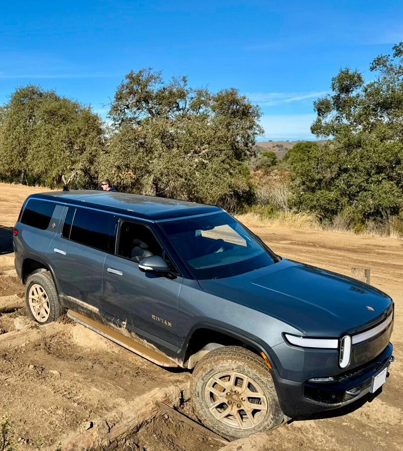

DCE Weistec sliders is my pick for build quality, capability and OEM look.
Rivian R1T R1S Rock Slider Comparison? IMG_9050

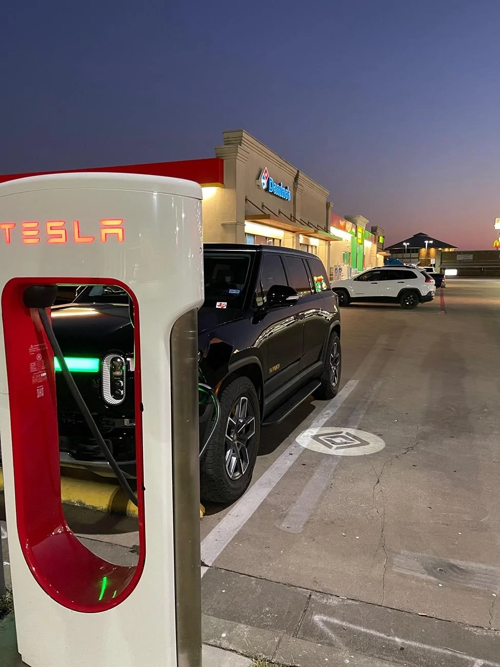

I have DCE Weistec and as others have mentioned, installation was a piece of cake. No modification needed to install. In the rare case that I would need to remove them, I don't see it being an issue.
I had my vehicle serviced by Rivian and they didn't give me any troubles. The same results when I had my tires changed; no problems lifting the vehicle.
I really enjoy them. It makes getting in and out of the vehicle so much easier without having to lower the suspension down. Changing rims at home is also easier and safer because I can use jack stands at almost any spot on the rails.
Even when the sliders got muddy, there was plenty of grip for my shoes.
I purchased mine during the Labor Day sale. It took awhile to ship, but their customer service was easy to contact to get updates.
Rivian R1T R1S Rock Slider Comparison? tempImageEU6Zow
