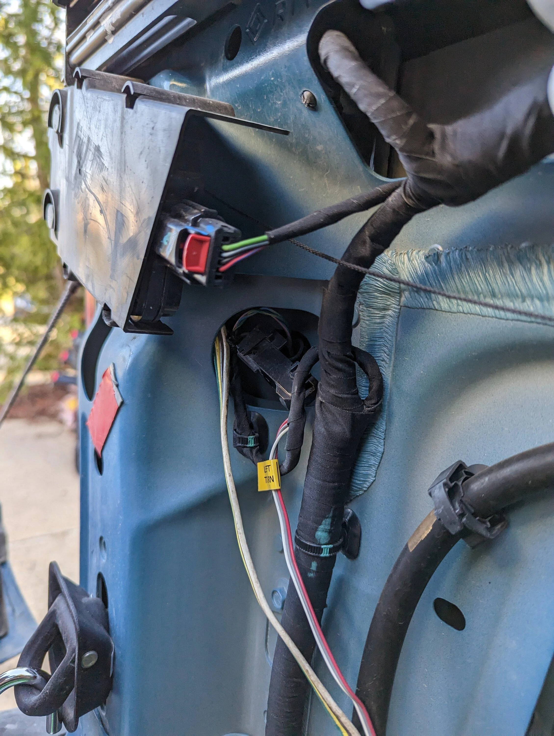

Rivian R1T R1S Rooftop Tents blocking brake lights (CHMSL) PXL_20230410_224810801
I pulled the lights out but the cords are really short if you don't pull the service loop put. Probably just as easy to do it from inside by stripping back the tape.

The thick wires (gray or what you called black) and the opposite wire which has a pink stripe, are power and thin (two middle wires) ones are communications I believe. Not 100% certain since I didn't scope them out.
So I pulled out this connector today and honestly I’m confused. The pink with blue stripe seems to be 12v but not switched by the blinker, brake or even parking lights, didn’t check if it switches off when the car goes to sleep.
The black/dark gray wire I couldn’t get a 12v signal in any scenario.
I guess I may have to look into induction loop method you guys used because this 2 to 3 converter idea seems over my head.
I think the black wire is ground, and the two small wires are CANbus. The controller is built into the taillight assembly. Did you tap the black wire while it was connected to the light, or just run the tester on the connector?
I suspect you'd see voltage on the ground (black) when power is drawn through the taillight (and, in turn, sent to ground)?
Yeah I had it tapped while connected to the light. I too think it is ground but I couldn’t get it to work as a ground with my tester but I might not have been getting a good connection.
I presume if I get the Tekonsha and wire it into the left and right turns like @Dark-Fx did and then use the Curt 2 to 3 connector I should end up with a proper working brake light…. That is if I am understanding what you guys did and what problem you were having.
