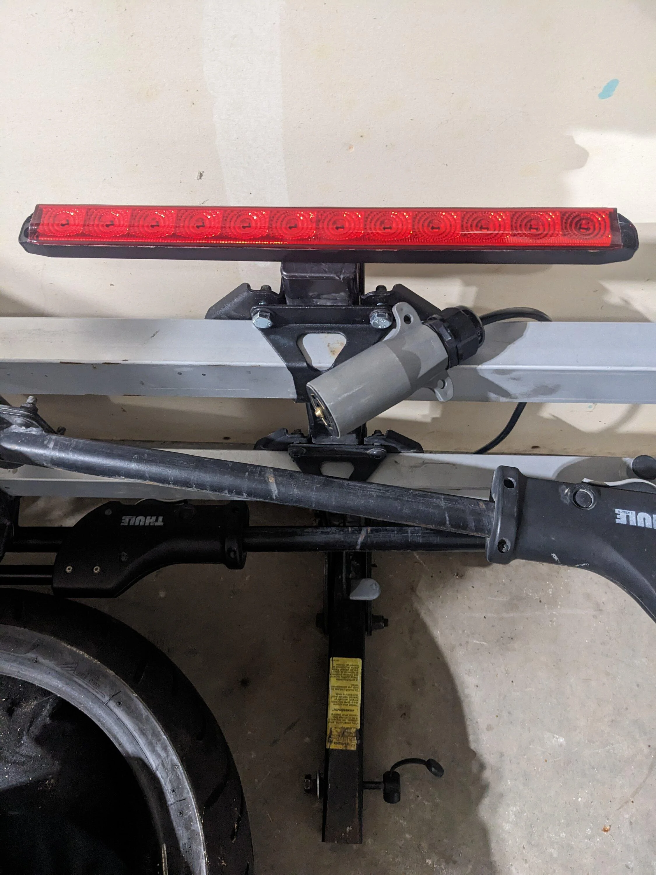

Dumb question, a quick DuckDuckGo didn't answer it:
Are there OBD-II connected wireless brake lights? Plug-in or battery powered, but the braking on/off comes from the plug?
No one answered my dumb question ☹
I ended up forgetting where this thread was and wiring up a trailer plug light to my bike rack. I'll test functionality and driving impacts Friday.

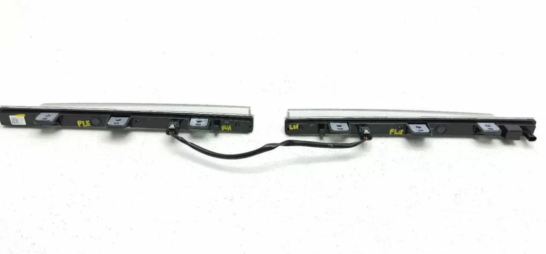

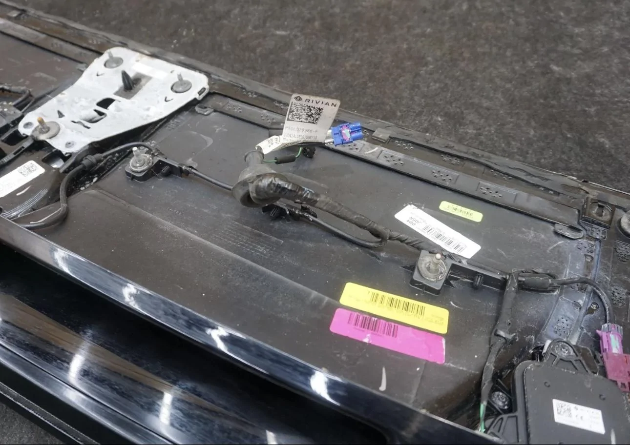

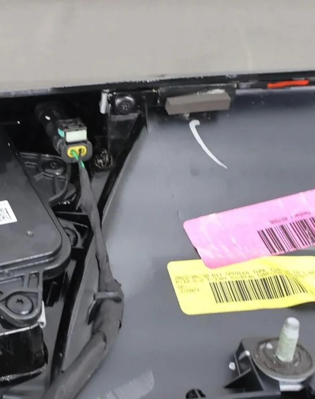

Looking at the existing CHMSL light strip there seems to be one harness towards the left end.
Rivian R1T R1S Rooftop Tents blocking brake lights (CHMSL) IMG_6173
Looking at a picture of the roof spoiler guts, I believe the wires connected to it are solid green and black.

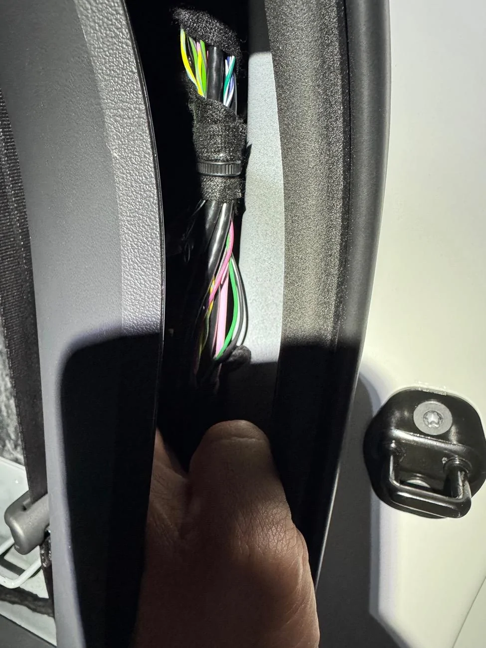

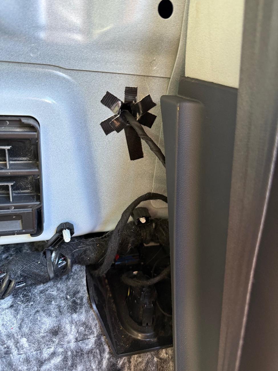

In the pillar beside the rear driver side door there is only one set of wires running up to the roof. Within the set is the same solid green and black wire.
Rivian R1T R1S Rooftop Tents blocking brake lights (CHMSL) IMG_6171
Does anyone want to see if tapping these wires would work. I don’t have any taps at the moment and I’m too chicken poop to cut them.

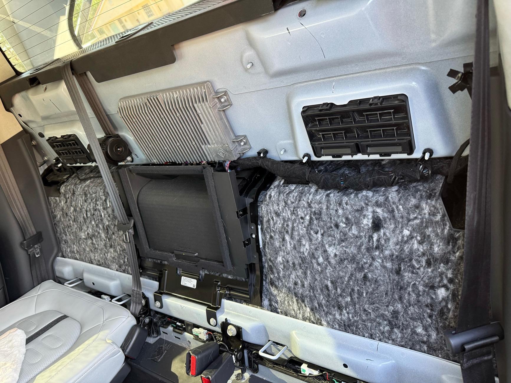

Wiring the rear brake light:
Step one
Remove the rear seat bench
it is held in with two 15mm bolts under the headrests, on bolt on the bottom middle (15mm ) and one nut centered under each passenger back area (15mm as well)

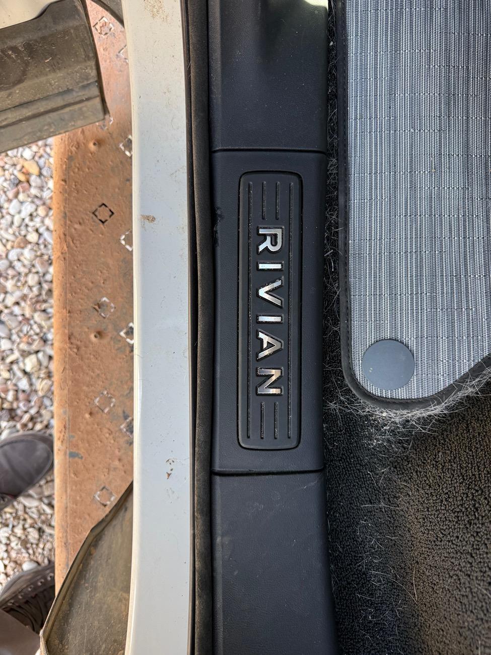

Once removed, pull the small kick/ sill plate from the driver side floor

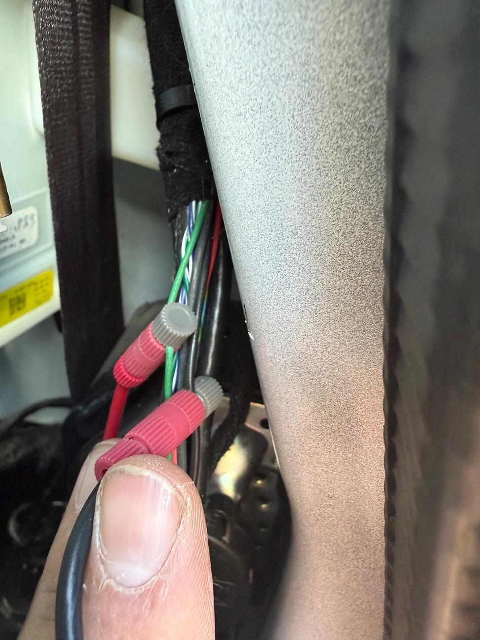

In the loom locate the plain green and plain black wire (black wire is smaller 22awg)
Rivian R1T R1S Rooftop Tents blocking brake lights (CHMSL) img_1874-jpeg
verify it is the plain green and not the stopped green
this is the chsml pair
I tapped into the wires using a positap
Highly recommend
You can get them at O’Reilly or Amazon

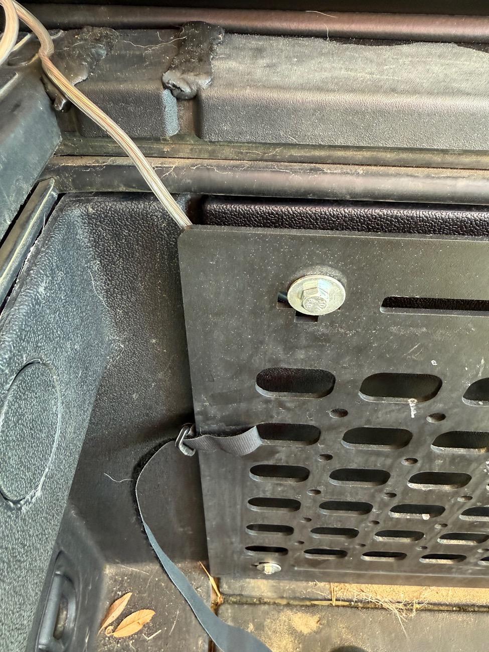

In the truck bed remove the rear plastic panel it is held in with 8 M6 (10mm socket) bolts that are hidden under the plastic circles
once pulled you can see the tonneau stack if you have it and a few grommets
I don’t have a tonneau so I used the higher location to not have to fiddle with the sliding over the gear tunnel
Rivian R1T R1S Rooftop Tents blocking brake lights (CHMSL) img_1880-jpe

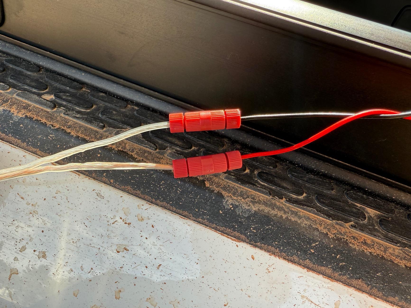

you can use the lower grommet and fish any wire around the felt of the gear tunnel and out the space behind the passenger seat
Drill a hole in the plastic piece in the location of you liking, or figure out a seam to tuck the wires through if you are nervous about drilling
I don’t like pinching wires so I went the hole drilling route and will use a weatherproof mini box as I have other cables using this area to run power
Rivian R1T R1S Rooftop Tents blocking brake lights (CHMSL) img_1881-jpe
hook up the lights to the provided pigtail (gfc came with some positaps, which I moved to the splice location, and then used the twist connectors to connect the short length of jump wire needed
Rivian R1T R1S Rooftop Tents blocking brake lights (CHMSL) img_1884-jpe
that’s it!
It works
Rivian R1T R1S Rooftop Tents blocking brake lights (CHMSL) img_1875-jpeg
No extra sensors or modules to burn out
No false trigger of trailer mode
No issues with turn signal behavior
it just works.

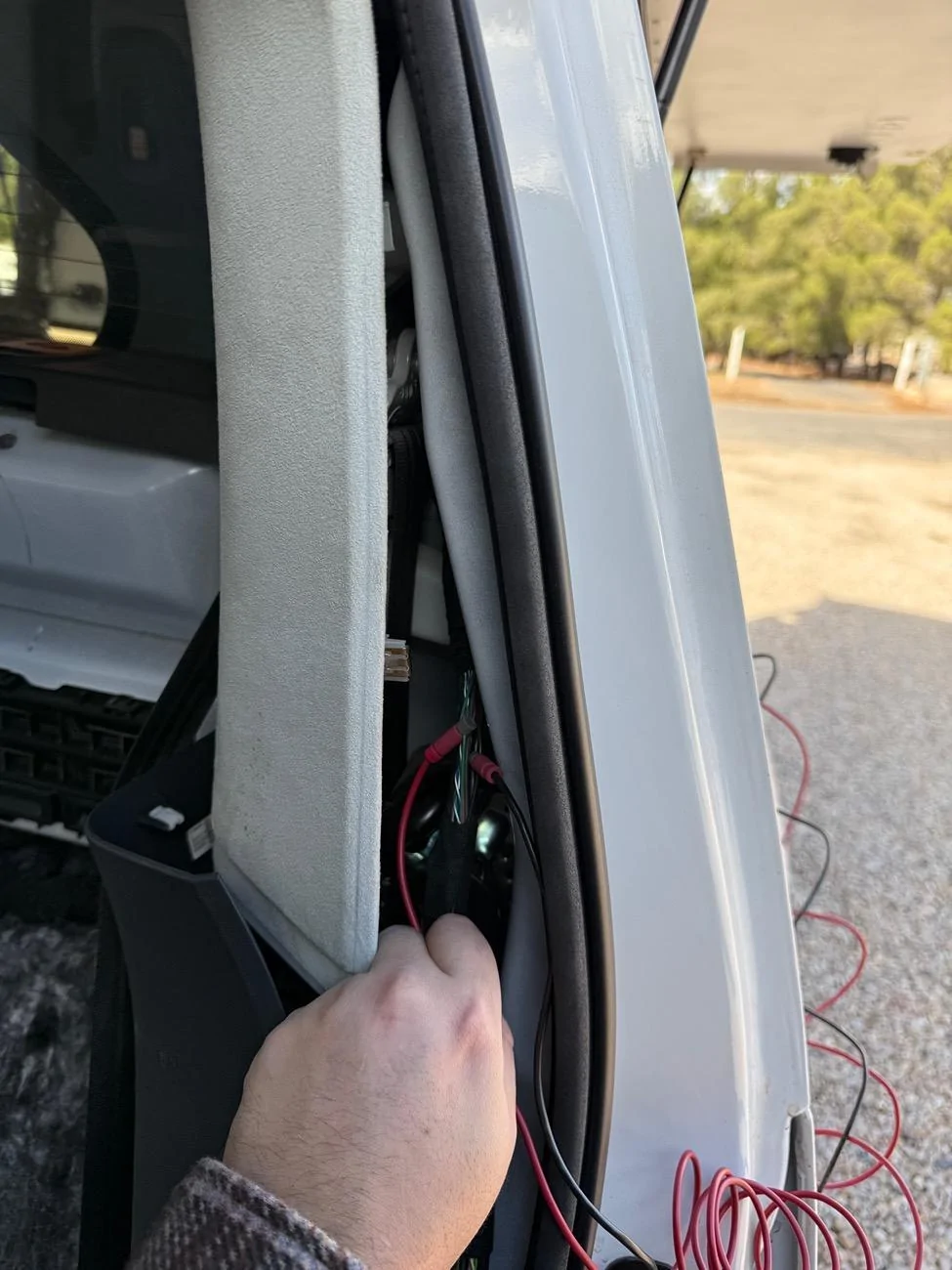

I just got done wiring my rear lights the way (sort of) you described. The very first bolt I tried to remove snapped the retainer for the nut and there was no way to get it or the seat out. I was able to remove the pieces of trim and attach the positaps to the wires in the harness. From there I routed it under the trim and followed the existing harness. I went through the upper grommet in the bed and under the left bed wall. It works perfectly and looks like factory. Thanks for the heads up on where to hook up to the truck's system. Putting the motorcycle across the back on a hitchhauler blocks the lights pretty effectively so this was a must.

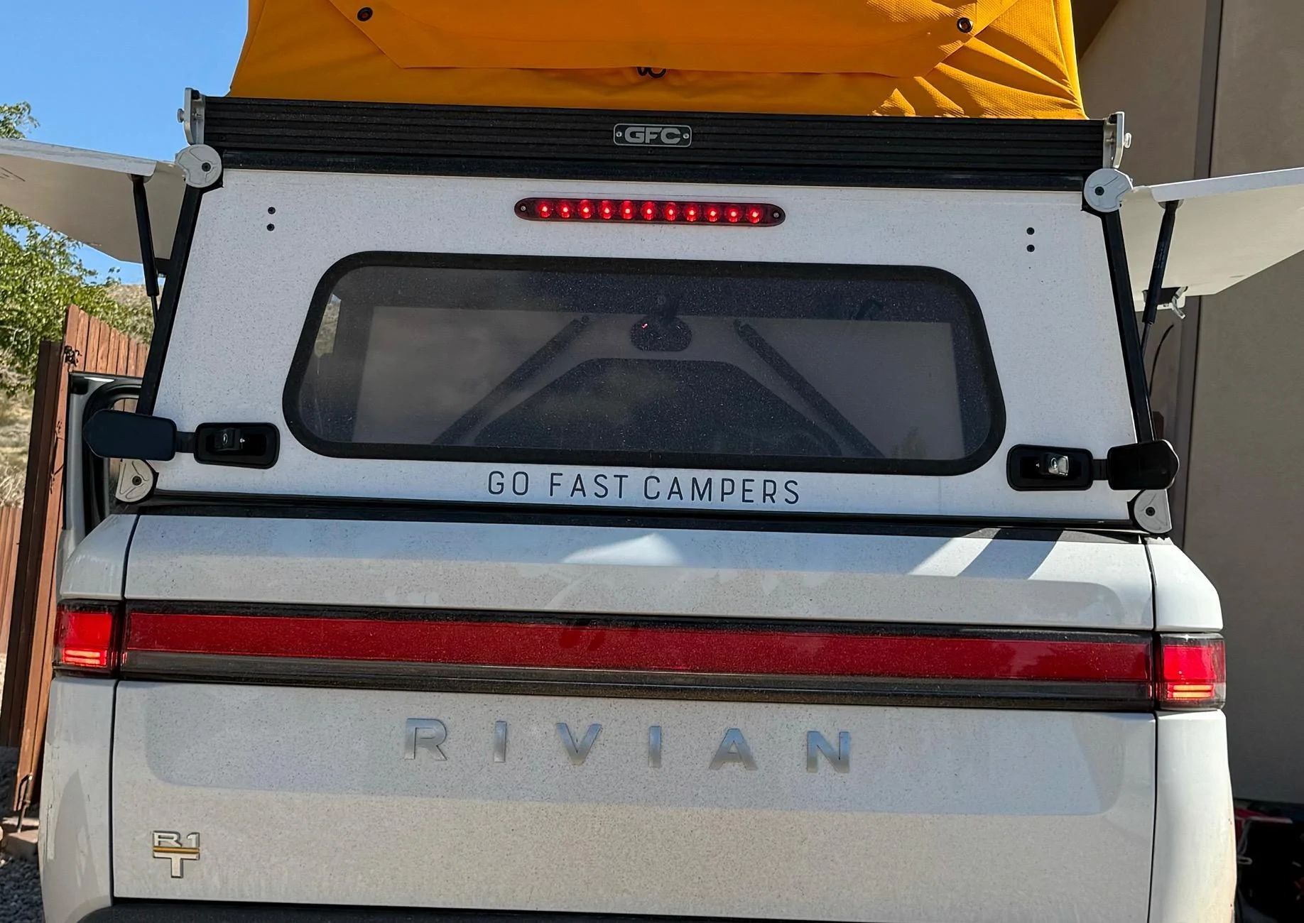

I followed your instructions and YES it does just work! Thanks for your great documentation, MUCH appreciated.

I have a gen2 R1T with a GFC and the installer did not wire in the brake light. I still haven't got mine working yet, but the light bar is just a running light. The brake lights are small and in the rear corner tail light assemblies. I was able to test the GFC light by using a trailer hitch adapter for active high Brake signal and GND, however this solution triggers trailer mode which limits emergency breaking and disables ACC, so I didn't fish the wire through as I didn't like this solution.
Next test will be to tap the back side of the trailer hitch wire, to see if the hitch plug is what is triggering the trailer mode, or if it is an electrical load on the brake line. I'm also concerned that the brake signal will not activate on this assembly if a trailer hitch plug is not detected.
This triler hitch plug was helpfull in diagnosis, as you can re-wire each signal and run your own wire.
