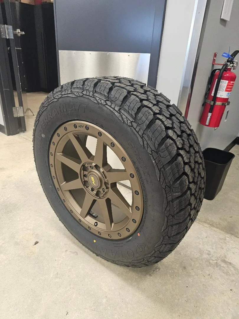

So now I’m a little ticked. Seems that EVSportline has updated the R800s to match factory offset of +48 rather than the +35 I got. ?‍♂
not only this, but I may need a new wheel as my wife hit a curb pretty hard, so now I’d get a mismatched wheel if I order a replacement??

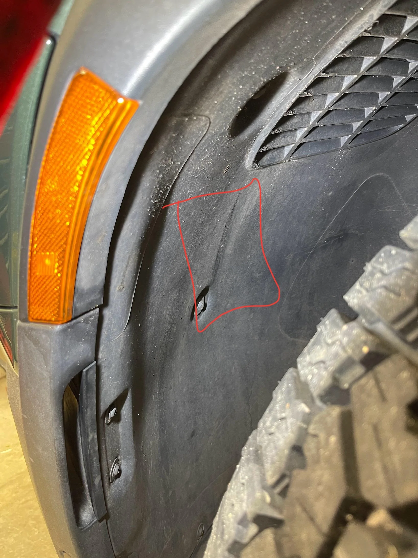

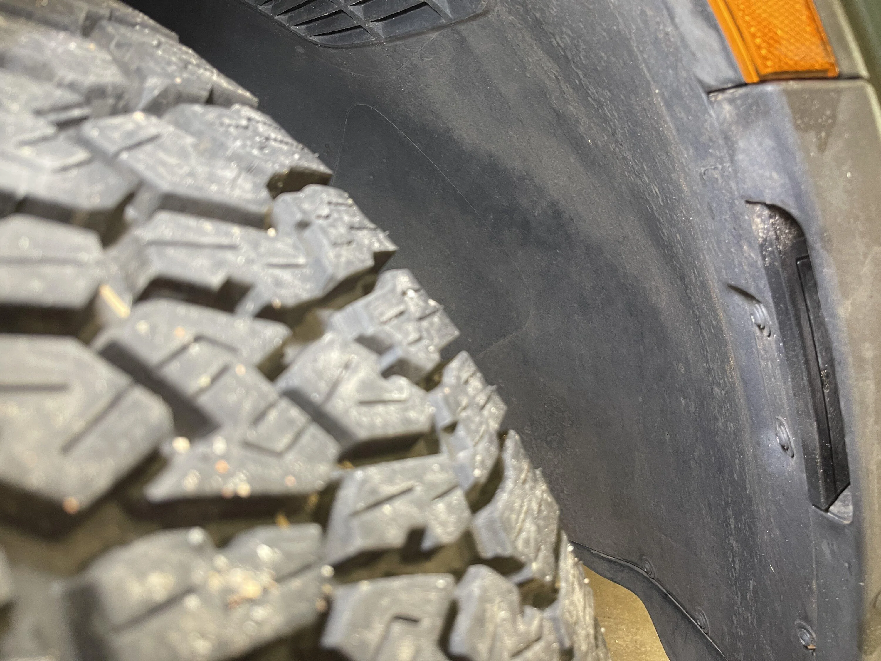

Alright finally got warm enough to clean off the grime and take a closer look where the rubbing is going on.
Put suspension in low and tried full lock both ways. No obvious rubbing at a standstill, which is expected. I only would hear it rub with some load on the truck while turning. I did however see a rub mark where I’m guessing the rubbing I happening, and curiously I only see it on the left wheel well (front part). See the photos of both left and right side wheel well.
I also did a rough measurement of the hub to fender and seems to be about 1/4-1/2” lower on the front left side than the front right. I’ve heard of others having imbalanced suspension, so I’ll be asking Rivian SC about this on my visit next week.
Front left:
Rivian R1T R1S Rubbing issues with EV1 R800 wheels IMG_0016
Front right:
Rivian R1T R1S Rubbing issues with EV1 R800 wheels IMG_0017

Slight update on this. EVSportline reached out and offered to swap out my +35 offset wheels for the newer +48 they’re now selling to hopefully alleviate the rubbing. I got them installed $180 to discount tire..ouch!) and it seems to now not rub in standard height when I do my neighborhood dip test, but the same test done in Low (not lowest) it still rubs. Ugh…So, an improvement but not fully addressed.
Also, my wife hit a curb in December and messed up my alignment pretty bad. Took it in to SC and they checked everything and aligned the truck. Also asked about the ride height adjustment and they said they’d check that too. Seemed like the running actually got worse after they adjusted it. This was on the old wheels when it was initially done in late December.
So now, I’m on a factory wheel size/offset with same as factory AT size tire (though a more aggressive tread), and I still get rubbing at even just Low setting. Gotta be something up with my truck, right?!

Is the problem that the sound annoys you, or that you're concerned contact is going to damage something behind the liners?
If its the former, I recommend turning the left side steering wheel knob up while music is playing until the rubbing is no longer noticeable.
If the latter, and for some consolation, with that light of rubbing nothing's going to get hurt other than some plastic will get polished. If the tires aren't contacting at the 12 o'clock position on the front fenders, you're in the clear.
Source: I'm running BFG K02 285/65R20 +18 offset raceline wheels that rub like crazy, and have actually popped out the plastic fender trim when I go full compression in the desert. Haven't bent the fender metal yet and there's definitely been contact.
