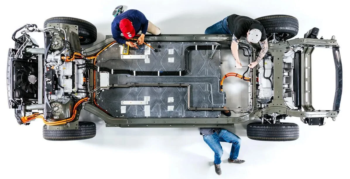

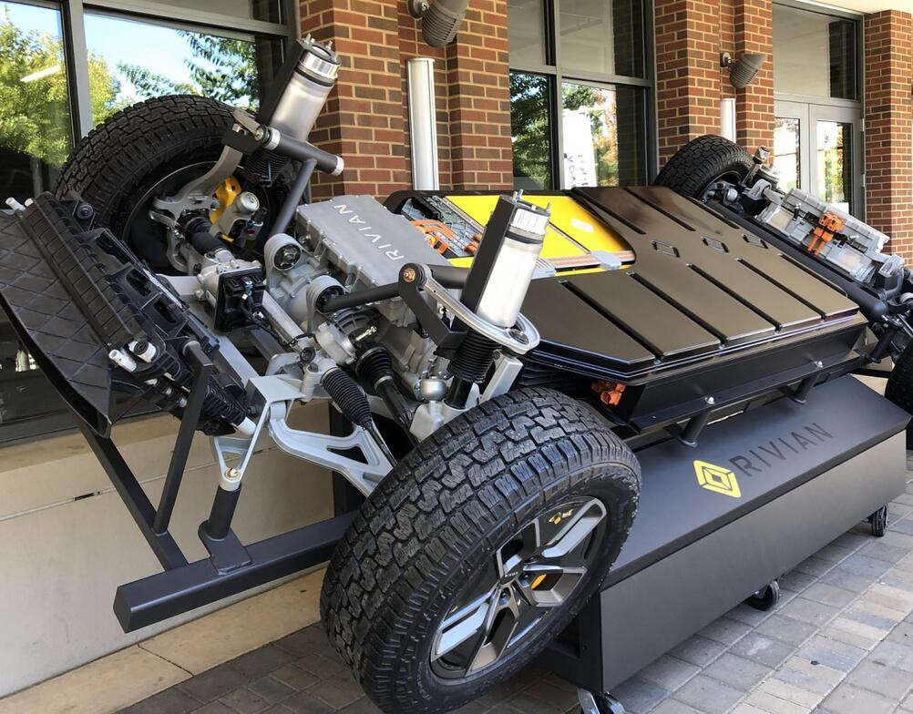

WIthout seeing a full skeletal breakdown of how the frame is connected, I cannot say for sure, but in theory I disagree with you.
The entire premise behind the Rivian is the skateboard platform.
Then the chassis is bolted on top of it.
There's no reason for anything beyond the functional components of the suspension to be flexing at all. Unless the skateboard platform itself is flexing. And if it is, that's a problem, given the fact that it's the battery pack and is responsible for not only the structural integrity of the vehicle, but also the ...you know... integrity of the batteries.
The dimples are a concern. Obviously something happened here, but I think the *what* is more of a mystery than 'chassis flex.' I could be wrong on this one. And as pointed out by others, between the sliders and the hitch mounts, there are added stress focal points to the frame that might have otherwise been intended flex points. But again, I'd have to see the vehicle's internal structural breakdown. I'd be very interested to hear what Rivian would have to say bout it.
My thoughts exactly!
For that happen, the whole battery pack had to bend/flex and or break loose from the frame. It could be permanently damaged and no longer hermetically sealed? I would get it in to Rivian for a safety check ASAP.

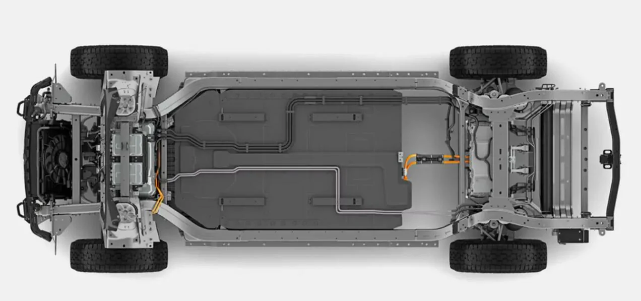

The "skateboard platform" is a cute term, but in simple terms, R1s are body on frame vehicles with a battery bolted in between the rails.
The flex could be a very small amount but it would still show in the sheet metal.
The construction of the R1 is not far off from the GXs you see in the photos along with it. Frame with powertrain in it, with body bolted on top.
Main difference is the Rivian body is hard mounted to the frame so any deflection in the frame will transfer to sheet metal much easier than traditional body on frame designs which usually have bushings.
