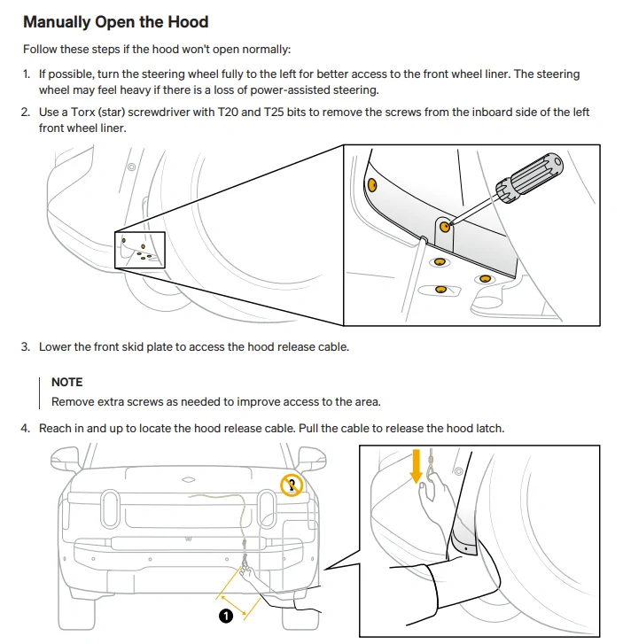

Just need to vent. What is Rivian doing here? My R1S apparently got flagged as needing a “preventative 12V replacement”. Mobile service came out and fixed it, free 12V which was nice. But since that, my frunk won’t open, but the car thinks it’s open so it’s stuck at 13mph. I called Rivian and they said “because of he urgency we can get you in right now”, I said okay awesome but make it two hours from now because I live an hour 15 away normally but am in turtle mode, , they said no problem. I hopped in the car and went to the service center and the woman there was like okay so we can’t get you in until tomorrow, but we’ll give you uber credits to get home and I was like umm this is my only car, it has all my kid’s shit in it (including car seats), I can’t just uber an hour and 15 minutes home lol. They’re basically like sorry sucks to suck, you need to come back tomorrow.. meaning I have to drive there and back again at 13 mph lol all for something stemming from a “fix” I never asked for. So irritating.
That manual release procedure for the frunk sounds good and I’d try resetting the vehicle as well.
