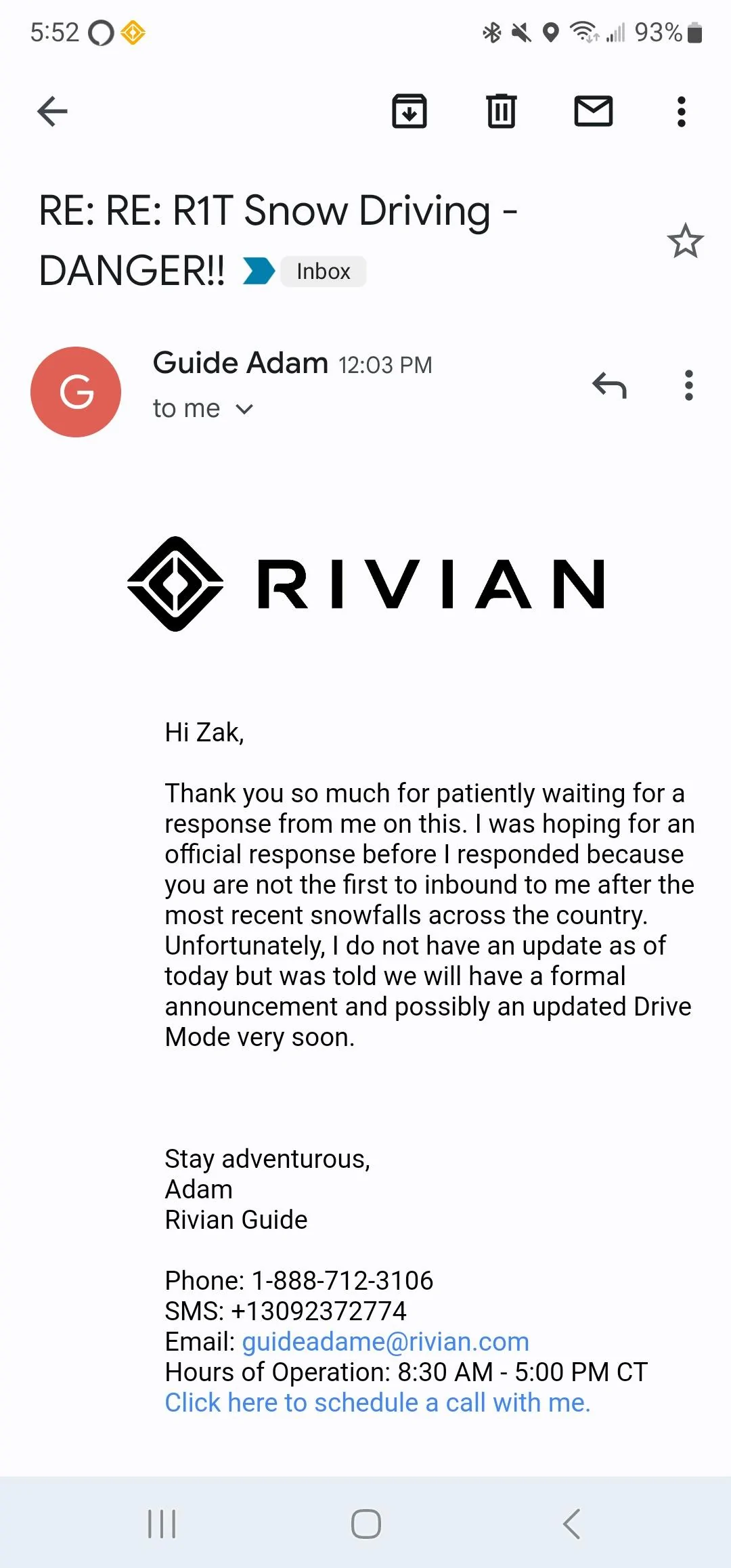

Hey all, I sent a note to my guide on how sketchy the regen mode seems to be on downhill descents, and got the attached reply. Sound like an issue for a number of folks, and seems that they are working on a fix???
I hope they get something very soon I am about to take delivery of my R1T and it's starting to make me nervous as I live in the snow like really snowy conditions. Last year I got 24 feet in December alone.... seriously praying for a snow mode by the time I take delivery!

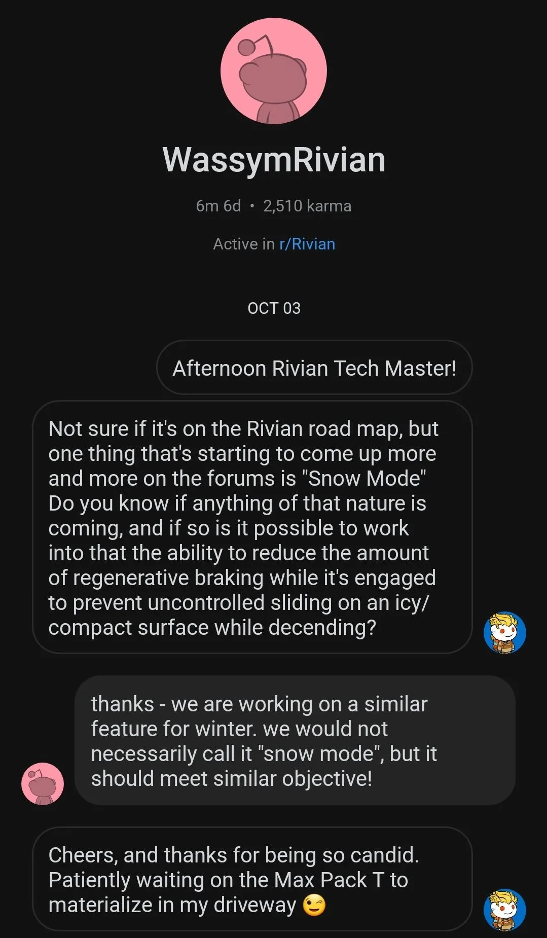

My brief chat with Rivians VP of software development in October
