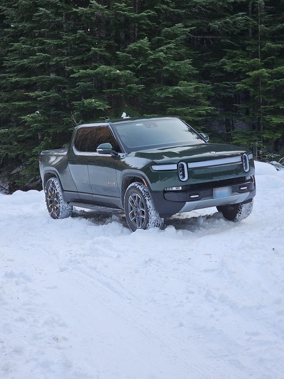

Took my Gen1 R1T quad up an icy and snowy PNW forest service road today. The road transitioned from icy ruts to wet and half-frozen snow 18" deep. I have the super Z8 cables and got to the point where continuing with AT tires alone was getting sketchy. (I have Cooper Discoverer AT3 tires in 275/65/R20.)
I stopped and chained up the rear tires and I'm happy to report that I had no issues with rubbing or damage to the wheels, wheel wells, brakes or suspension components. Speeds stayed underneath 15 mph. The chains did an excellent job of providing extra traction and inspired confidence for the rest of the drive. I know Rivian recommends against it, but I will be keeping this setup for future winter adventures.
