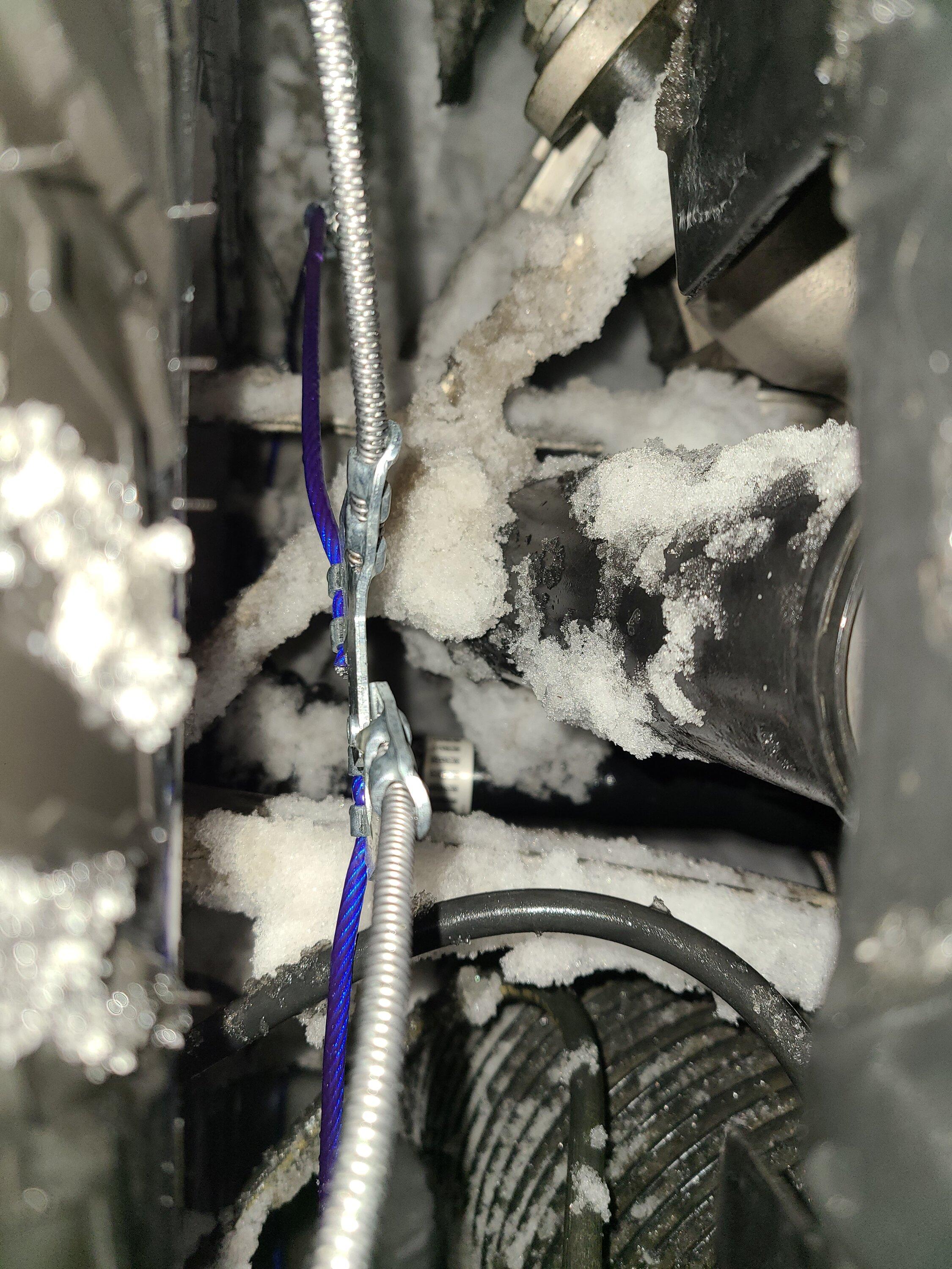

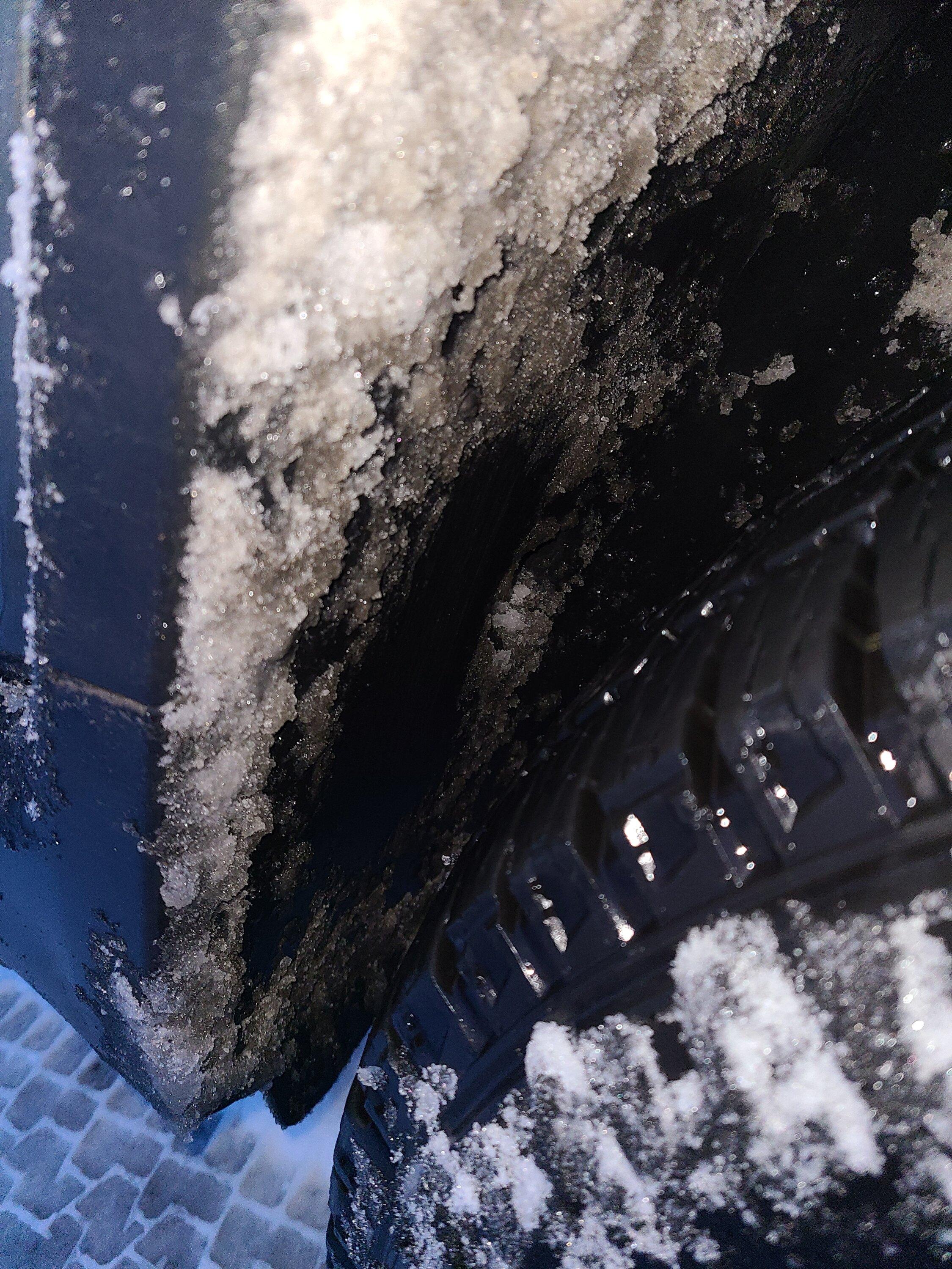

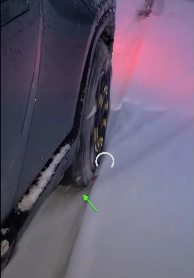

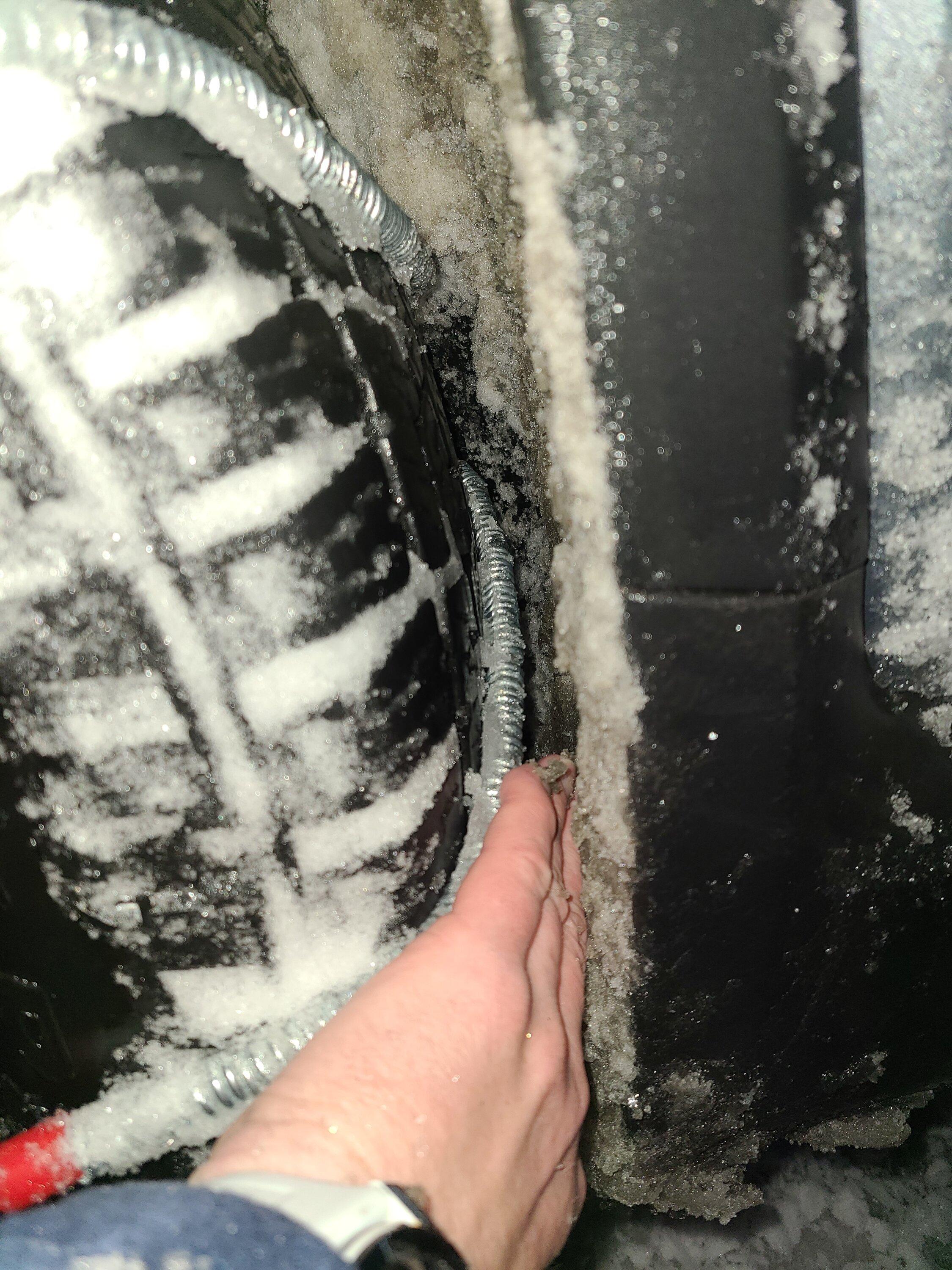

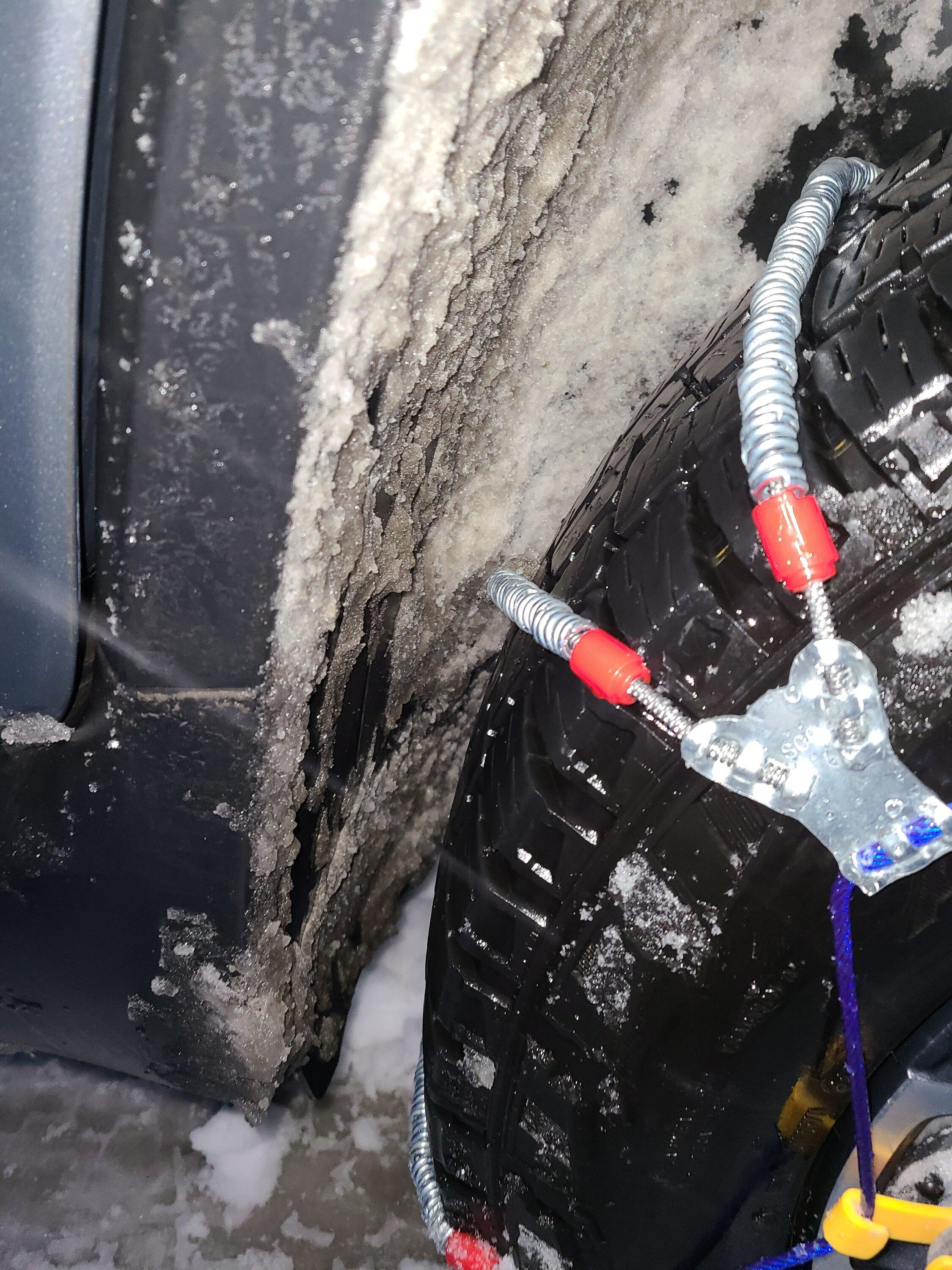

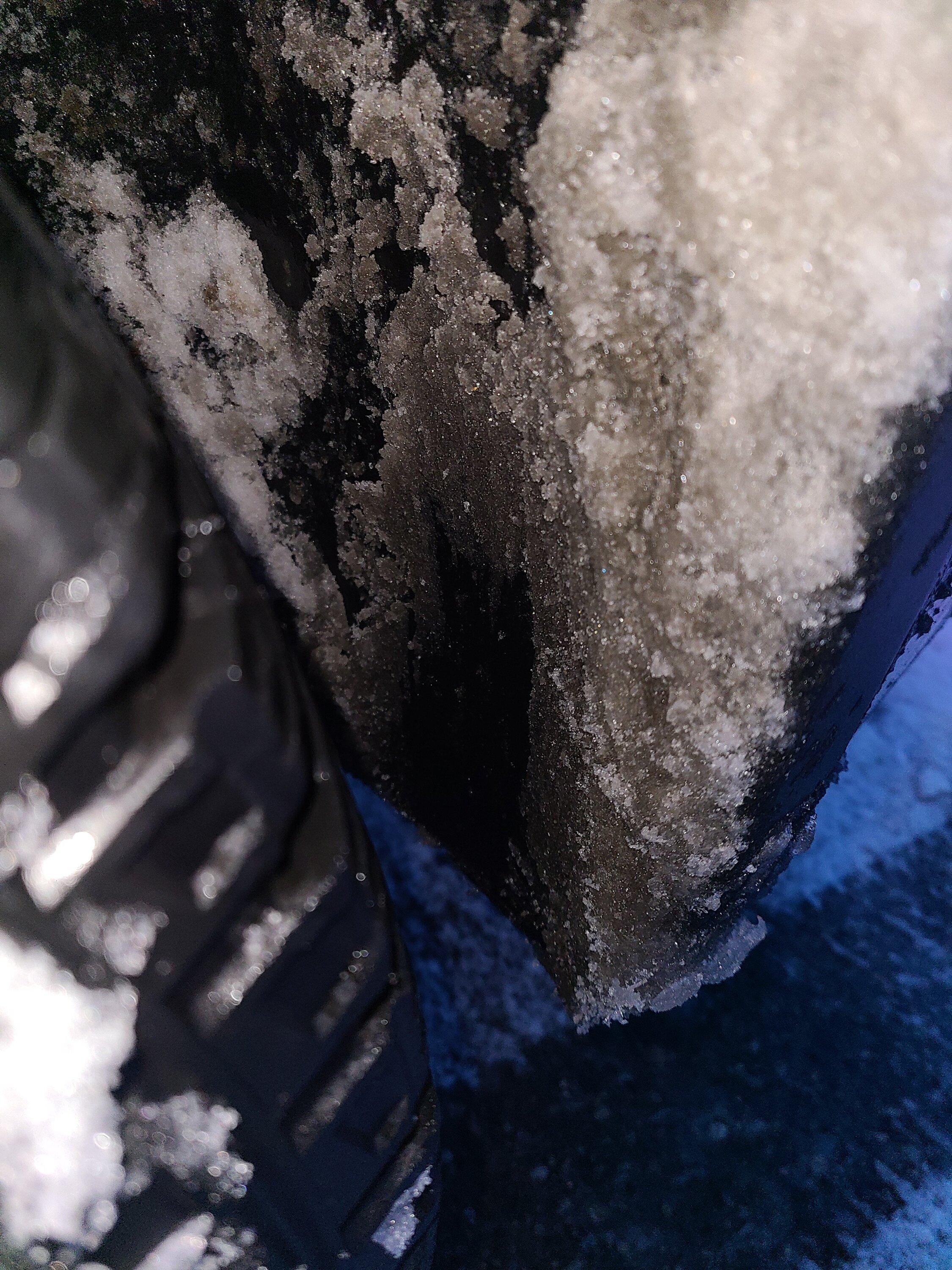

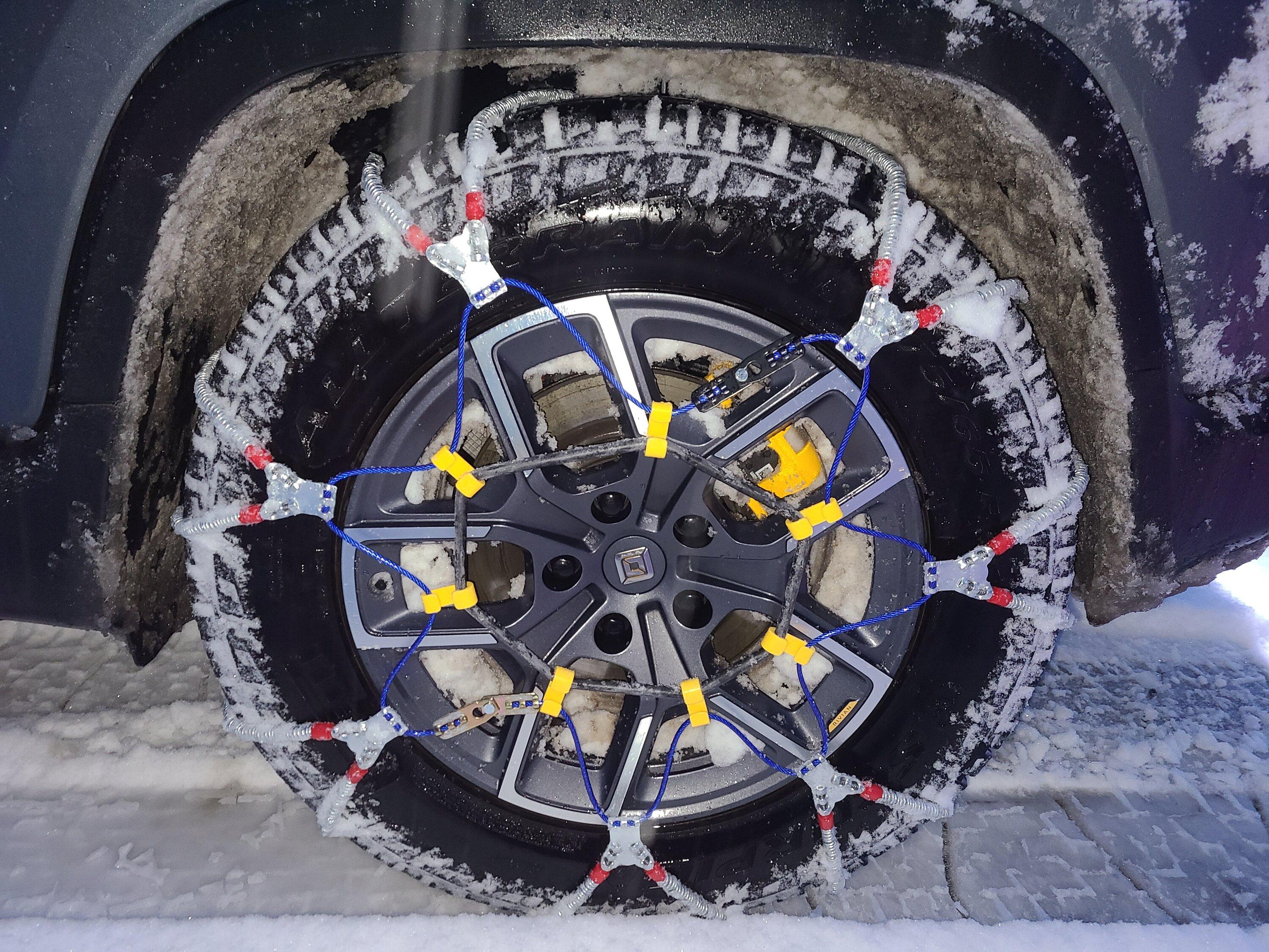

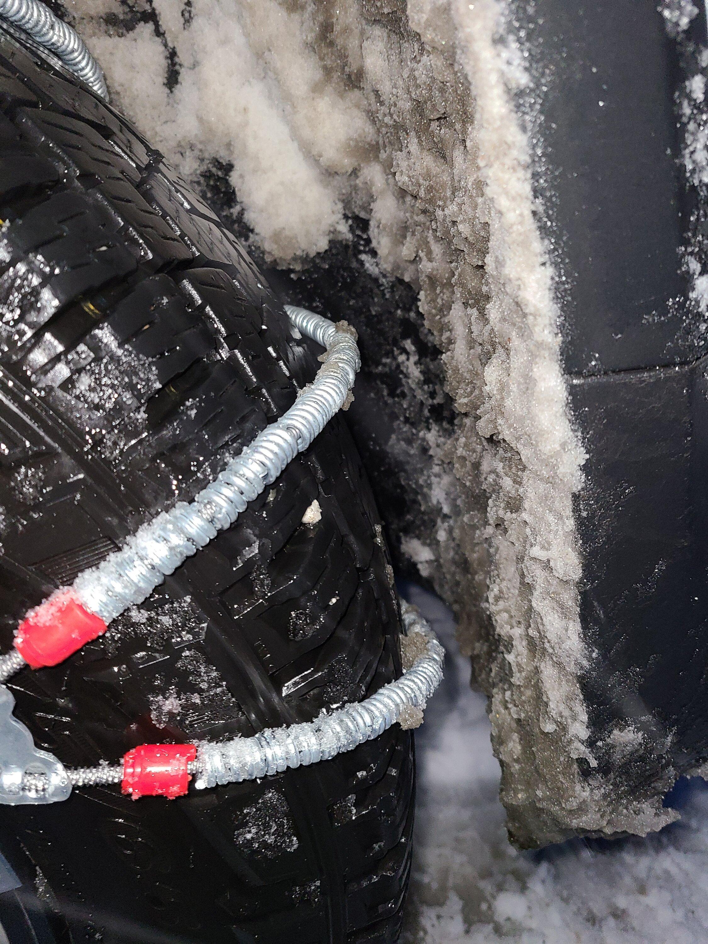

The chains will work to get you out of trouble provided you stay under 15mph, any faster and they seem to come in contact with the front and rear of the rear wheel well. I'll likely keep them as a just in case, and purchase snow socks as a high speed alternative.
Long version
So to follow up my earlier post (page 2), the chains unfortunately start to rub at "speed". They're fine below 10-15 kph, but beyond that, they pull away from the tire due to the rotational force and start to come in contact with the front portion and rear portion of the wheel well.
In the video I've included, you can see as the wheel comes up to speed, the slack that starts to build in the cables. Of note, I was driving in High suspension height. I did try low and normal and it was a similar result.
The last two photos are where I'm fairly certain, they were coming into contact with the wheel well.

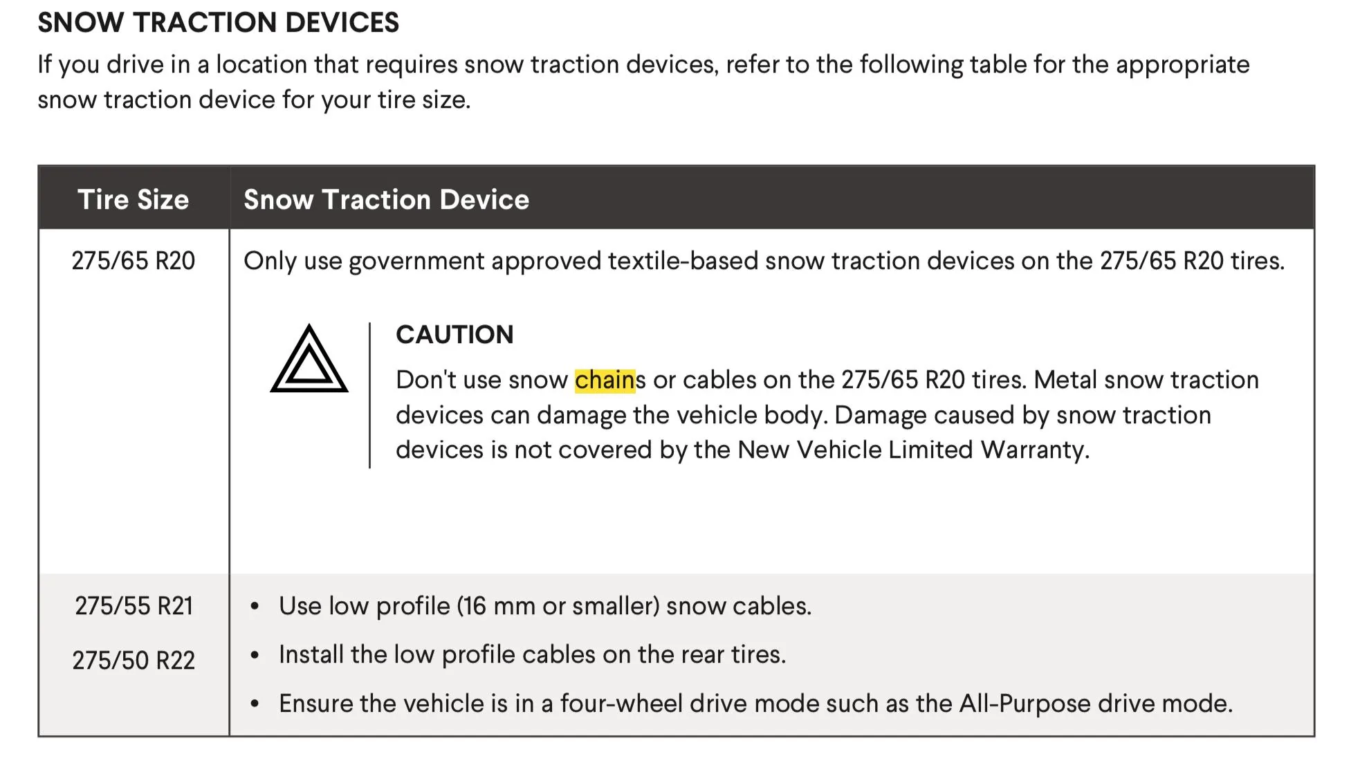

Hey All, I'm hoping to get a little advice for our situation. Florida man here who moved to the North Georgia mountains and this is our first winter here. R1T quad with brand new Michelin Defender LTX M/S 2's on 21s. Our issue is the 1/4 mile long private road is a mix of asphalt and concrete and a grade of 12 - 20%. We got a whole 3" of snow and we've been "snowed in" for a week since the trees and mountains don't let the sunshine on much of the driveway. I'm an Flor-idiot and didn't shovel right after the snow so it's been melting and refreezing every night and there are patches of ice now (I think? it's like a hard snow). Temps have been in the 20-40s... We did leave a car down at the highway so we can walk the 1/4 mile down and up and we do, but my only neighbor just bought a 4x4 UTV and it's able to drive up and down with just the stock knobby tires so it got me thinking there must be a tire/chain/cable setup I can use on the Royvian. Once we get down to the highway, the town has been brined/salted the roads so no issues done we get out there. Think I can get away with a good set of chains (or only rear cables per the owners manual)? What would the ideal tire/accessory combination be so we can get in and out?

Spikes-Spiders will fit on rear tires, @bagsofcole, though Rivian doesn't authorize them. [EDIT: This applies to 33" diameter tires such as 275/50R22 or 275/55R21. It does NOT necessarily apply to 34" diameter tires such as 275/65R20.]
On the front tires, apparently anything bigger than snow socks can interfere with steering.

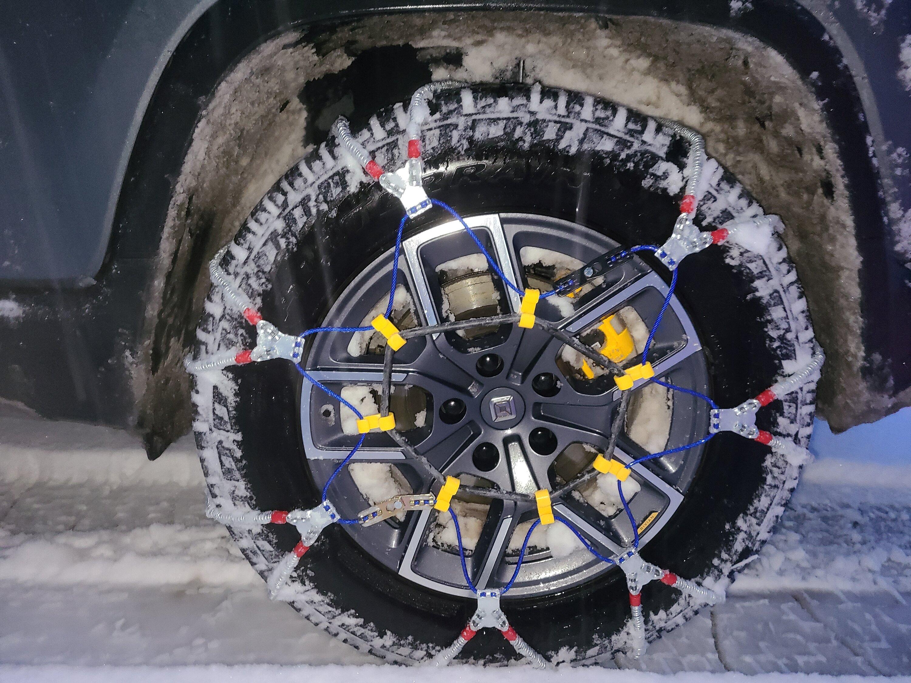

Responding to an older reply, but before this video I had no idea how much the chains flared out from the surface of the tire!
Rivian R1T R1S Snow / ice chains on a quad R1T? wheels
The tensioner looks a bit loose though, and the cables come out very far onto the face of the wheels...it makes me wonder if this particular set of chains might be a size or two too large.
