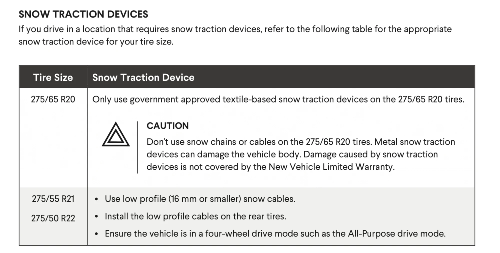

Note that Rivian has some words to say about chains.

Dumb question: Front? Rear? Both?
Owners manual says rear, only on the 22s but doesn’t specify for the other sizes.
I guess for the 20s with snow socks or the 21s it’s up to user discretion??
Was thinking about this as well since I order one pair.
From other's experiences on the 20s it sounds like the main issue is tail sliding in regen, so it may be worth putting them on the rear?
Could be the reason they recommend this for 21/22s?

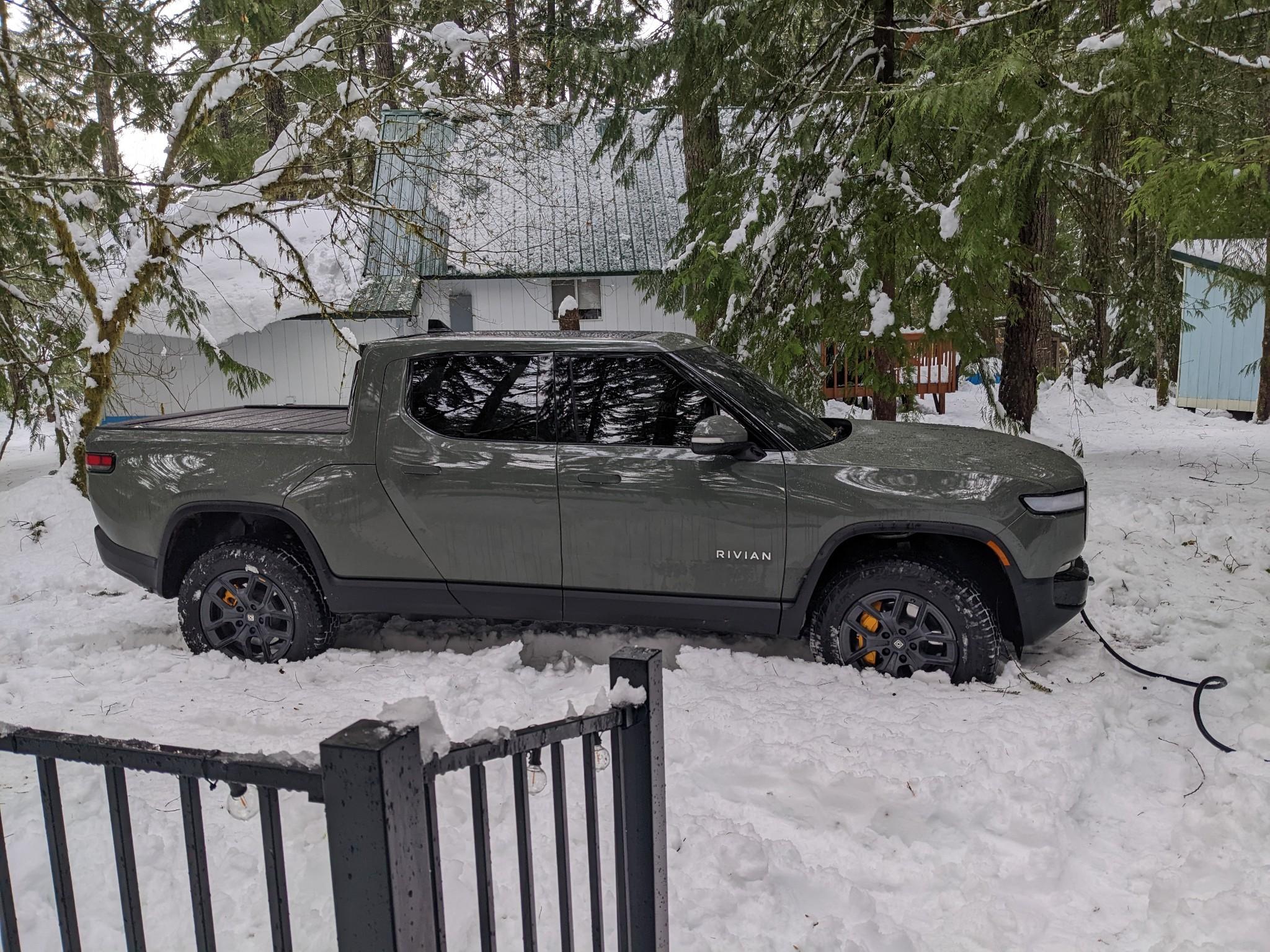

Just watched a bunch of videos, including DOT testing, and was surprised. Had never heard of them but may actually consider them if clearance is actually an issue. Have to use chains 2-3 times a winter to get unstuck at our cabin in the mountains.
Rivian R1T R1S Snow socks for the 20s. IMG_20221209_062700
We had 12-15" of some pretty wet stuff on the ground at our cabin last weekend. After digging out the 4' berm created by the plow, we went into Off-road/Highest and barreled our way in no problem. Backing out, at an angle, the next day was surprisingly a breeze. 7500lbs packs the snow in pretty well.
