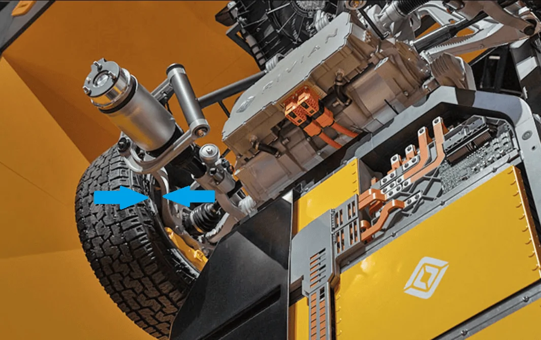

Front v. Rear for chains - one more thing to consider: Clearance is very tight inside the front wheel, especially with 20's, because of the suspension/steering components. I wouldn't take a chance with even the slimmest chains there. Plenty of room on the rear wheels though.
