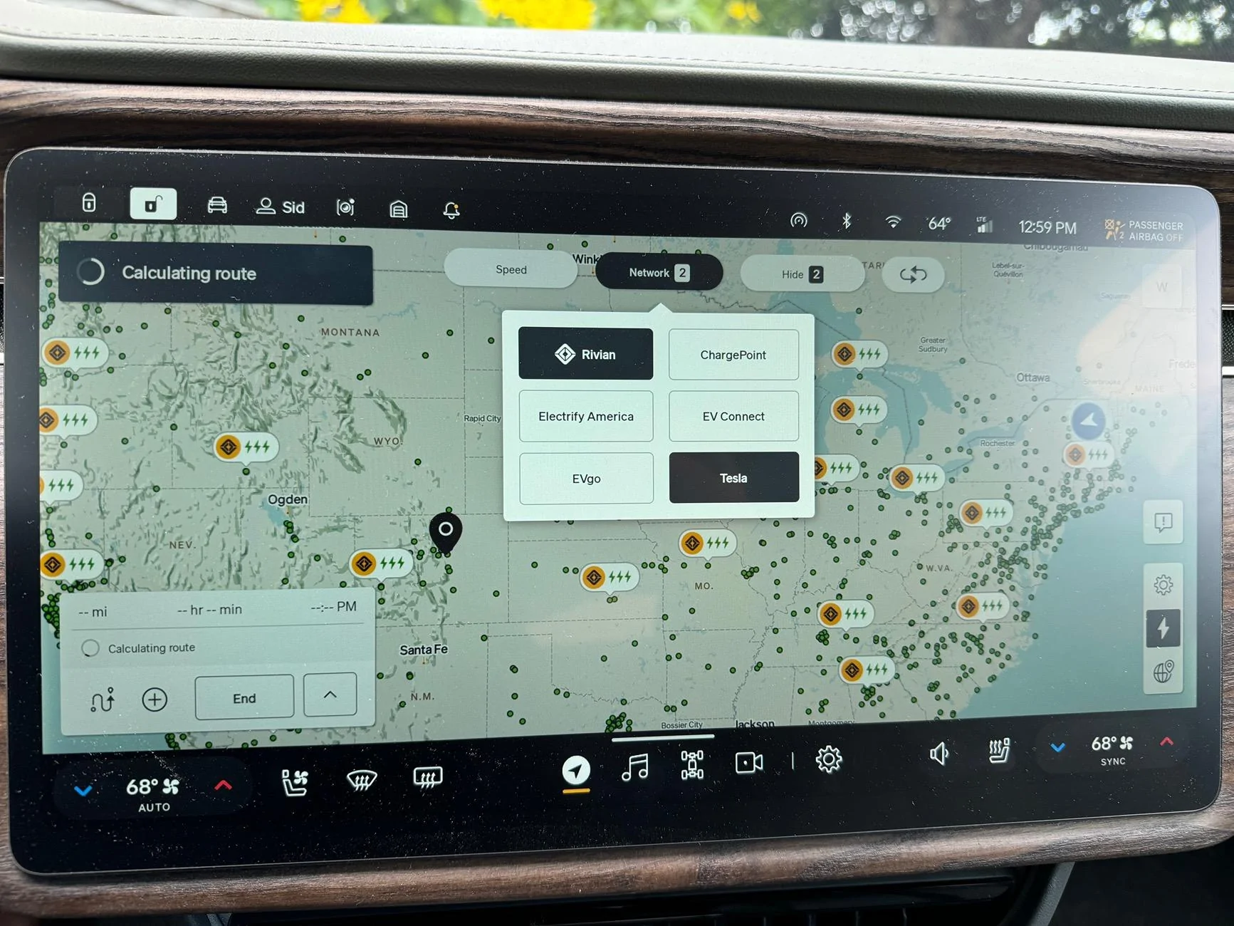

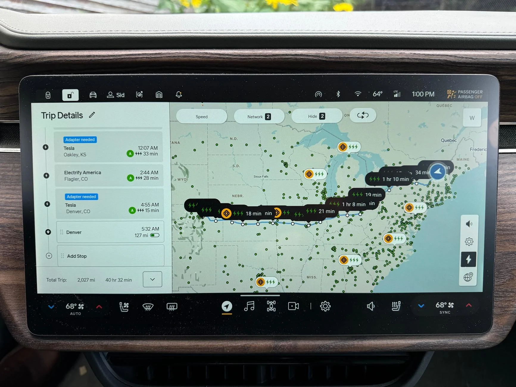

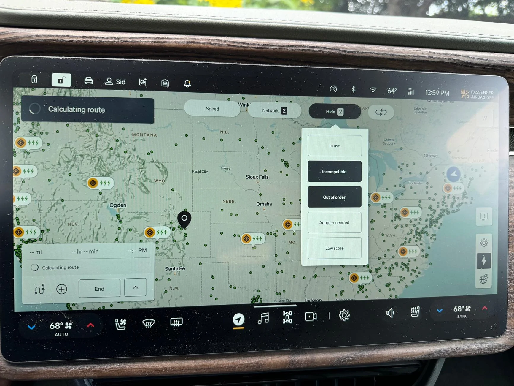

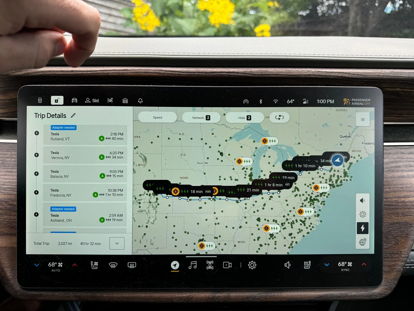

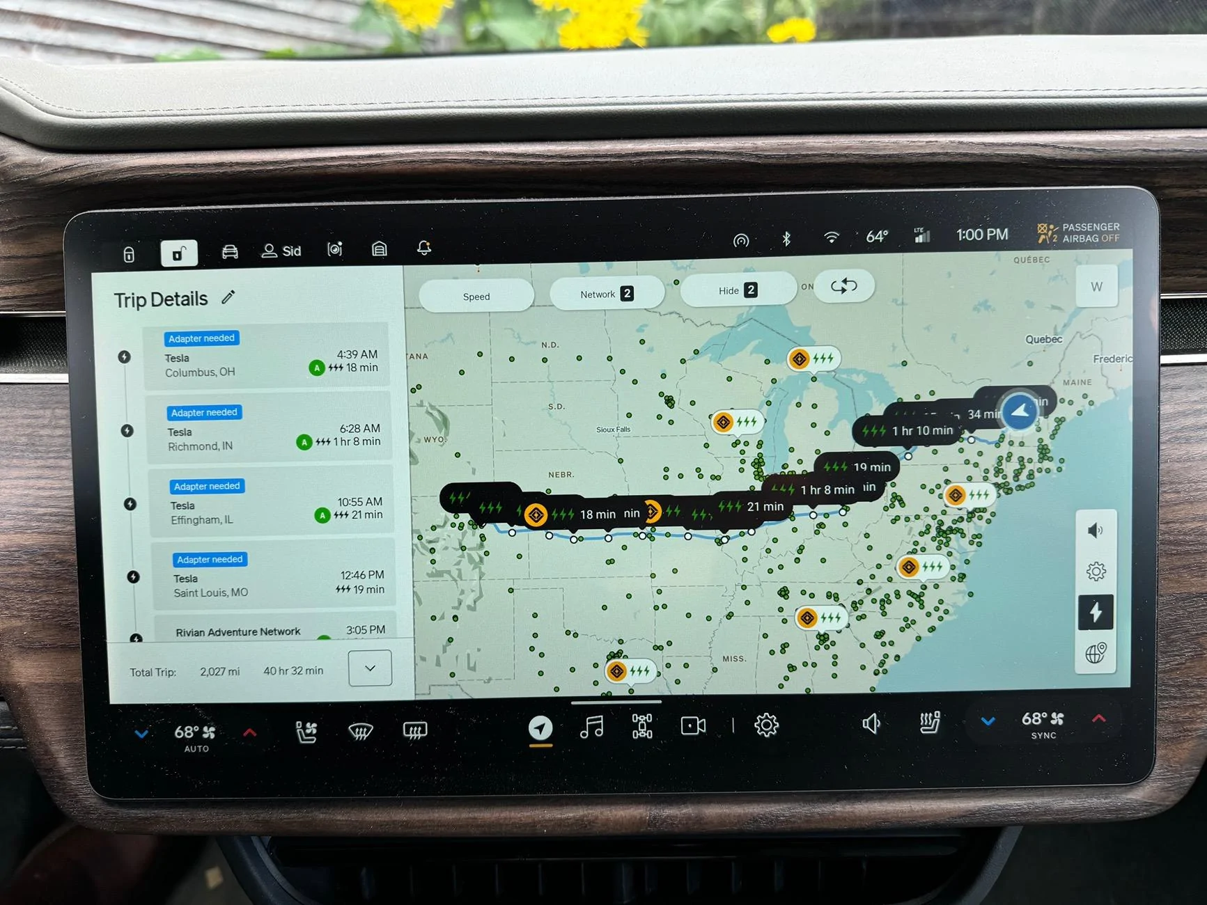

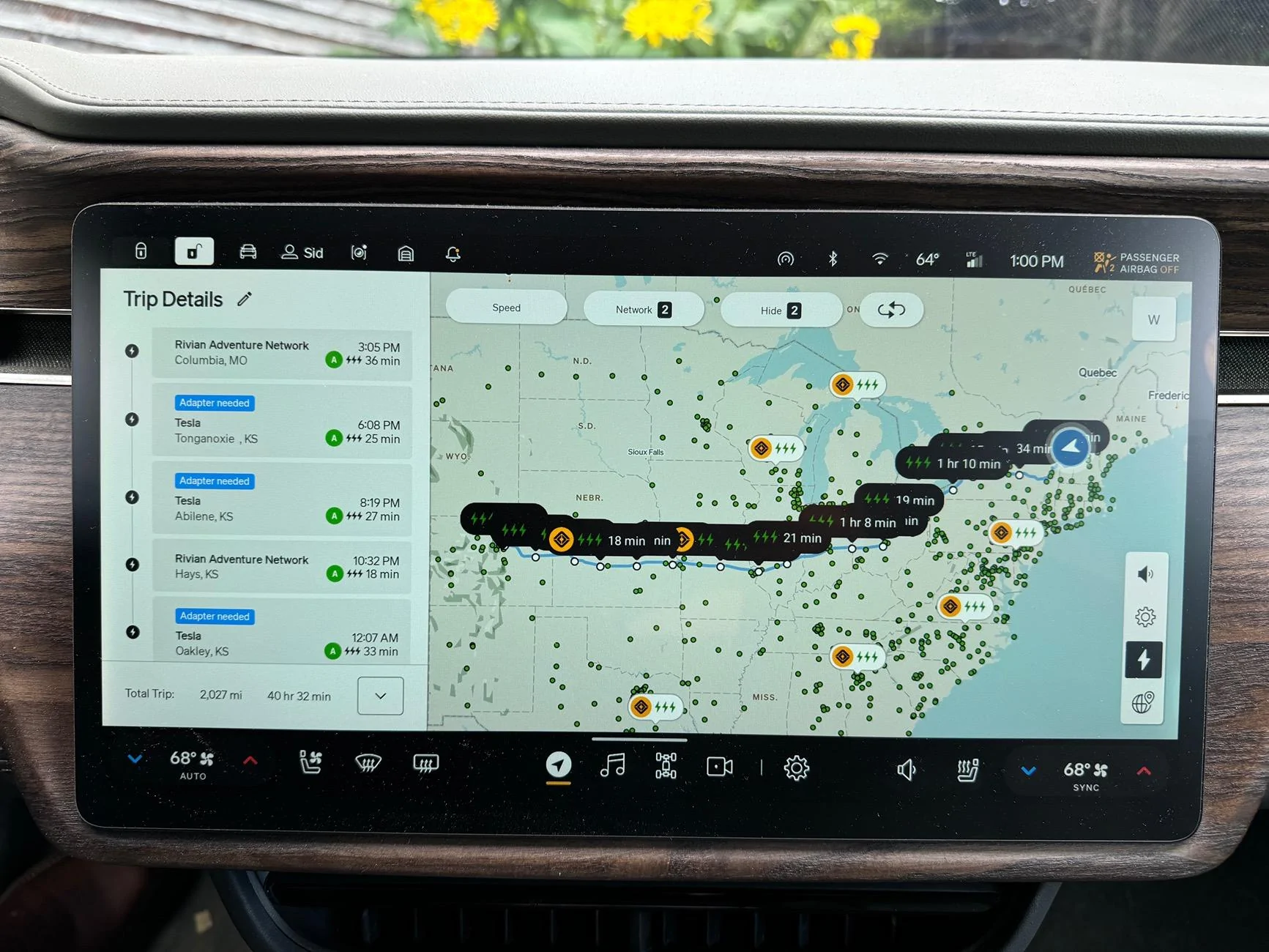

Have you tried a hard reset (Holding the left steering wheel button and emergency flashers at the same time)? I have set my filters to strictly use RAN/Tesla (with an A2Z adapter), and when I route to CO (from VT), it suggests mostly Tesla chargers along the way:
Rivian R1T R1S Solved (post #14): Superchargers not Included in Trip Navigation IMG_2323
Rivian R1T R1S Solved (post #14): Superchargers not Included in Trip Navigation IMG_2324
Rivian R1T R1S Solved (post #14): Superchargers not Included in Trip Navigation IMG_2328
Rivian R1T R1S Solved (post #14): Superchargers not Included in Trip Navigation IMG_2329
Rivian R1T R1S Solved (post #14): Superchargers not Included in Trip Navigation IMG_2330
Rivian R1T R1S Solved (post #14): Superchargers not Included in Trip Navigation IMG_2331
I’m not sure how/why that Flagler, CO EA is on my hypothetical route given my filters, but I’m guessing it’s required and there isn’t a RAN/Tesla in that stretch of road?

No, I have not yet tried a hard reset. I will do that before departing. This isn't too big of a deal. I can just manually select each Tesla stop.

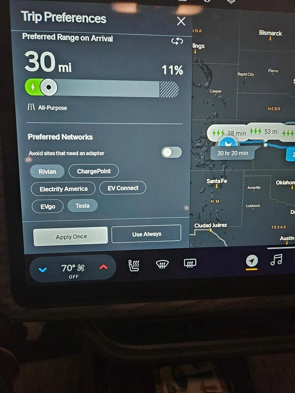

Hey, not sure if this helps, but look at this video:
At the 9:27 mark, he shows how to set preferences for NAVIGATION, NOT what shows on the map. The buttons at the top of the map just seem to change which chargers shown when viewing the map, NOT preferences for navigating.
In the preferences for navigation in the video --which is separate from the navigation tab in the main settings menu--if you click preferred networks, there you can change which networks the system uses for navigation. When you're done, select 'use always' if you want the settings to be permanent. I personally use this to choose Tesla only due to availability in my region. (Changing on the map did nothing when getting directions to a far away destination requiring a charge in between.)
Hope that helps...

Worth a shot... Also, compare the filters you have set to the first two photos I posted. The "Hide" "Adapter Needed" one tripped me up the first few times I went on a trip with an adapter (for some reason, even though it's straightforward enough for me now). Also, does anyone know what "Incompatible" stations are? I'm assuming these are Tesla stations that don't work with the adapter? If so, why even give the option to show incompatible stations? I also wish my truck would just remember my preferred stations and station "hide" settings, but at least they seem to function well enough for me...
Another tip for your trip: you can use your adapter at Magic Dock stations, and in my experience, you get full charge speed whereas I've seen some reports of using the Magic Dock itself limiting charge speeds to 150kw. Also, for a trip like this, it's well worth subscribing to the Tesla charging membership and triggering your charges from within the app. You have to reserve the specific charger before you plug the adapter into the truck, otherwise the Rivian plug-and-charge will be triggered which charges you a higher rate (to use the Tesla app: park, open app, select location and specific pedestal you are parked at, then plug in when prompted). This saved us a decent bit of money on my last road trip to West Virginia.

This might be it right here: I think when I got my adapter, I set my trip calculation settings to only use Tesla and RAN when planning routes (with "Avoid sites that an adapter" deselected), and I'm sure I would have selected "Use Always" when I did that since I avoid EA, EVGo, Chargepoint, etc. if at all possible given past bad experiences with all of the above (and nearly flawless Tesla/RAN charging).

That was the answer, @TampaR1T ! Thank you. I had to go to the navigation menu screen to deselect "Avoid sites that need an adapter" even though on the map screen, I had deselected "Hide adapter needed"
I really appreciate the tip!
